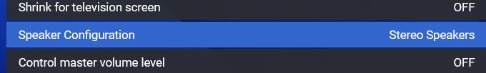

Did you look at the HDHomeRun Audio settings and pick the one that closely matches your Soundsystem ?
on my main system I use digital pass through ... on my laptop stereo.
