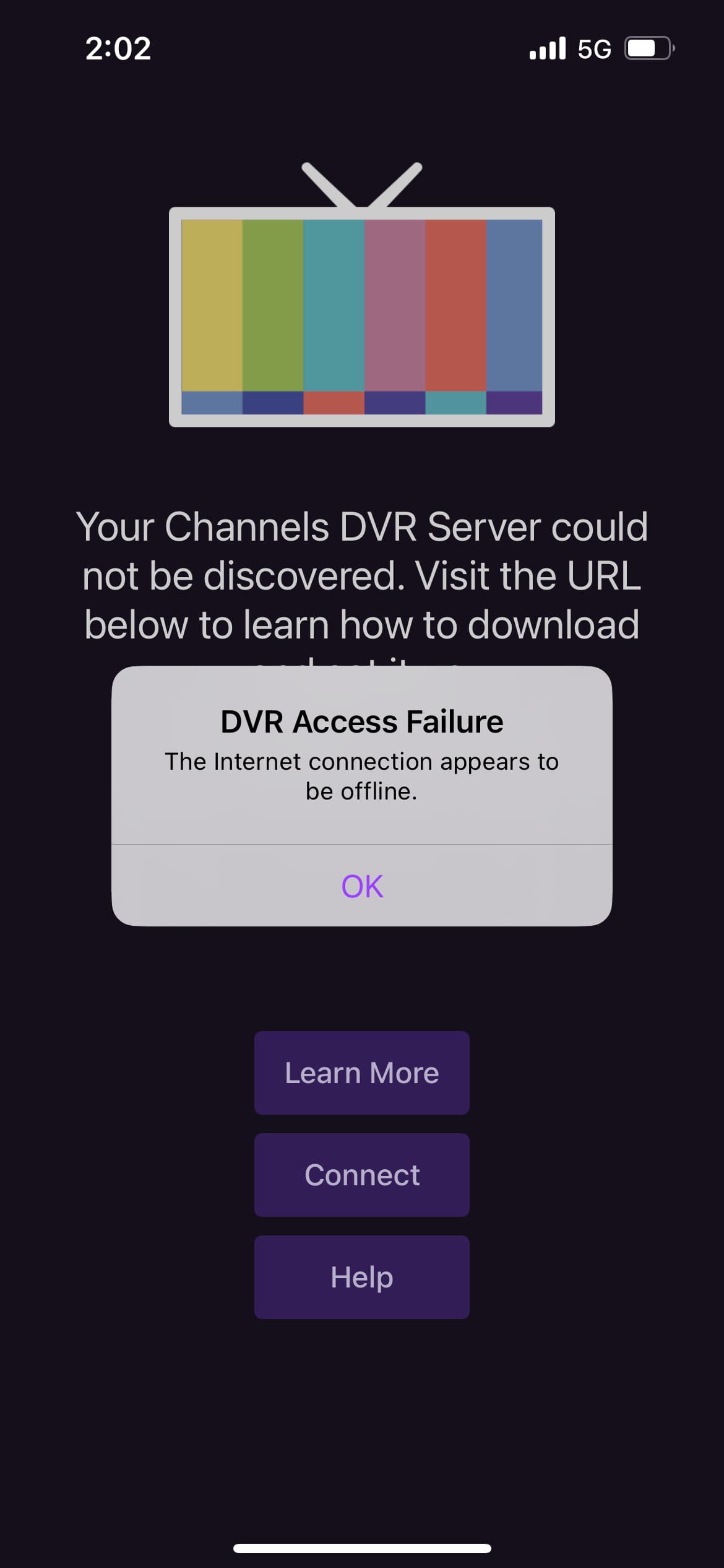

I'm having trouble setting up remote access on my new Mac. It worked fine on my PC, so I went back into my AT&T fiber router page kept all the same settings in the Firewall > NAT/Gaming tab (TCP:8089) but changed the "Needed by Device" line from my PC IP address to my Mac.

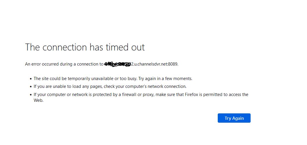

However, when I try to connect away from home, after clicking Authorize Access, I get this error message:
So I followed your instructions to check if port forwarding is working at check-host.net, and it shows that I'm "Connected" from everywhere. Then I ran Troubleshooting under the Support tab on the Server page, all boxes have green checkmarks, and Remote Access says "Successfully established external connection." But when I navigate to https://my.channelsdvr.net/ the menu bar along the top loads, but none of the tabs work, and the page just shows a spinning wheel.
Any ideas?
