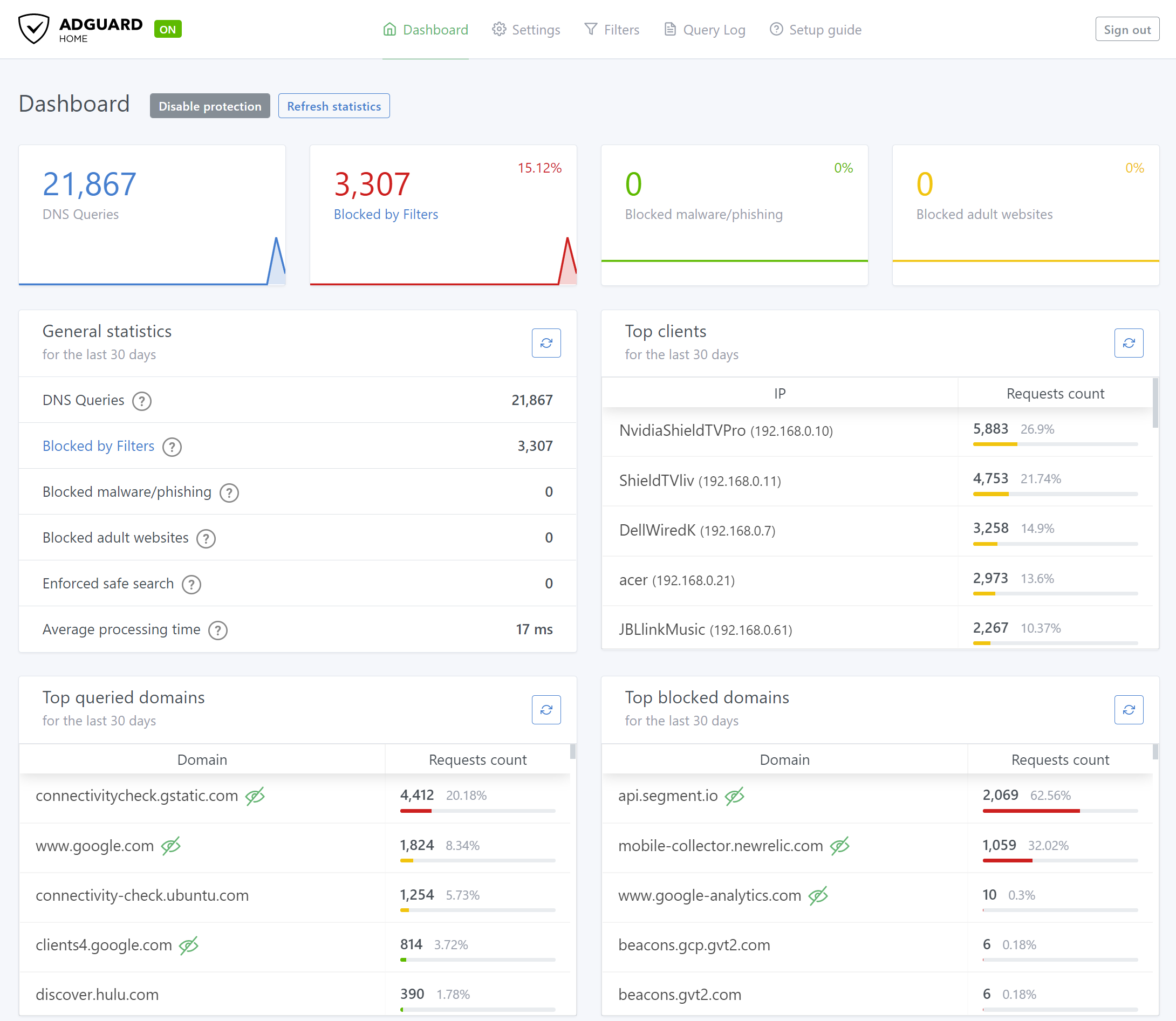

I just setup an old netbook to run Ad Guard Home DNS server, something very much like Pi-Hole, but a bit more on the simple easy to use side.
(I had also used the Ad Guard free DNS set via my router for a short time.)
So far, not seeing any issues with Channels and TVE.
It is curious to see all the requests and things being blocked that are coming from my 2 Nvidia Shields.

yea. i have not even been using much in the last 18hrs, but alas, my Shield Pro is the top offender for traffic. Followed by the Tube Shield in my living room, that has not even been used once since i setup AdGaurd Home on my network, so that is just pure idle background traffic it is capturing.
