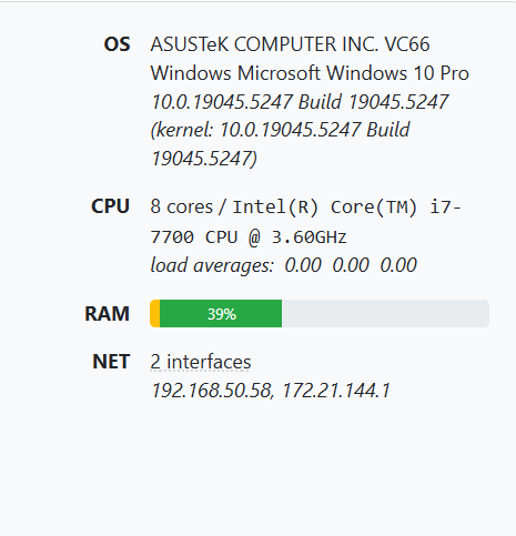

I run my main DVR on a windows machine ... only use my UBUNTU server to run Docker and feed all other machines ... I run a test DVR on ubuntu ... I still prefer Windows for my DVR server.... as I also run other Video/DVR Servers.
Main DVR
UBUNTU Server
Dockers running on ubuntu ...
