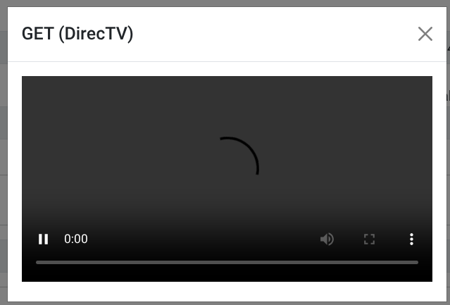

I just configured about 42 DTV channels for ADBTuner. I tested every one of them using the (default, recommended) mode, as you previously suggested.
Here's the odd thing about it. Every single channel previewed fine but one. For some reason, GET TV would not play in the preview window. The LinkPi interface showed the correct channel playing from the tuner. But, it would not play on the ADBT GUI.
Screenshot 2025-08-25 3.56.32 PM
Enabling Compatibility mode got it working. I switched modes a couple times, and default mode will not play this one channel properly, while compatibility mode always does.
What in the world would make just one single channel out of over three dozen require a different mode?! Same app, same interface, same link format... I don't get it... :exploding_head:
First, congrats on getting setup! As to GET TV, may be a bad link. I had one of those yesterday which made the app act all wonky, would open but freeze. I will see if I have that channel active and test when I get home later.
