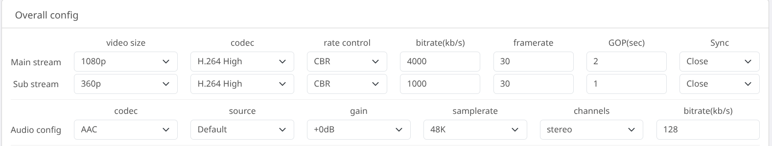

I just came across this previous comment of yours. What is the benefit of choosing -1 for frame rate?
For that matter, what do you consider to be the optimum settings for encoding configuration on the ENC5-V2? Especially when primarily using the DirecTV app for ADBTuner. Currently, I have these settings:
I just found some helpful recommendations from @turtletank in the LinkPi feed:
I will confirm from memory what I can.
  1. Negative frame rate, from what I read, is the LinkPi way of asking to Auto Detect Frame Rate. Setting -1 works for me.
  2. I use VBR and H264 High, and 10240 for bitrate (bitrate override somewhat by VBR)
  3. Set normal encoding (no smart stuff) with min QP of 18 and a max of 28. These are likely overly high quality for the source, ending up with about a 20mbit stream. You could probably do min/max of 22/36 and be just fine.
  4. Audio is AAC Stereo Auto Sample Rate (which ends up as 48K) and bitrate of 384 kbps. During my testing I also set a +6dB gain for Onn Plus as they were lower volume than my other boxes. You may not need this.
Thank you. My recordings have been fairly decent up to this point, using mostly LinkPi defaults. I have applied your recommendations to the setup. My eyes and ears are not too discriminating. So, we shall see if I can detect any differences. Maybe smoother playback, less jitter when things are moving quickly, or pixelation between scenes?
My settings are aggressive and I know I’m encoding quality at a level way above source. My benchmark was clarify of text and motion in Android Menus. But these are enthusiast settings. It looks nice but creates a ton of extra bitrate that’s not technically needed.
