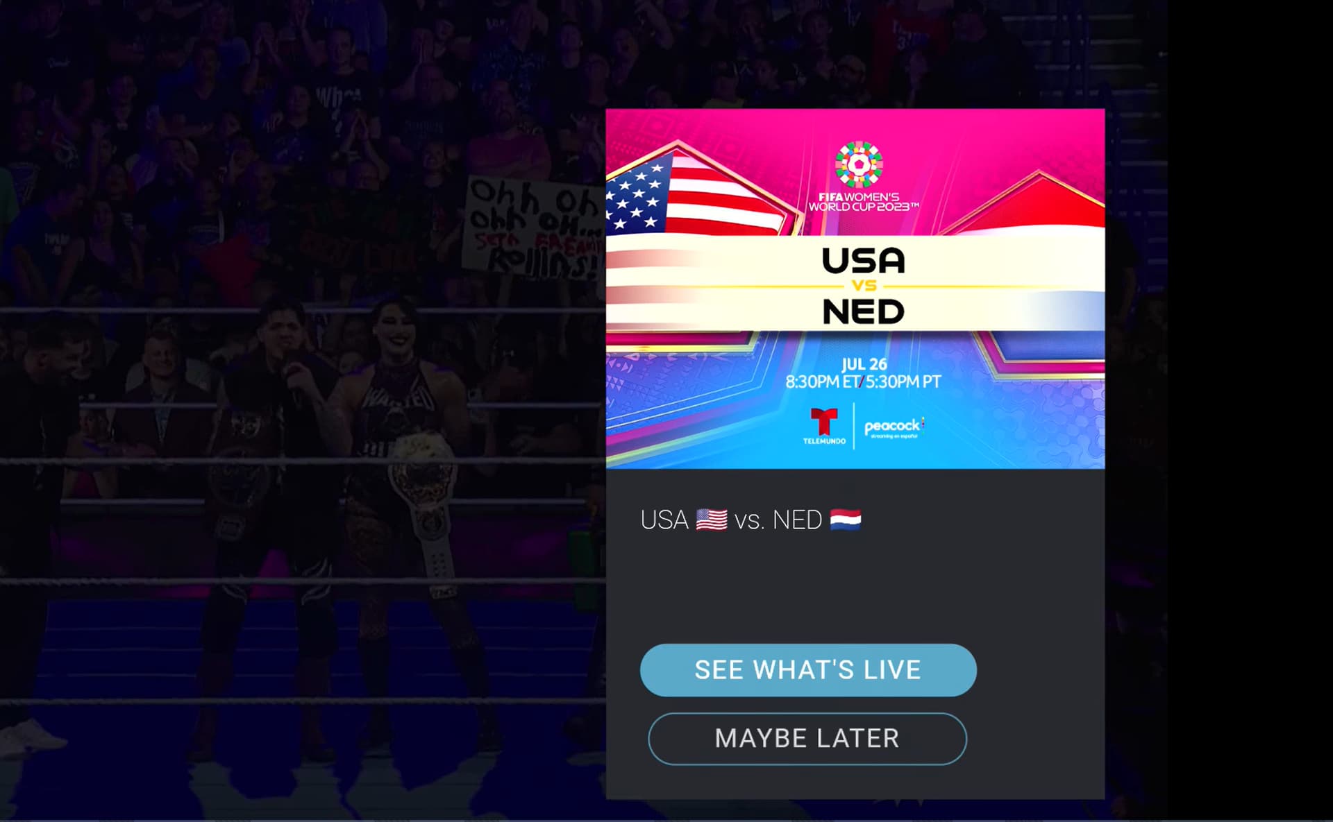

Just an FYI, if you are recording NBC family of networks via the NBC app, you may get a pop up over your recordings, asking you to watch the Women's World Cup. Check your recordings and rerecord if needed. Not sure how we can kill that without monitoring the feed. I noticed it because I started watching RAW after it went live and just used the Chromecast remote to select Maybe later.
