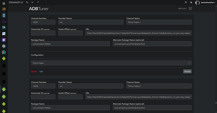

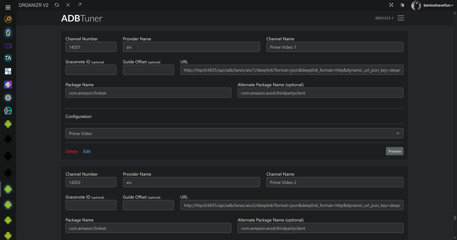

New bnhf/olivetin:latest (aka bnhf/olivetin:2025.12.19) pushed this morning with support creating (and removing) multiple sets of custom channels (lanes) in ADBTuner. Each app, supported in FruitDeepLinks, will have its own set of channels with proper package and deeplink support.
These sets of channels can be added and removed individually depending on the streaming services and premium subscriptions you have at any given point in time. This makes the many channels that may be required much easier to manage, update or remove.
More details here:

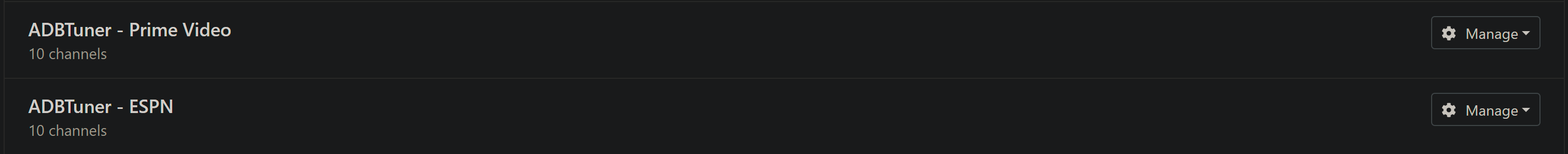

Example of 2 out 20 new channels added in ADBTuner along with CDVR Sources for both in a minute or two -- ready for viewing:
As always with ADBTuner, the target app needs to be installed on your streaming sticks, and you need to be logged-in on each.

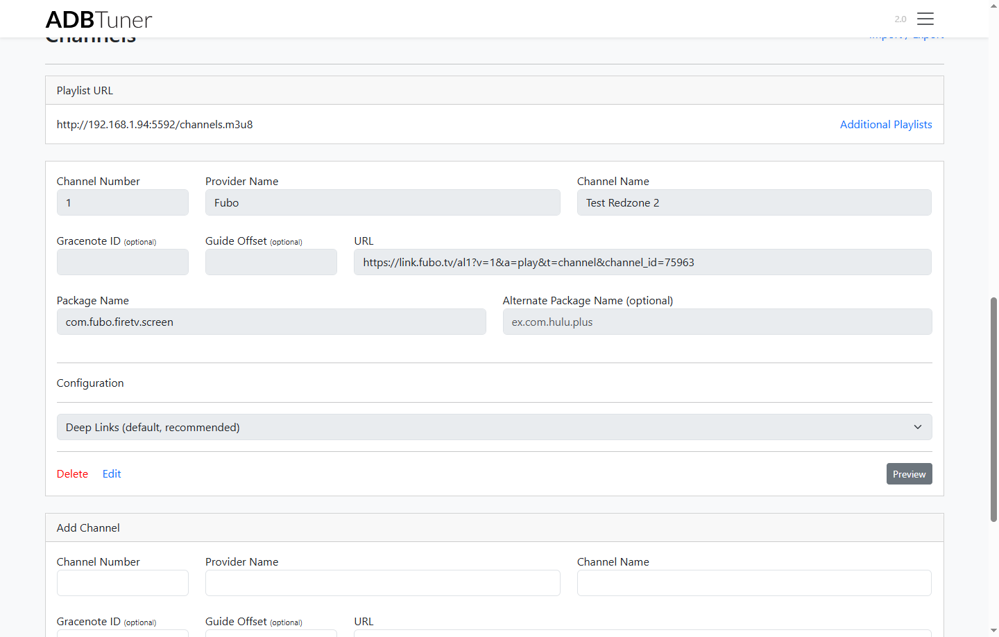

When I attempting to do deeplinking in Fubo with the following for Redzone
The channel opens and then goes back to the home screen. I tried with all compatiblity modes
https://link.fubo.tv/al1?v=1&a=play&t=channel&channel_id=75963
The other thing is when I try to play it on channels, the tuner shows as unable to tune and fails to open in the stream in channels but from the stream url I am using via vlc I see it open and tune for 1-2 seconds then back to the the home screen
Using the following as my streaming endpoint in ADBTuner
http://192.168.1.123/hls/stream0.m3u8

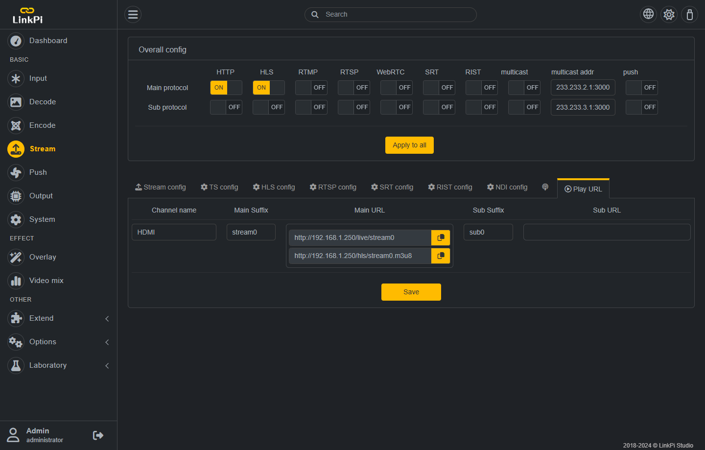

What jumps out first is the streaming endpoint value. This should be the URL from the LinkPi. It would follow something link (where xxx is the IP of your LinkPi):
http://xxx.xxx.xxx.xxx:8090/stream1
To confirm this, go to your LinkPi web interface, select the Stream icon on the left menu, then find the Play URL tab at the top of the middle section. You will find stream name. Note, it may or may not be named the default "stream0".
Of note, the LinkPi will present without the port number as I listed in example URL above. You may see:
http://xxx.xxx.xxx.xxx/live/stream1
This is a redirect to port 8090, which does not translate well. So whatever you find for you Play URL, make sure to format it for the "/live/" and replace with ":8090/" when you put into ADBTuner. Use the first URL example I presented as reference.

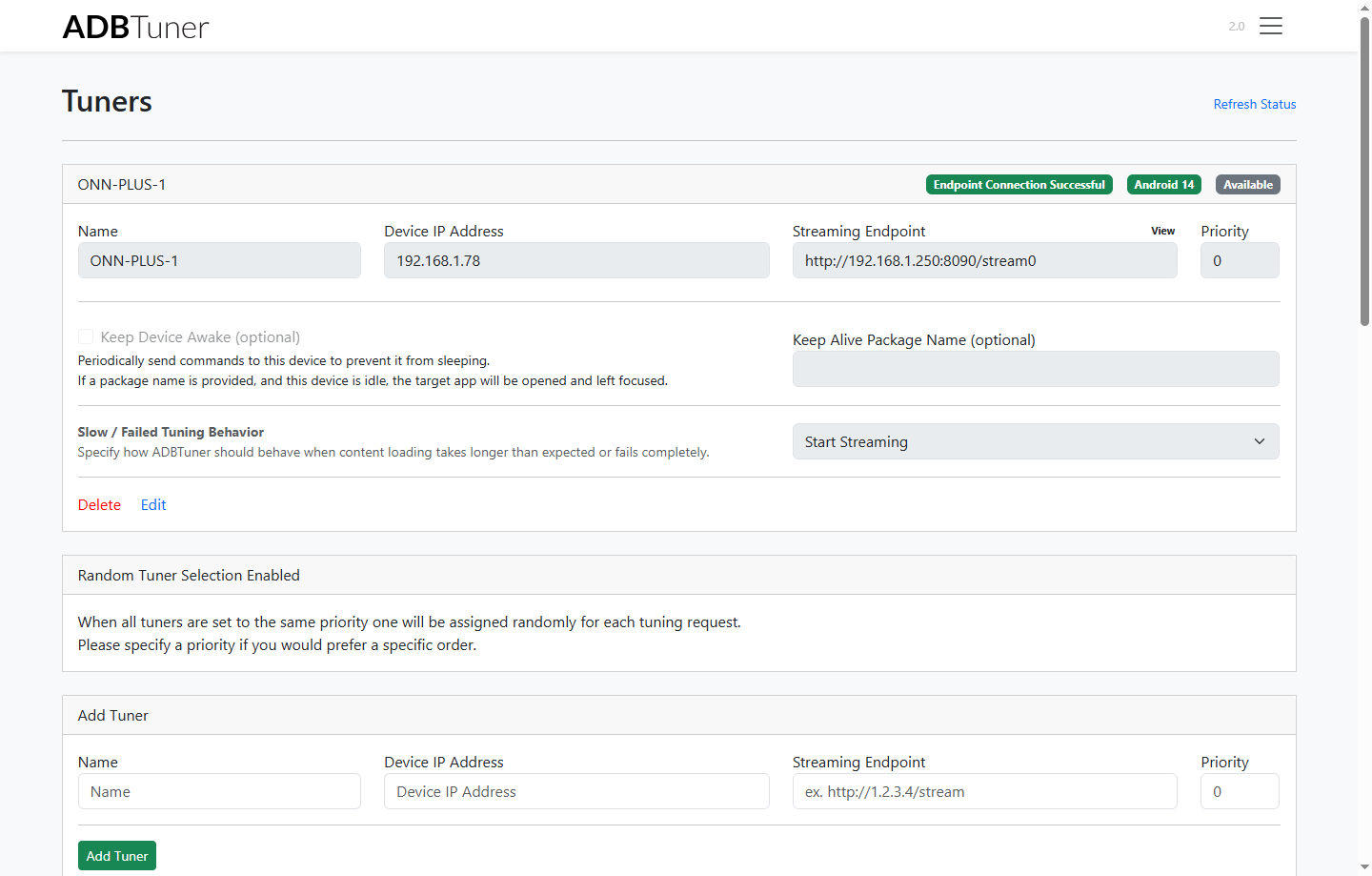

Attached all the screenshots I believe are needed.
Not sure if its a Fubo issue now or now
Also wondering what the best settings for the LinkPi are. Trying to get the best quality out of it
It's best to get working in ADBTuner first. If you can get a channel preview to display there, then the Channels DVR Part is straight forward. Based on your pictures.
  1. Streaming Endpoint looks good.
  2. Edpoint shows ADB Connection (Endpoint Connection Successful).
  3. Fubo App Looks good in channel setup.
  4. The Deep Link URL looks like the correct format.
  5. Configuration Deep Links (default, recommended) should work.*
