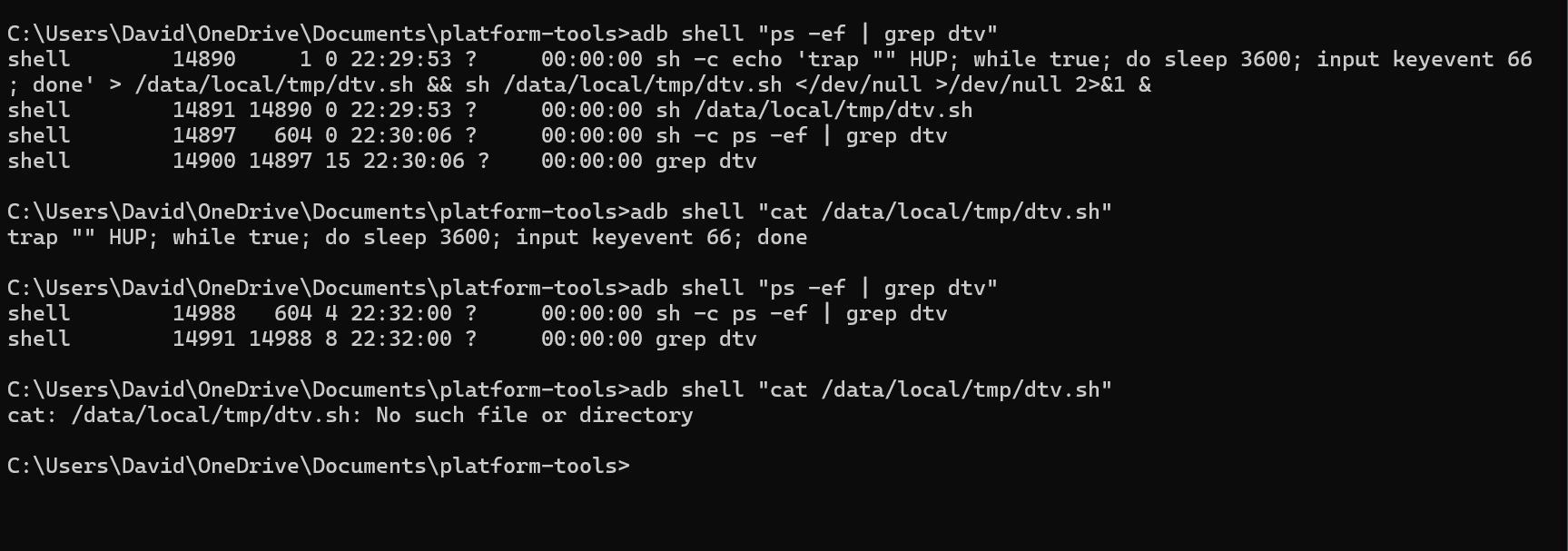

If it's easier I threw everything I've contributed on my website just to keep it all organized:
    "name": "DirecTV",
    "author": "David B.",
    "version": "1.0.0",
    "description": "Fast tuning for DirecTV.",
    "uuid": "3c7d5a19-6f2e-4b8a-9d3f-8e1c4b7a5f92",
    "global_options": {
        "use_fixed_delay": false,
        "fixed_delay_seconds": 0,
        "check_for_and_clear_whos_watching_prompts": false,
    "pre_tune_commands": [
        "pkill -9 -f dtv.sh || true"
    "tune_commands": [
        "am start -W -n '||TARGET_PACKAGE_NAME||'/$(cmd package resolve-activity -a android.intent.action.MAIN '||TARGET_PACKAGE_NAME||' | awk -F= '/name=/{print $2; exit}') -a android.intent.action.VIEW -d '||TARGET_URL_OR_IDENTIFIER||'"
        "echo 'trap \"\" HUP; while true; do sleep 3600; input keyevent 66; done' > /data/local/tmp/dtv.sh && sh /data/local/tmp/dtv.sh </dev/null >/dev/null 2>&1 &"
    "post_tune_commands": [
        "pkill -9 -f dtv.sh || true",
        "rm -f /data/local/tmp/dtv.sh",
        "input keyevent KEYCODE_HOME"

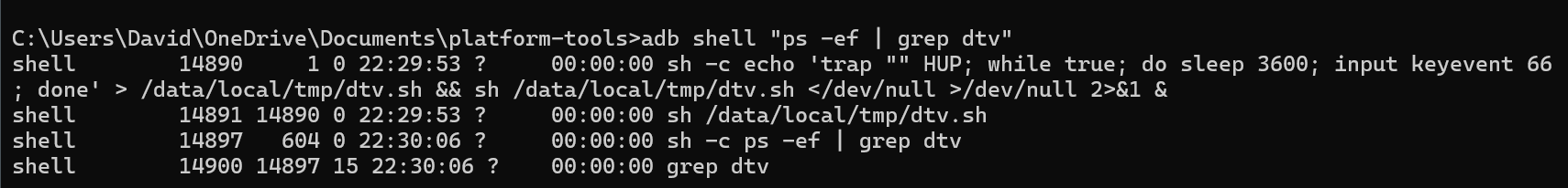

I tested this with input keyevent 86 to play/pause every 3 seconds. I was able to confirm that it worked and it did kill the process at completion and remove the file. Obviously, use at your own risk, but this should theoretically, since the other solution worked with the play/pause test, press the enter key, 66, every hour. Obviously your mileage may vary and until there's an official solution to run commands asynchronously or during viewing, this is really the only solution that I can think of. What I'm doing here is dynamically creating a shell script, saving it to a temporary location, executing it, and then in the post-tune commands, killing it and removing it from the temporary location. The idea is trap \"\" HUP should keep the script running until we execute the post tune commands which will kill and remove it. Since it's just pressing the enter key ever 3600 seconds it's pretty harmless but should hopefully help with the 4 hour popup. I hope!
I also tested thoroughly to ensure that it's running and that the script is killed.
After ending the stream.
I'm not certain it executes perfectly every time, but it does seem to clean up every time. So far I only had it create the file and not start once from what I could tell. That could have been a fluke.
