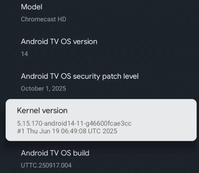

No, the issue with the CCwGTV sticks running Android 14, is that they use a different process for ADB authorization.
It's a two-part process that first requires pairing on a random port with a pairing code, before you can authorize an ADB connection. And the kicker is that it doesn't survive reboots, so the process must be repeated.
The setting you're talking about is required for Android 11+ devices; is done automatically by ADBTuner; and keeps ADB authorizations from expiring after x period of time.
Ohh okay. sounds like i'd be moving to the firecube device haha

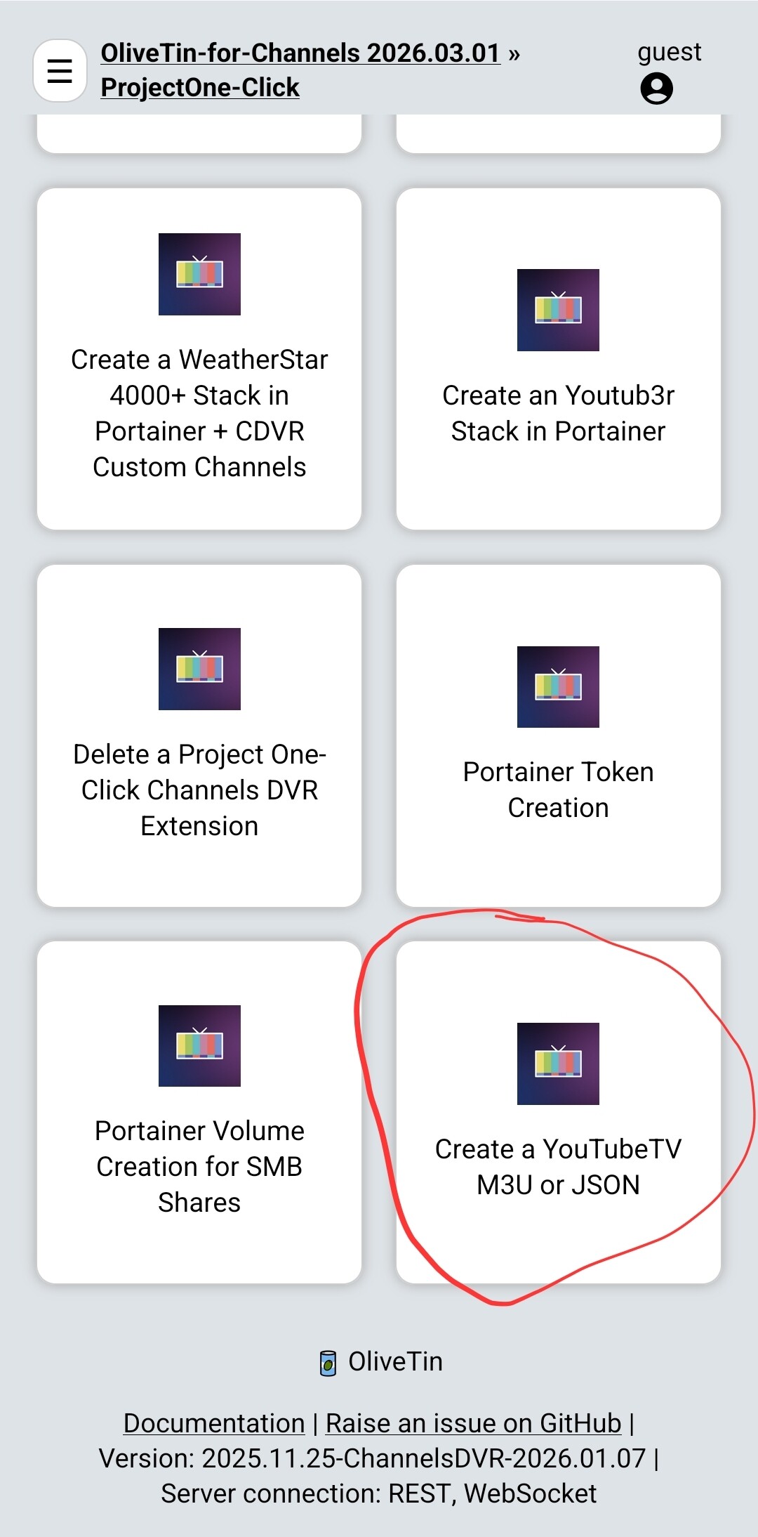

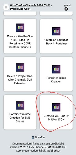

What’s the best way to generate a JSON for ADBTuner and my YouTube TV subscription without manually grabbing each URL from the browser? I’m likely moving over from FuboTV, where I used the FuboTV project container and only relied on ADBTuner for DRM channels.The nice feature was that the FuboTV project automatically matched the Gracenote IDs and I didn't have to do anything special to get guide data.
ATM, you have an option on Olivetin to have it generate the json for you with those urls. Paging @bnhf
There have been a couple JSON's posted...
Oh, and as a follow up to @Jean0987654321 's excellent suggestion, here's a link with some instructions:
FTR, I put the latest version of ADB on a laptop and was able to adb pair ip:port paringcode followed by adb tcpip 5555. It indicated it was going to restart the host at 5555 and I can no longer talk to it on the original ADB paired session. It also still does not work. I just thought I'd play with it a bit. Wait... spoke too soon. It's up and running again. For now.
I mean, it would be possible to watch the screen and see the boot up sequence, but without control of the remote, you wouldn't be able to navigate the menu to get the pairing port and code on the screen to scrape off and if you could do that much video screen scraping and remote manipulation, you wouldn't need adb. :slight_smile: I suppose Google Assistant would be another possible route for device manipulation, but probably without sufficient control for program selection.
Moving on to the fire cube (until Amazon f's that up).
