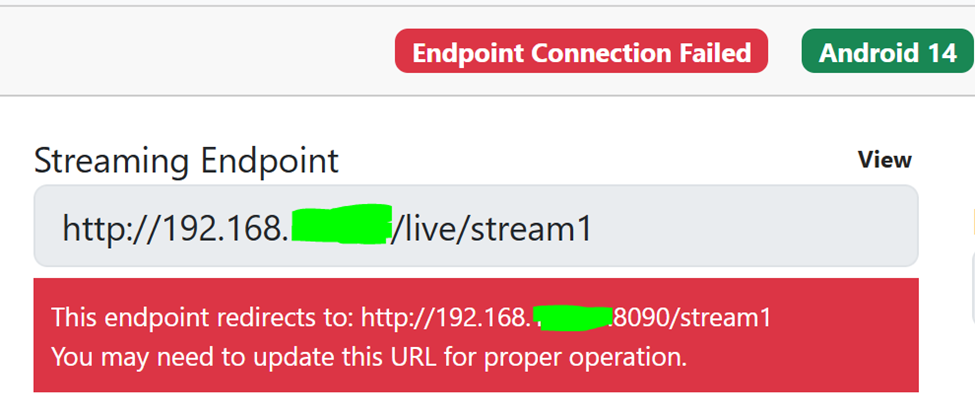

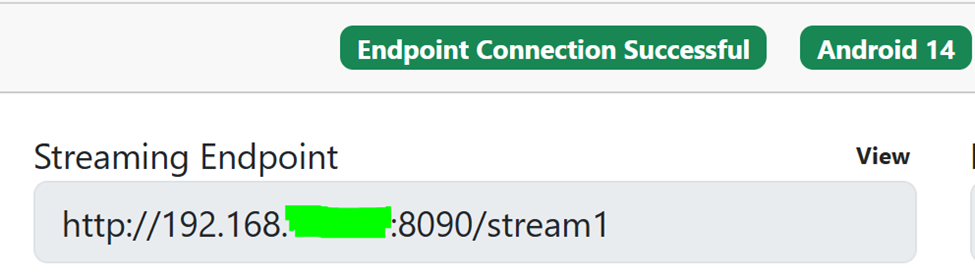

Updated to the Development version today, so far, so good. As many users have LinkPi, thought I would grab some Screen Shots of what the Steaming Endpoint error looks like.
LinkPi Default Steam URL Format: http://x.x.x.x/live/steam1
Working URL to LinkPi stream without the "live" redirect, formatted as https://x.x.x.x:8090/steam1
