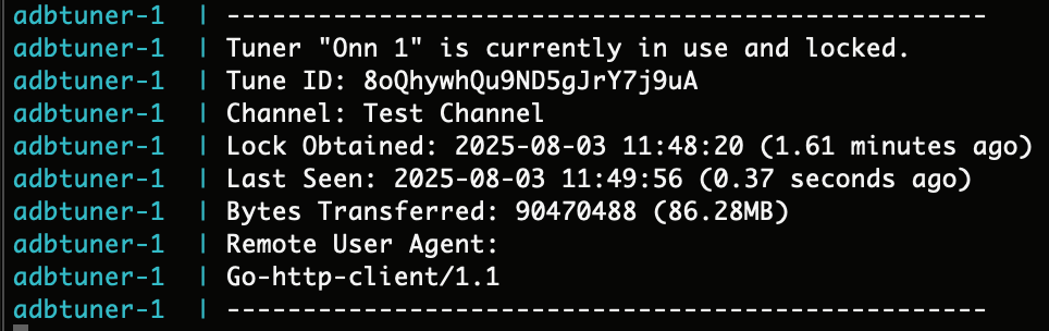

A couple of small updates in the development version (20250802-1):
  1. To assist in troubleshooting, ADBTuner will now log a list of locked tuners every 30 seconds (if there are any).
  2. The pause button in the web interface preview player will now reset the player entirely. By design, the video player continues streaming while in a paused state so the video can be resumed. This is problematic in this application because it would keep the tuner locked.
Please refresh your browser window to make sure you are using the current version of the web interface.

Every 30 seconds a log entry like the screenshot below will be written for each locked tuner. If a tuner is supposed to be unlocked, but there is still an active connection that is consuming data we need to figure out what is causing that to happen. I wanted to include the client ip address here, but that information is not easily available within a container so we will have to make do without.

2025-08-03 15:07:51.576 - lib.adb - ADB: 192.168.2.113 - Connected.
2025-08-03 15:07:51.726 - lib.adb - ADB: 192.168.2.113 - Connected.
2025-08-03 15:07:51.866 - lib.adb - ADB: 192.168.2.239 - Connected.
2025-08-03 15:07:52.089 - lib.adb - ADB: 192.168.2.239 - Connected.
2025-08-03 15:07:55.788 - tuner_management - Releasing tuner 5 as it has been inactive for 10 seconds.
2025-08-03 15:07:55.788 - tuner_management - Releasing tuner: {'lock_obtained': 1754251641, 'tuner_name': 'Encoder #2 FireTV Max MR', 'name': 'BBC News', 'number': 6026, 'provider_name': 'Youtube TV', 'tuner_id': 5, 'channel_id': 11, 'request_key': '2fxYzGtUcvEFw9dhnS7adB', 'target_package': 'com.amazon.firetv.youtube.tv'}
2025-08-03 15:07:55.858 - lib.adb - [Tune 2fxYzGtUcvEFw9dhnS7adB] ADB: 192.168.2.64 - Connected.
2025-08-03 15:07:55.982 - server - Tuner monitor crashed. Restarting. Error: 'NoneType' object is not subscriptable
  File "/app/app/main.py", line 102, in tuner_monitor_supervisor
    release_disconnected_tuners(app.tuner_manager)
  File "/app/app/tuner_management.py", line 214, in release_disconnected_tuners
    tune_complete(
  File "/app/app/tuner_management.py", line 293, in tune_complete
    f"{log_prefix}Using configuration: {channel_configuration['name']} ({channel_configuration['uuid']}) for channel cleanup."
TypeError: 'NoneType' object is not subscriptable
2025-08-03 15:07:56.289 - uvicorn.access - 192.168.2.143:0 - "GET / HTTP/1.1" 200
2025-08-03 15:07:56.441 - lib.adb - ADB: 192.168.2.199 - Connected.
2025-08-03 15:07:56.459 - lib.adb - ADB: 192.168.2.199 - Connected.
2025-08-03 15:07:56.754 - lib.adb - ADB: 192.168.2.135 - Connected.
2025-08-03 15:07:56.845 - lib.adb - ADB: 192.168.2.135 - Connected.
2025-08-03 15:07:57.114 - lib.adb - ADB: 192.168.2.64 - Connected.
2025-08-03 15:07:57.264 - lib.adb - ADB: 192.168.2.64 - Connected.
2025-08-03 15:07:57.379 - lib.adb - ADB: 192.168.2.113 - Connected.
2025-08-03 15:07:57.575 - lib.adb - ADB: 192.168.2.113 - Connected.
2025-08-03 15:07:57.709 - lib.adb - ADB: 192.168.2.239 - Connected.
2025-08-03 15:07:57.992 - lib.adb - ADB: 192.168.2.239 - Connected.
2025-08-03 15:08:00.996 - tuner_management - Releasing tuner 5 as it has been inactive for 15 seconds.
2025-08-03 15:08:00.996 - tuner_management - Releasing tuner: {'lock_obtained': 1754251641, 'tuner_name': 'Encoder #2 FireTV Max MR', 'name': 'BBC News', 'number': 6026, 'provider_name': 'Youtube TV', 'tuner_id': 5, 'channel_id': 11, 'request_key': '2fxYzGtUcvEFw9dhnS7adB', 'target_package': 'com.amazon.firetv.youtube.tv'}
2025-08-03 15:08:01.072 - lib.adb - [Tune 2fxYzGtUcvEFw9dhnS7adB] ADB: 192.168.2.64 - Connected.
2025-08-03 15:08:01.183 - server - Tuner monitor crashed. Restarting. Error: 'NoneType' object is not subscriptable
    tune_complete(
REPEATS...
