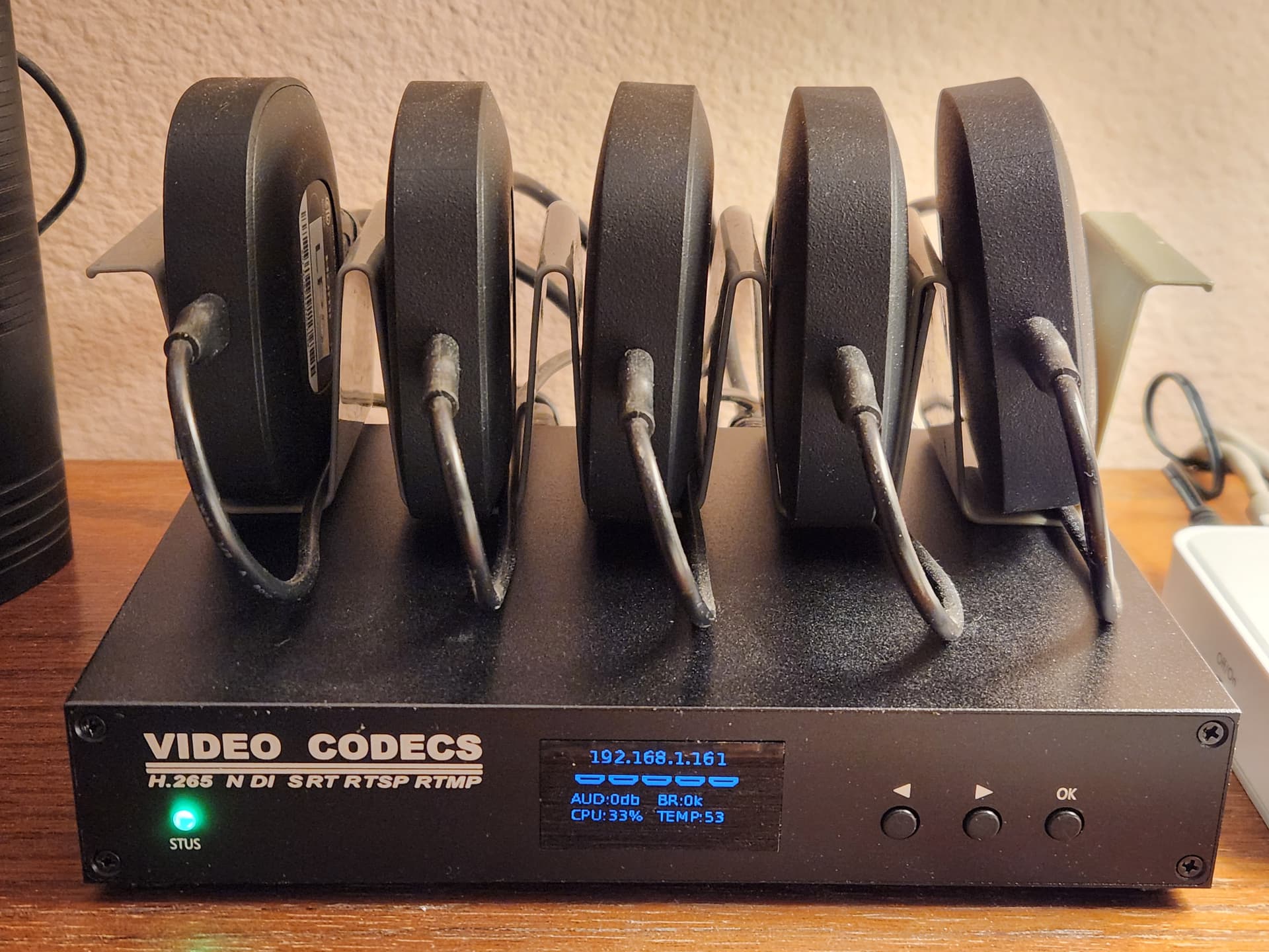

My onn 4k pro's have been rock solid for the adbtuner setup and they have ethernet. I won't go with anything that doesn't have built in ethernet. I keep all my heavier and time sensitive traffic devices off wireless whenever possible. Most likely I will continue to buy more of them.
For budgetary reasons, I'm running five ONN 4k non-pro's on wifi.
I'd like to switch to the wired Pro boxes. But, I'll have to wait until I see a better sale. Right now, on sale, they're still $44.73 each. Maybe Black Friday. For now, this setup is working fine.
I like the rack you have them in. I will have to look around for something like that. I have a 4 tuner codec at each site with 4 devices hooked up on each. I will need to watch prices to slowly replace the 4 ccwgtv devices before they all get hit with android tv 14. So far one has upgraded with 3 more still running 12. Fingers crossed they hold out for awhile longer.
That rack is actually a pair of taco holders cut and spliced together. Each single holder only had the capacity for four :taco::taco::taco::taco:'s. They came in a pack of 8 holders from Amazon for $12. I used two of them for this project, and the others continue to fulfill their intended purpose. In fact, we just enjoyed using them this evening. :yum:

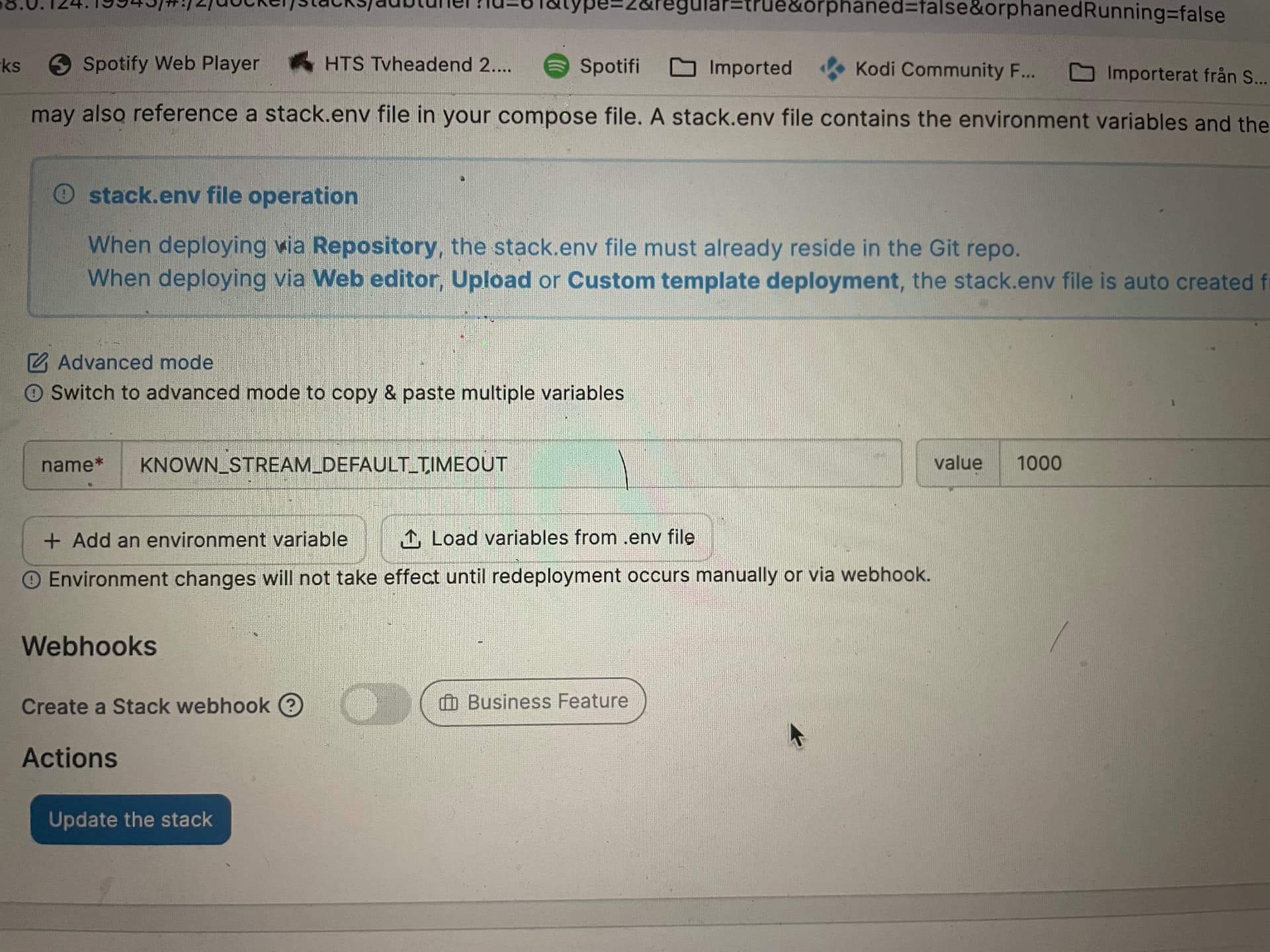

You can override that by setting the KNOWN_STREAM_DEFAULT_TIMEOUT environment variable.

Did you restart the container after making that change? That parameter is only loaded at startup.
Just a heads-up, there really isn't much range to play around with on this. ADBTuner checks the status of active streams every second, however the execution time of each check needs to be accommodated for. In my testing so far, we are looking at ~1.2 seconds between each status check, but this may vary for each environment. Setting this parameter lower than that will result in tuners being released that should still be locked. I probably wouldn't go below 2 seconds, I think 3 seconds is safer. On the high end, any tuner that sits idle for 40 seconds will be released.
