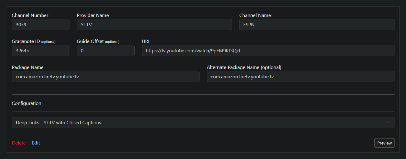

Here's an ADBTuner custom config for turning on Closed Captions (CC) when tuning to a channel in YouTube TV. For use with turtletank99/adbtuner:development
    "name": "Deep Links - YTTV with Closed Captions",
    "author": "bnhf",
    "version": "0",
    "description": "Turn on Closed Captions (CC) in the YTTV app 10 seconds after channel tuning",
    "uuid": "c7f31cd0-ead1-449d-ab90-2d926382c7db",
    "global_options": {
        "use_fixed_delay": false,
        "fixed_delay_seconds": 0,
        "check_for_and_clear_whos_watching_prompts": false,
        "wait_after_post_playback_start_commands_seconds": 10
    "pre_tune_commands": [
        "input keyevent KEYCODE_MEDIA_STOP"
    "tune_commands": [
        "am start -W -a android.intent.action.VIEW -d '||TARGET_URL_OR_IDENTIFIER||' '||TARGET_PACKAGE_NAME||'"
        "input keyevent KEYCODE_DPAD_DOWN KEYCODE_DPAD_DOWN KEYCODE_DPAD_LEFT KEYCODE_DPAD_LEFT KEYCODE_DPAD_DOWN KEYCODE_DPAD_RIGHT KEYCODE_DPAD_CENTER"
    "post_tune_commands": [
        "input keyevent KEYCODE_MEDIA_PAUSE"
This can be used in a few different ways:
Use the ADBTuner WebUI to change the Configuration just before tuning, if you only want CC occasionally.
Same thing if you want CC all the time for a given channel, with no need to change it back.
Or, if you don't want to use the WebUI at all after initial setup, you can create duplicate channels (one with and one without CC (e.g. ESPN and ESPN [CC])
Yeah...this will be useful. You don't want to use this for sporting events or news programs as the subs will be FAR behind the action anyways :smiley:
Maybe I'm missing your point? But, this turns subtitles on at the streaming stick that's being captured -- so they'll be shown just as they would if you're watching the event using the app on your local device. No difference in synchronization.
