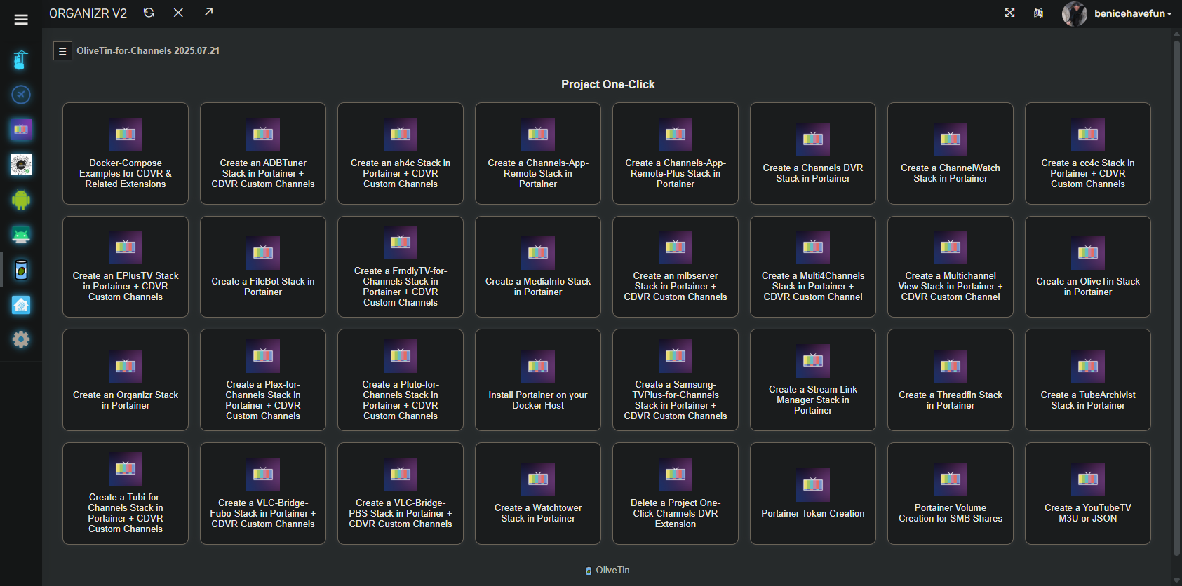

OliveTin of course :slight_smile: , for spinning-up whatever without having to hunt down the instructions:

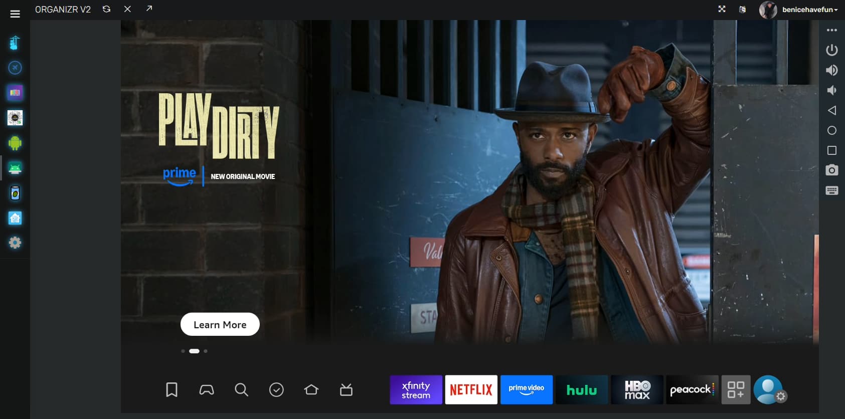

ws-scrcpy is something I have integrated into ah4c, but could probably be configured to work with ADBTuner as well. This allows for being able to interact with your streaming stick in a browser Window, complete with an ADB shell if needed:

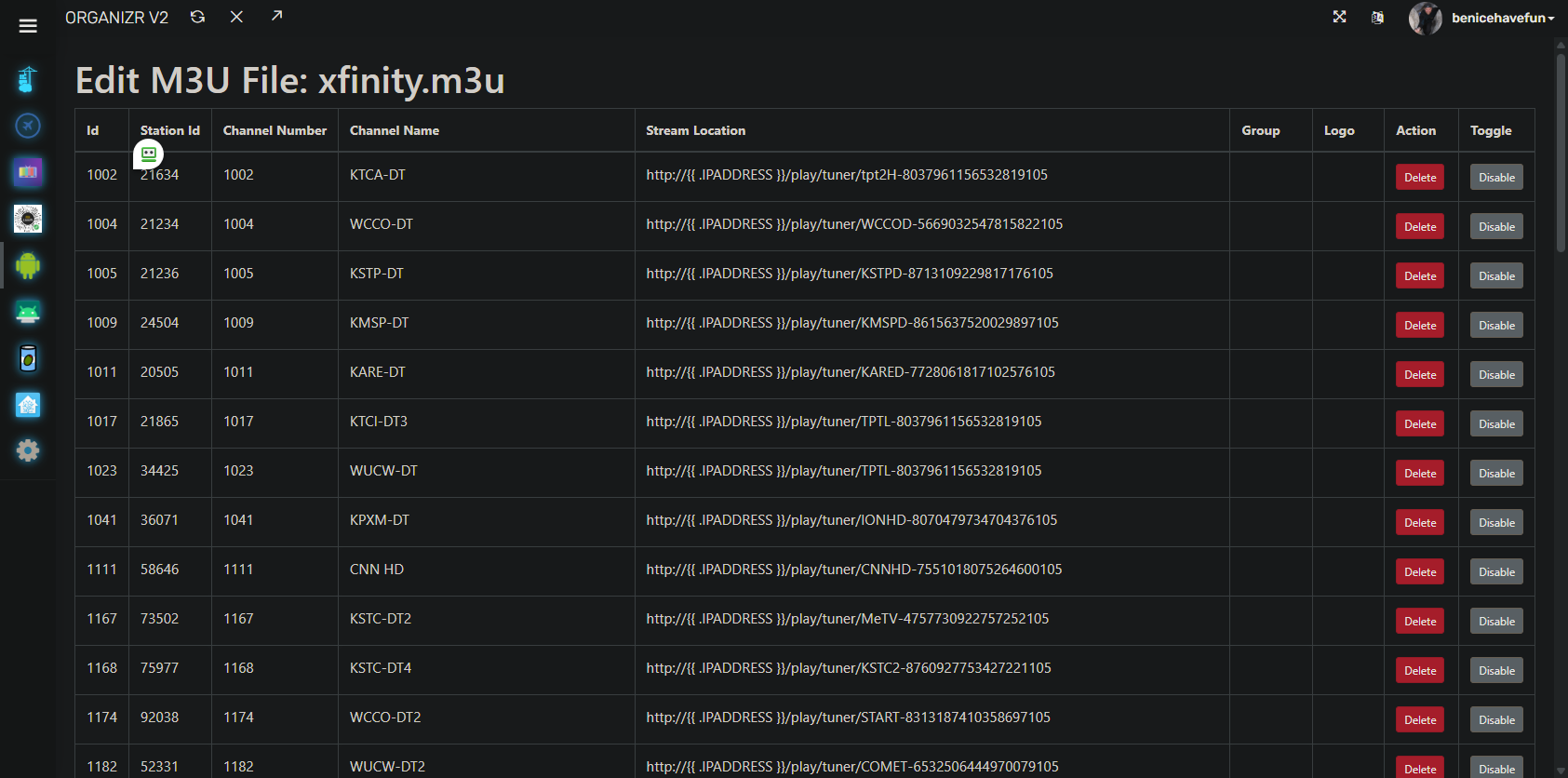

The ah4c M3U Editor, thought this could just as easily be the ADBTuner WebUI:

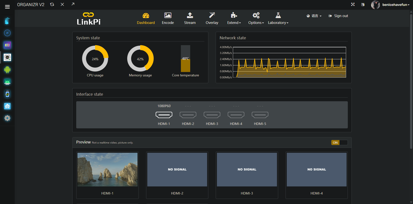

The LinkPi encoder WebUI:

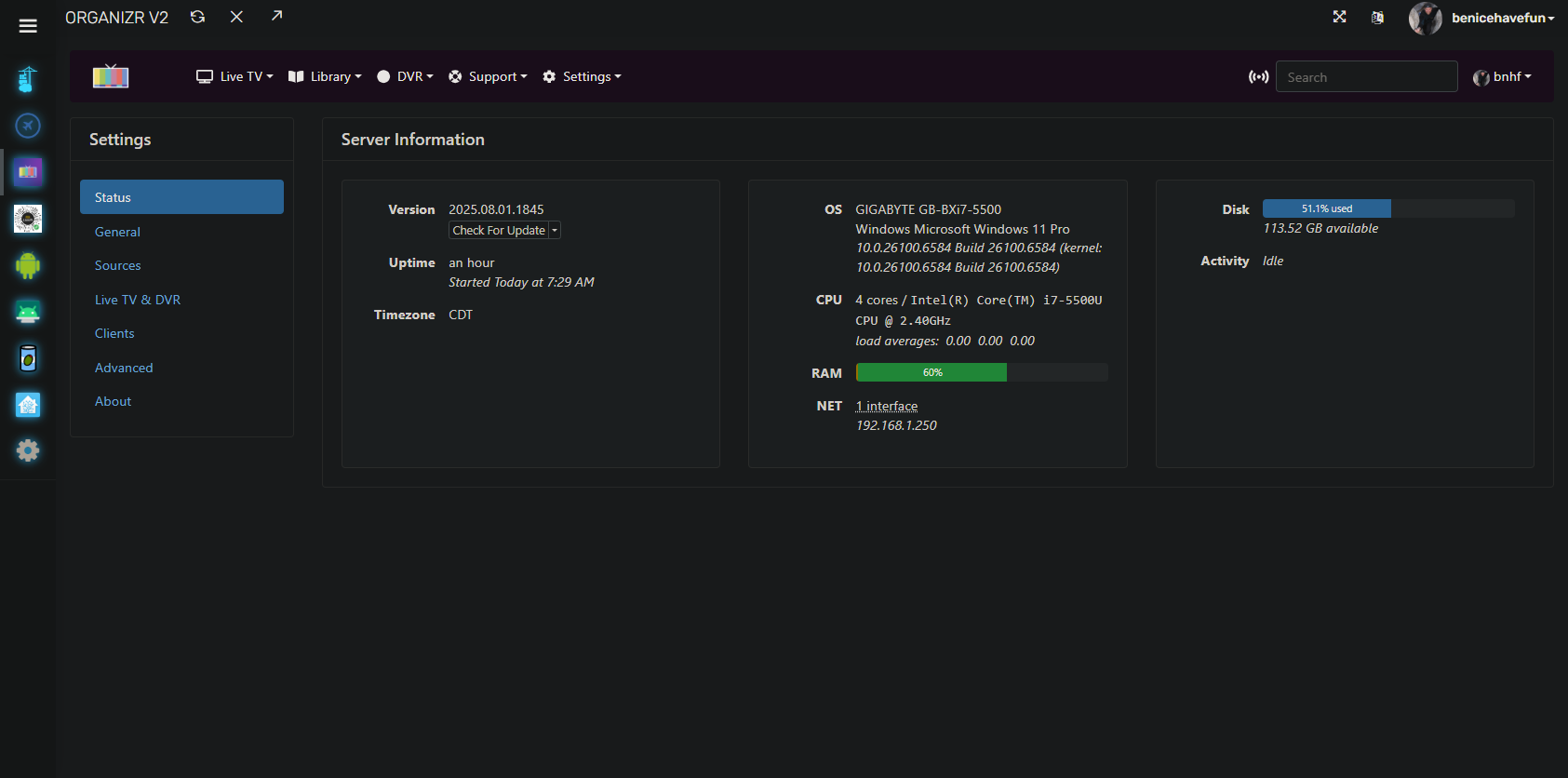

Channels DVR of course:

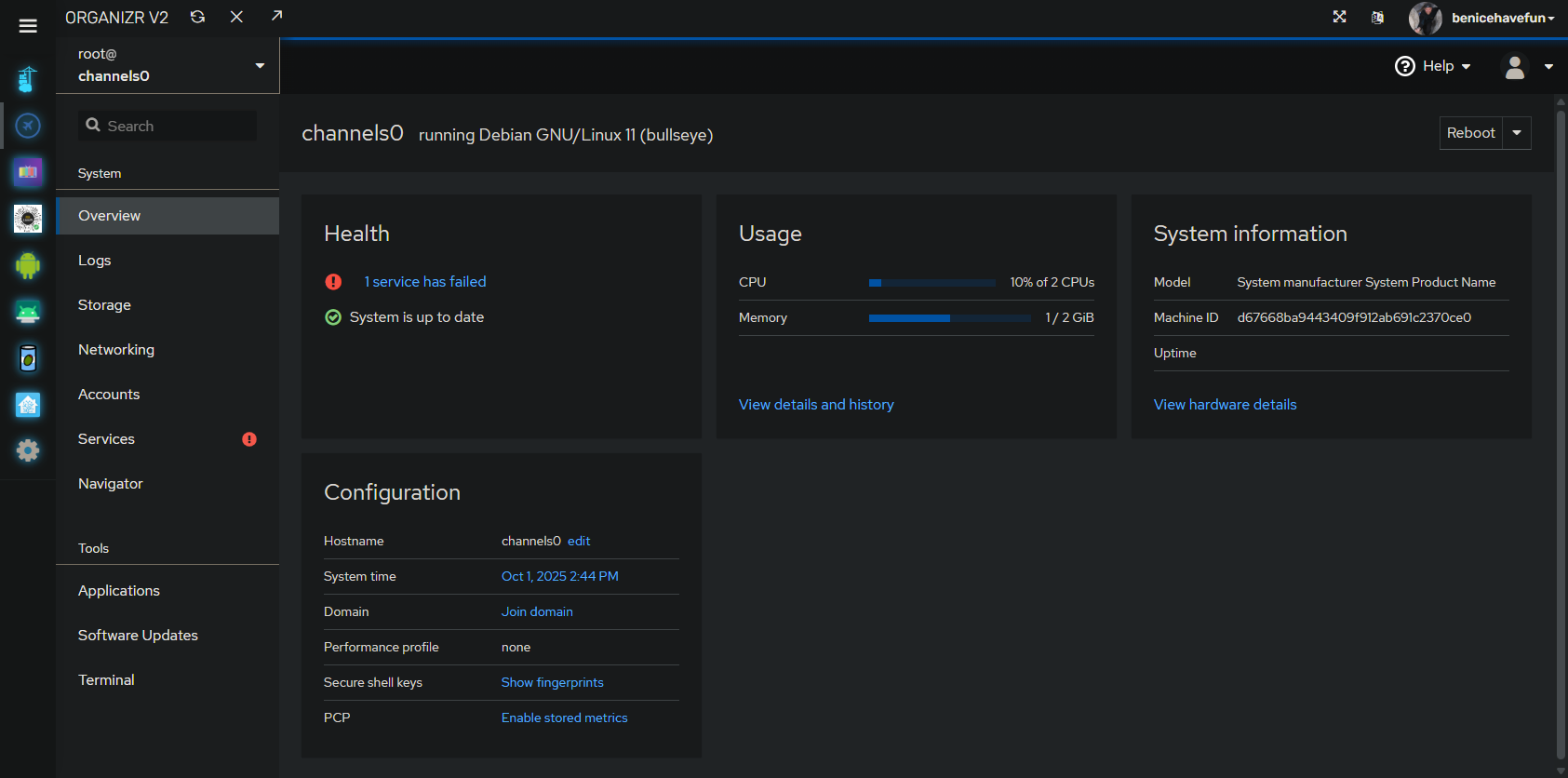

Cockpit with Cockpit-Navigator for being able to manage the Debian LXC running all these containers on Proxmox:

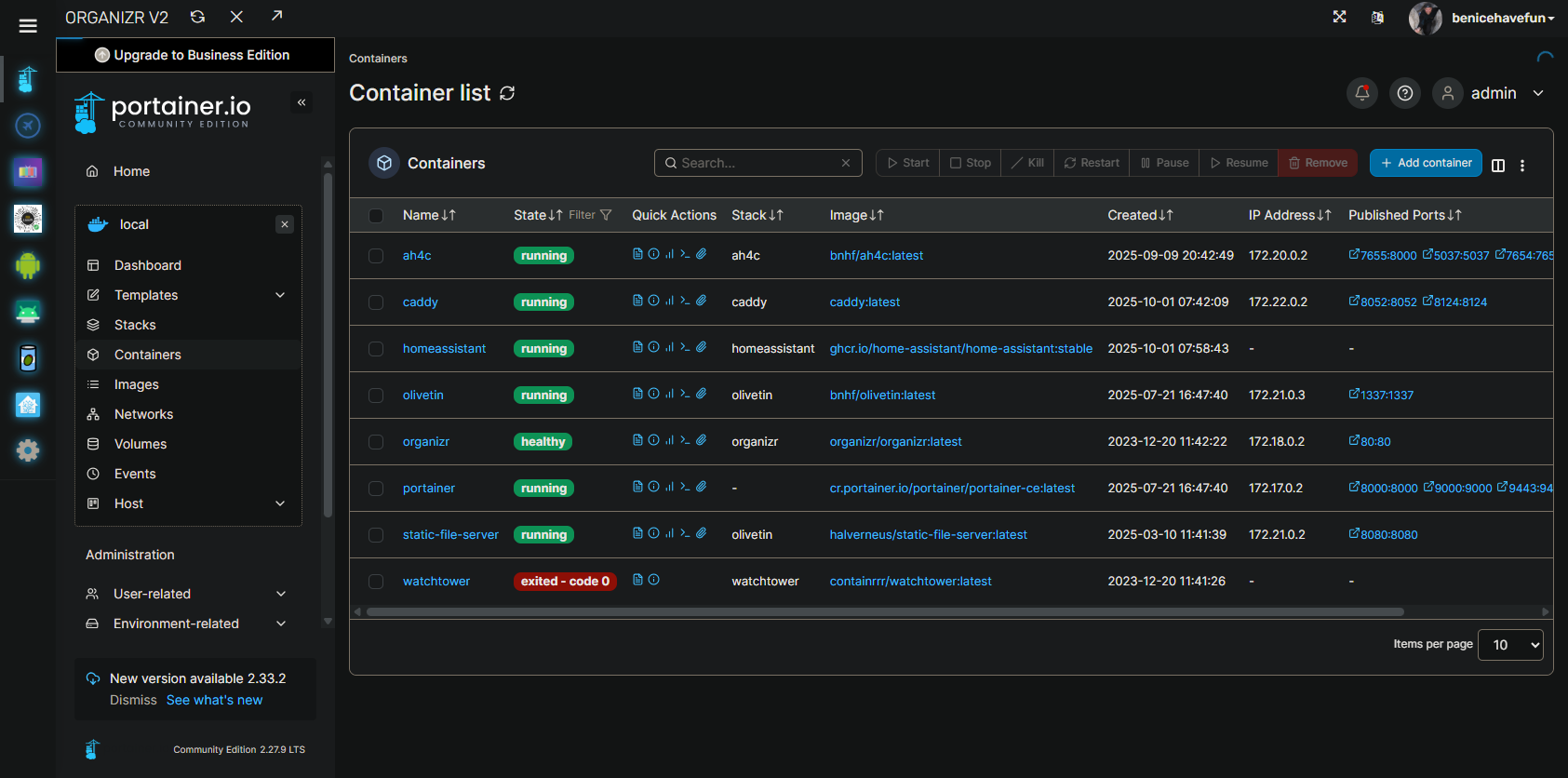

Portainer for outstanding Docker container management:

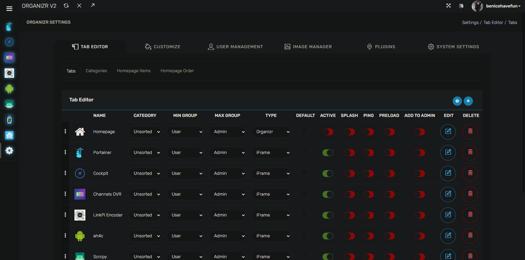

And lastly, the tool that allows all of these WebUIs to run in a single browser tab, Organizr:
