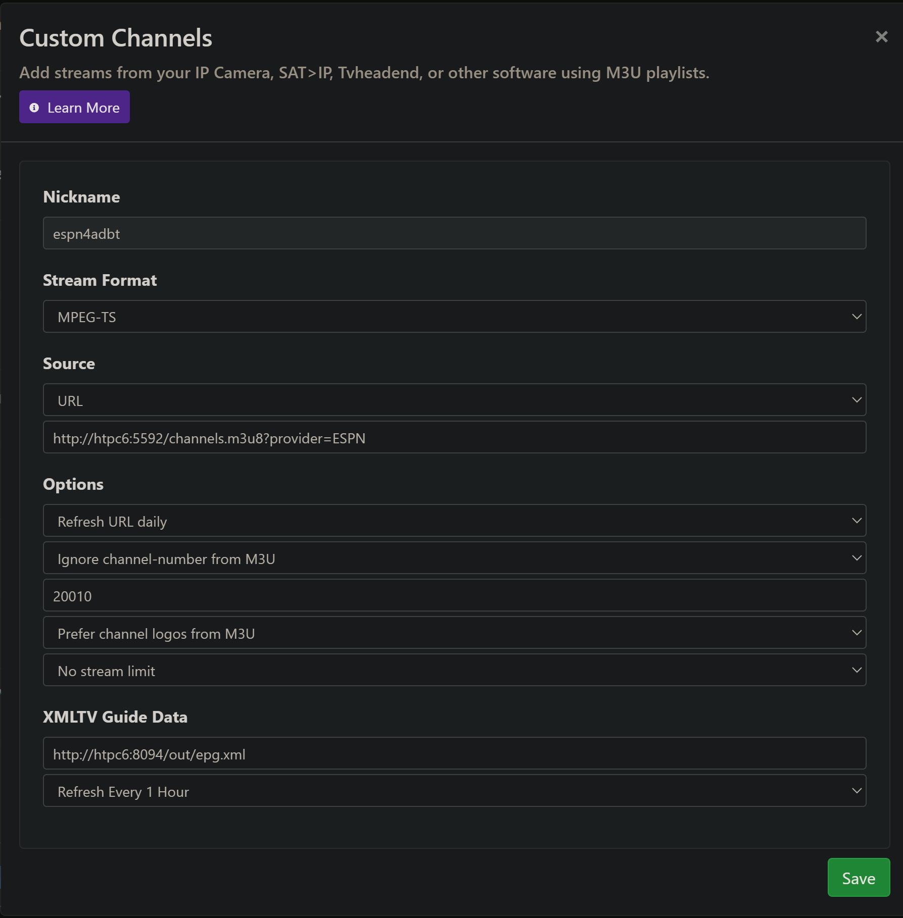

Using recent features added by @turtletank to ADBTuner and @KineticMan to ESPN4cc4c. it's now possible to implement a hybrid of both projects!
What you'll get, with the set of steps below, are 40 custom channels with ESPN+ events on them (for ESPN+ subscribers only of course).
First, spin up @KineticMan's project, which you can either build locally with his instructions -- or use this Docker Compose to pull it off of Docker Hub:

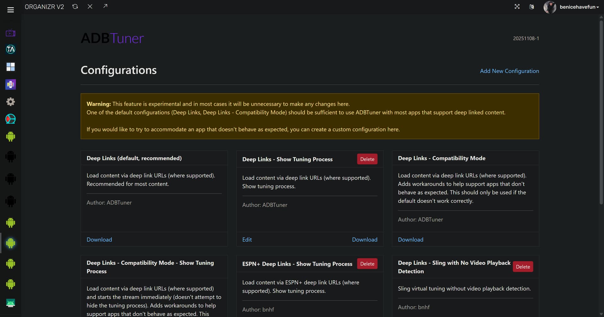

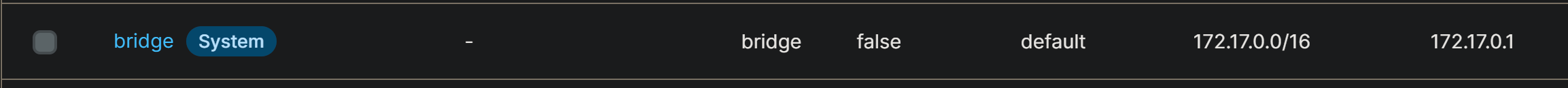

Next, for ADBTuner, you'll want to be running at least development build 20251108-1. If you're a Windows or Mac user an internal host called host.docker.internal should already be configured. Linux users will want to add this to their Docker Compose (Portainer is once again the easiest way to do this):
    extra_hosts:
      - host.docker.internal:${DOCKER_GATEWAY:-host-gateway} # host.docker.internal is generally not predefined on Linux hosts.
With ADBTuner updated, and extra hosts: added, you'll need the following in your ADBTuner Custom Configurations:
    "name": "ESPN+ Deep Links - Show Tuning Process",
    "author": "bnhf",
    "version": "1.0",
    "description": "Load content via ESPN+ deep link URLs (where supported). Show tuning process.",
    "uuid": "51af5028-092f-4ddc-b4ea-d5e5fca58cac",
    "global_options": {
        "wait_for_video_playback_detection": false,
        "use_fixed_delay": true,
        "fixed_delay_seconds": 1,
        "check_for_and_clear_whos_watching_prompts": false,
    "pre_tune_commands": [
        "input keyevent KEYCODE_MEDIA_STOP"
    "tune_commands": [
        "am start -n ||TARGET_PACKAGE_NAME||/com.espn.startup.presentation.StartupActivity -d ||TARGET_URL_OR_IDENTIFIER||"
        "sleep 20",
        "input keyevent KEYCODE_DPAD_DOWN",
        "input keyevent KEYCODE_DPAD_RIGHT",
        "input keyevent KEYCODE_DPAD_CENTER"
    "post_tune_commands": [
        "input keyevent KEYCODE_MEDIA_PAUSE",
        "input keyevent KEYCODE_HOME"
Next, in the ADBTuner WebUI Import/Export, you can import this list of 40 fixed channels for your ESPN+ events to appear on in the guide:
        "provider_name": "ESPN",
        "number": "",
        "name": "ESPN+1",
        "url": "http://host.docker.internal:8094/whatson/1?deeplink=1&dynamic_url_json_key=deeplink_url",

And finally, to put them together, the M3U will come from ADBTuner and the XML from ESPN4cc4c:
As always, be sure you have the ESPN app installed on your encoder-attached streaming sticks, and are logged in with your credentials. 20010 is the recommended starting channel number to use (assuming it's available on your setup) for the guide data to match automatically.
BTW, you can also use this same guide data for cc4c or ah4c.

I'm on Mac, believe i did this via 1-click (but not 100% sure), and don't have this set.
I added it via portainer, updated, and still not seeing anywhere to add the custom config. I'm on 20251109-4
You'd want your ADBTuner Docker Compose to look something like this:

The ADBTuner custom config section is found here:
http://<docker host>:5592/configurations
thanks - this was my gap.

Check in Portainer-Networks, and see what the IP address of your Docker Gateway bridge is:
If it's something other than 172.17.0.1, we'll need to adjust the value of DOCKER_GATEWAY in the env vars section of your adbtuner stack.
it is 172.17.0.1 , but i also tried setting explicitly - no change unfort
