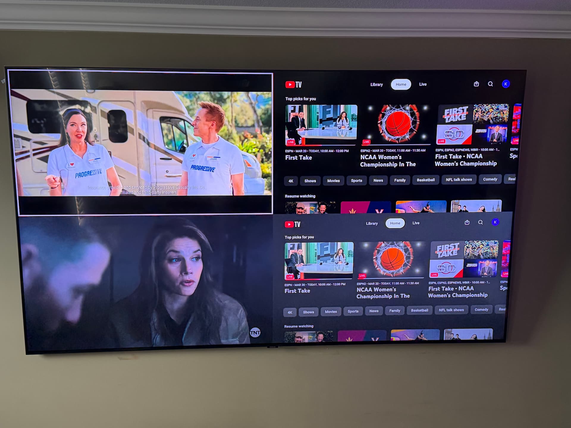

Wonder if this could be tweaked to work with ADBTuner and HDMI capture.
