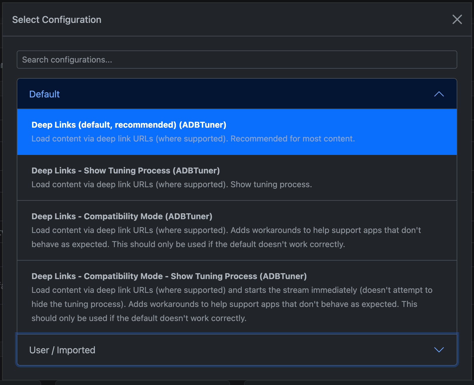

  • Improved UX for managing and selecting configurations

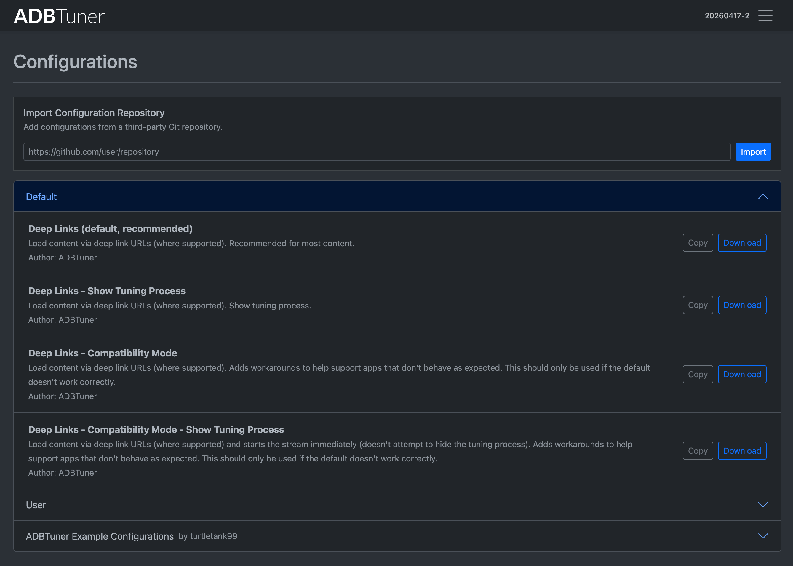

  • Added new adbtuner_open_app command that can be used to open a specific android app without having to which activity is needed to do so.
  • Added ADB_LOOP command that can be used in custom configurations that require some form of iteration.
  • Added support for http requests within configurations.
  • Added the ability to wait for application focus in pre-tune commands (WAIT_FOR_FOCUS).
  • Removed the legacy check_for_and_clear_whos_watching_prompts option (now handled per configuration via tune_match_text_commands)
Third-Party Configuration Repositories
  • Added the ability to link a third-party configuration repository to an ADBTuner instance. This allows users to load community managed configurations and allows developers of these configurations to automatically update them.
  • Note: Custom configurations are still not needed for most Android apps. You should only need to go down this path if some specific app you are trying to use doesn't work with standard or compatibility mode deep links.
