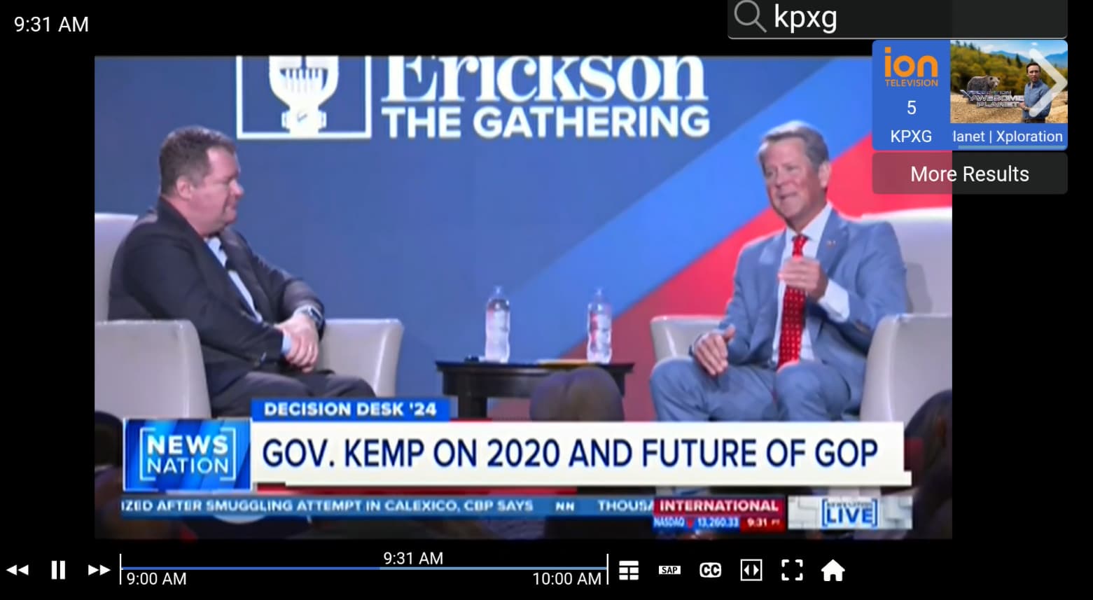

This is working well for me, such a cool addition to adbtuner. I tested with two ATSC3 channels, of course the DRM on the other two is preventing playback. And so we wait.
