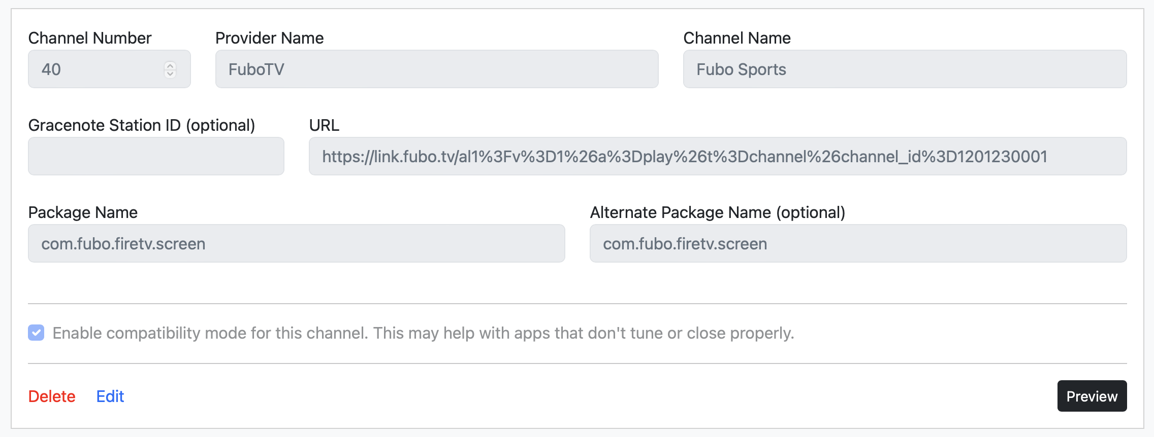

You probably did this already, but double check that you have the correct package name for the Chromecast version of each app in either the Package Name or Alternate Package Name fields for each "channel." If you don't, that might explain the app not launching at all.

Here's how I have them set, I think that's right. There doesn't seem to be any rhyme or reason to it that I can see, I've set the timeout adb commands.

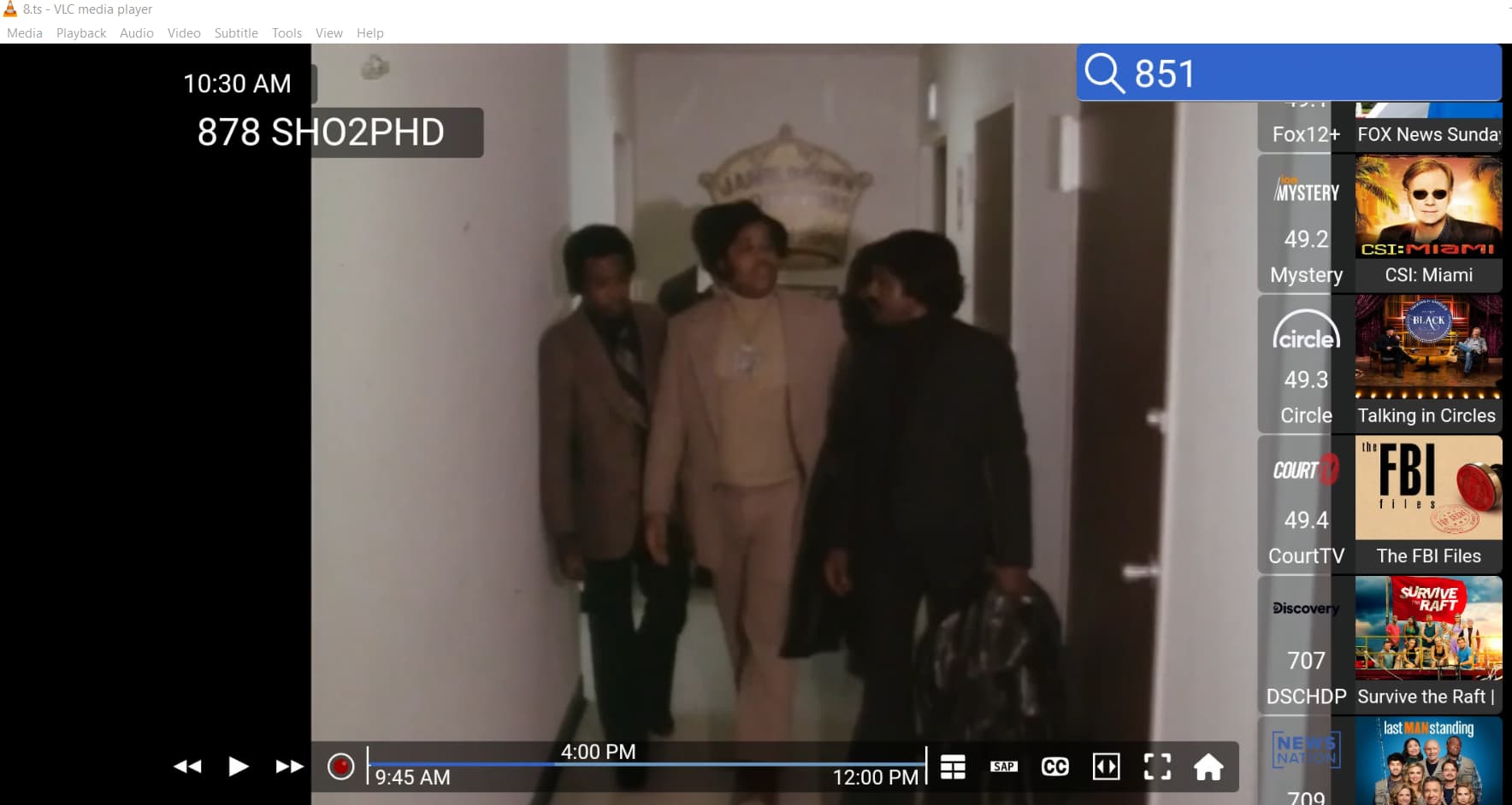

I am getting hits and misses on the HDHomerun tuner ..... I see you added a pause and that seems to be causing problems.
Ok. The pause was the fix to your other issue. It should unpause if necessary, but it never got to that point because channel 851 was never selected. If you use the app directly and search for 851, does it work as expected?
What is that recording indicator in playback bar? Is that from the HDHomeRun DVR? A long shot, but can you check if your misses are all when tuning away from a channel (in the HDHomeRun app) that is being recorded?
