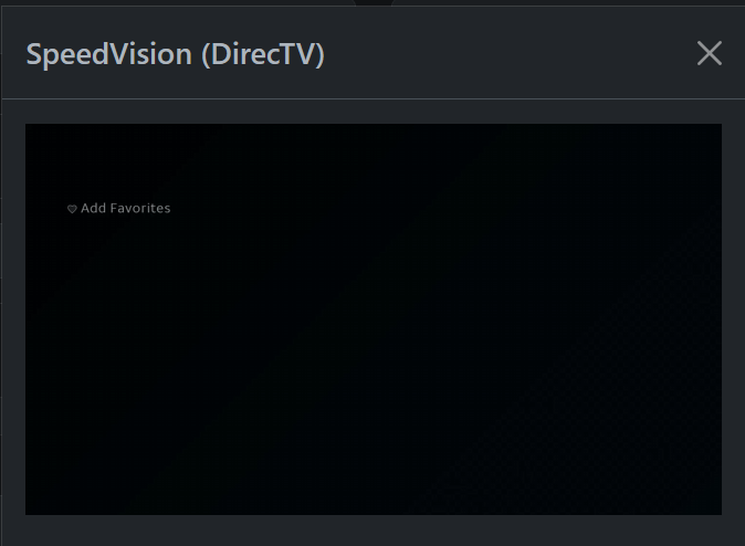

This is what I get.
Are you using the ADBTuner Custom Config in the post just above yours? It's the best one to use atm. Is your ADBTuner container up-to-date?
Are you properly logged into your DirecTV app? Does it play properly when you use the physical remote, rather than tuning it with ADBTuner?

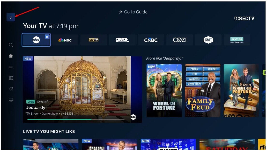

Something looks a a bit off in your app screenshot. Do you have more than one profile for your DTV app? I don't see a profile icon on your screen, like the "J" in the blue box in the upper left of my screen shot:

Please post an ADBTuner log snippet from a failed tune -- start to finish.

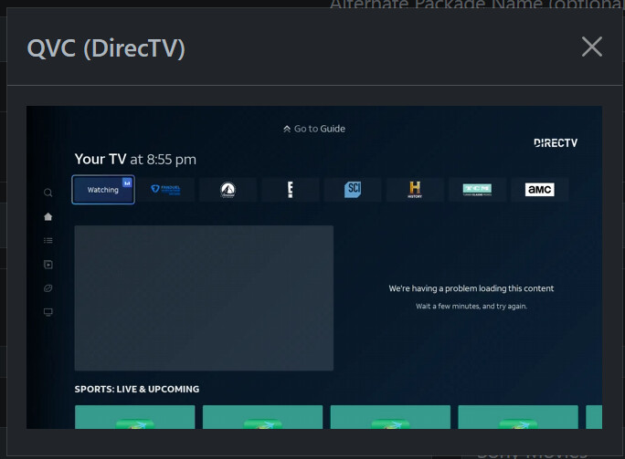

Also, a screenshot of that same channel's details from the ADBTuner WebUI, could be helpful.
I created a free account to make sure that was not the problem
created a link to one of the channels and this is what I get:
I think DTV is more trouble that its worth.

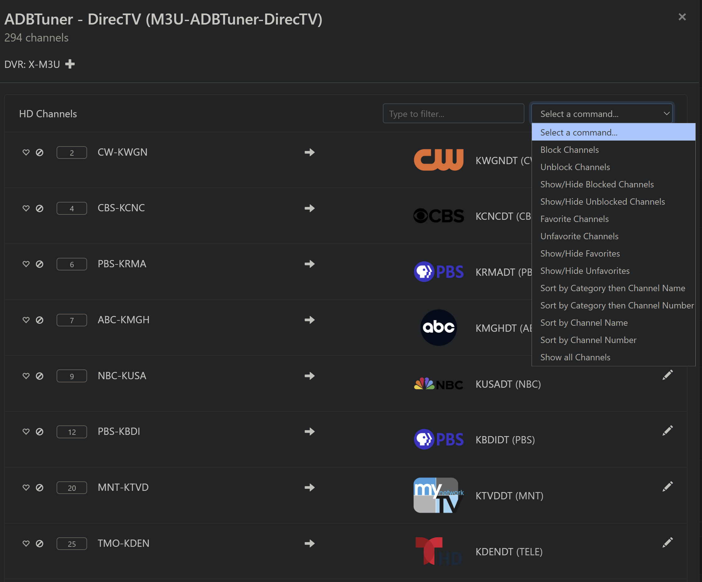

Is there a way to limit (sort) how many of these channels are imported?
No. Everything in your subscription is added, after that you can use the usual tools to whittle down the lineup using Manage Lineup in CDVR Sources.
The Manage Lineup Helper Tool/Bookmarklet is handy here (included with OliveTin-for-Channels), like it is for many sources:

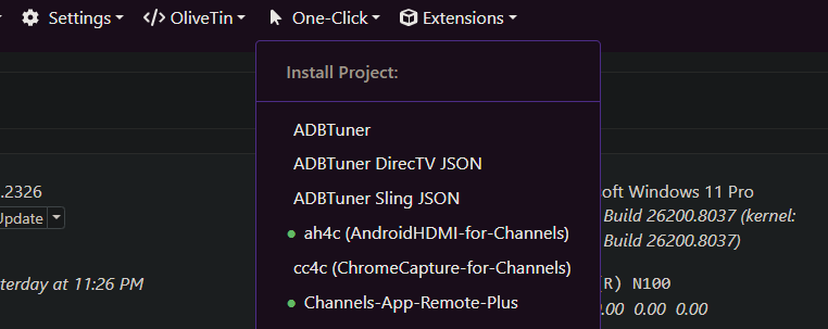

finally getting adbTuner setup to add onto ah4c. I assume this has matured to latest, as that's what i've done and so far so good, gotta get the tuners setup yet.
also this thread was really hard to find because the Directv gets truncated in any search results. also keywords AdbTuner Directv json returns nothing, but cURL returns alot.

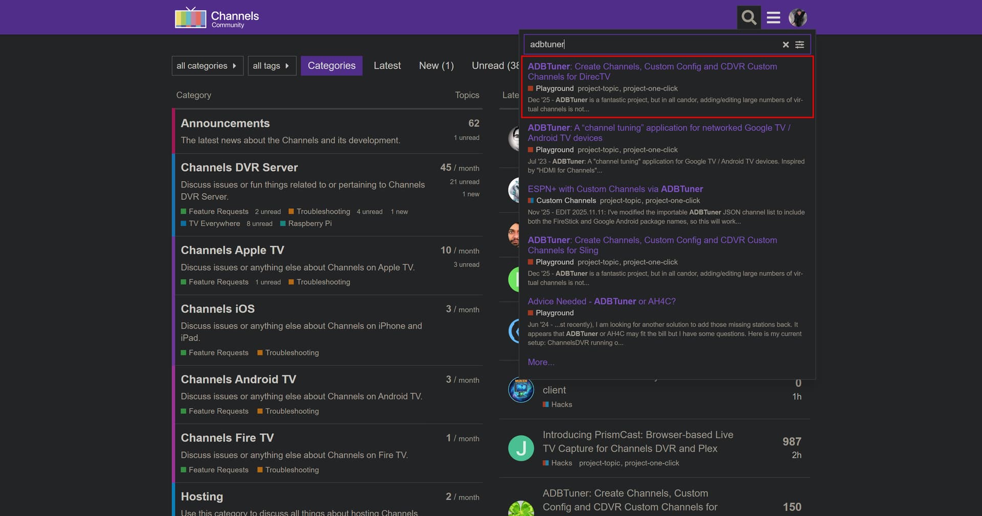

Search for adbtuner, and it's the #1 hit:
Or, do a project-one-click tag search, and it the #2 hit:
ok, well, last night i was seaching adbtuner directv json and getting no hits.
tonight as I was posting, I got a perfect set of hits... musta caught some server maintenance
I had this working the other day, but nuked the setup to re-plan my tuner setup. unfortunately i did not save the json and today i'm getting this error
POST http://10.0.0.7:1337/api/StartActionAndWait
Action: adbtuner_directv_grabber
dvr: 10.0.0.7:8089
ADBTUNER_HOST: 10.0.0.7
ADBTUNER_PORT: 5592
CURL_COMMAND: curl 'https://api.cld.dtvce.com/discovery/metadata/channel/v5/service/allchannels?sort=OrdCh%253DASC&clientContext=dmaID%3A679_0%2CbillingDmaID%3A679%2CregionID%3AMLB+KC+Royals+Choice+OTT+SPOT_MLB+STL+Cardinals+Choice+OTT+Zipcodes+SPOT_MLB+Twins+Sports+Pack+SPOT_FSMIAPH_RegC+Des+Moines+IA_MLB+MIL+Brewers+Sports+Pack+OTT+SPOT_OV2+RegC+Des+Moines+IA_STL+CARDINALS+sb+RSN+V2+SPOT_BG10O2H_CSN+Chicago+Spot+SPOT_KAN+Royals+sb+RSN+V2+SPOT_BGTN4HD_BGTN3HD_BIG10HD_FSMIA1H_BS+Midwest+OOM+B%2FO_IND+Pacers+sb+RSN+SPOT_FSN+Midwest+Spot+SPOT_STL+Blues+RSN+SPOT_BTN4OF_BTN3OF_MIN+Twolves+sb+RSN+SPOT_BTN2OF_Marquee+Sports+Network+v2+SPOT_Marquee+Sports+Network+SPOT_OV+Des+Moines-Ames+IA+679_MIN+Wild+RSN+SPOT_MIL+BREWERS+sb+RSN+SPOT_OVTelemundoEast_OV+Telemundo+East+82624+SPOT_OV+Des+Moines+IA+DMA+679_OV+Telemundo+East+123022+SPOT_OV+Telemundo+East+072222+SPOT%2CzipCode%3A50023%2CcountyCode%3A153%2CstateNumber%3A19%2CstateAbbr%3AIA%2CusrLocAndBillLocAreSame%3Atrue%2CbRegionID%3AMLB+KC+Royals+Choice+OTT+SPOT_MLB+STL+Cardinals+Choice+OTT+Zipcodes+SPOT_MLB+Twins+Sports+Pack+SPOT_FSMIAPH_RegC+Des+Moines+IA_MLB+MIL+Brewers+Sports+Pack+OTT+SPOT_OV2+RegC+Des+Moines+IA_STL+CARDINALS+sb+RSN+V2+SPOT_BG10O2H_CSN+Chicago+Spot+SPOT_KAN+Royals+sb+RSN+V2+SPOT_BGTN4HD_BGTN3HD_BIG10HD_FSMIA1H_BS+Midwest+OOM+B%2FO_IND+Pacers+sb+RSN+SPOT_FSN+Midwest+Spot+SPOT_STL+Blues+RSN+SPOT_BTN4OF_BTN3OF_MIN+Twolves+sb+RSN+SPOT_BTN2OF_Marquee+Sports+Network+v2+SPOT_Marquee+Sports+Network+SPOT_OV+Des+Moines-Ames+IA+679_MIN+Wild+RSN+SPOT_MIL+BREWERS+sb+RSN+SPOT_OVTelemundoEast_OV+Telemundo+East+82624+SPOT_OV+Des+Moines+IA+DMA+679_OV+Telemundo+East+123022+SPOT_OV+Telemundo+East+072222+SPOT%2CisFFP%3Afalse%2CdeviceProximity%3AIH&fisProperties=ISF%3A1.4%23chlogo-bwdb-mytv%2C47%2C35%23chlogo-clb-guide%2C60%2C45%23chlogo-cdb-gcd%2C87%2C66%23chlogo-bwdb-player%2C120%2C91%23chlogo-bwdb-fplayer%2C120%2C91&include4K=false&is4KCompatible=false&isFtue=true' \ -H 'accept: */*' \ -H 'accept-language: en-US,en;q=0.9' \ -H 'authorization: Bearer +pEhUlg4DOhEeTgzUXZmu+hxfIwRKYdR9dVgVZ6Z3YRZ554KS8/MhikH3dlOZfoxGrvLW7C3R45pIEtb3JrJVQG4Uy1pqidFgMclbtoAEu4d4meJtVu8qRgnNSpdr1ysJ+rzBi81+lnn0zM5VEJj/LAE7UjPMiWuub6ZWvxs/UwLtBxgjM9Mqbv6N0DfHAiWOMBu8jKIHk7SKgjBHFf3SVfNx/mL1bKHc9TUkM3iqkB69JJOICRyMiMeKTs08znlBILBsFrFqsoh75fxXAz6hf3zsJD68xMMFrJiuyiZInGOVHep2xXvsjOoFtfNub0boTIUs+KKZw2dsLxgYwIyILJ24x39z0CP7JrT7fUC0gtWkeEIzXLgqaxRvafliR+dA8GN1aOW2u6tG/ZX2MGyv9gkfPmm/lzB5x8A0bl/gygXKZdyr8ltKaVSFnQk6B3nuk27ph4R97O0t6SWPl90JAv0RSDX0TwjrKv39jRl3SYglGiPN6cTkAIn44h+PzI/75t26cfiSqpMmPI1UkgPL3uiuc1lHq5qCmKx/ngozhnJ+UovUpDpJq4GF+eBRKFwtT+zctmx/iSDXkP/uNlhHUNDQkUI85+gqUO/9LIvDO/aTrrccIqUH2vhEO8Gl8QP.E6e8lXsQ4tN2xk8l1utAATVySoSPVh/irgAAJUmXKPQ=' \ -H 'origin: https://stream.directv.com' \ -H 'priority: u=1, i' \ -H 'referer: https://stream.directv.com/' \ -H 'sec-ch-ua: "Chromium";v="146", "Not-A.Brand";v="24", "Google Chrome";v="146"' \ -H 'sec-ch-ua-mobile: ?0' \ -H 'sec-ch-ua-platform: "Windows"' \ -H 'sec-fetch-dest: empty' \ -H 'sec-fetch-mode: cors' \ -H 'sec-fetch-site: cross-site' \ -H 'user-agent: Mozilla/5.0 (Windows NT 10.0; Win64; x64) AppleWebKit/537.36 (KHTML, like Gecko) Chrome/146.0.0.0 Safari/537.36'
CUSTOM_CONFIG: "name": "DirecTV", "author": "David B.", "version": "3.0.0", "description": "Reliable tuning for DirecTV. Prevent are you still there prompt from showing.", "uuid": "3c7d5a19-6f2e-4b8a-9d3f-8e1c4b7a5f92", "global_options": { "wait_for_video_playback_detection": true, "use_fixed_delay": false, "fixed_delay_seconds": 0, "check_for_and_clear_whos_watching_prompts": false, "wait_after_post_playback_start_commands_seconds": 0 }, "pre_tune_commands": [ "input keyevent KEYCODE_MEDIA_STOP", "am force-stop ||TARGET_PACKAGE_NAME||" ], "tune_commands": [ "am start -W -n '||TARGET_PACKAGE_NAME||'/$(cmd package resolve-activity -a android.intent.action.MAIN '||TARGET_PACKAGE_NAME||' | awk -F= '/name=/{print $2; exit}') -a android.intent.action.VIEW -d '||TARGET_URL_OR_IDENTIFIER||'" ], "post_playback_start_commands": [], "post_tune_commands": [ "input keyevent KEYCODE_MEDIA_STOP", "input keyevent KEYCODE_MEDIA_PAUSE", "input keyevent KEYCODE_HOME", "am force-stop ||TARGET_PACKAGE_NAME||" ], "timed_keep_active_commands": [ { "run_every_minutes": 60, "commands": [ "input keyevent KEYCODE_MEDIA_PLAY" ] } ] }
DIRECTV_REMOVE: true
DTV_START_CHAN: #
DTV_CLIENT: https://deeplink.directvnow.com/tune/live/channel/
jq: error (at <stdin>:0): Cannot index string with string "uuid"
jq: parse error: Expected string key before ':' at line 1, column 7
curl: (7) Failed to connect to 10.0.0.7 port 5592 after 2043 ms: Could not connect to server
curl: (7) Failed to connect to 10.0.0.7 port 5592 after 2053 ms: Could not connect to server
POST FAILED for channel: {"m3u_id":"","provider_name":"DirecTV","number":77,"name":"MeTV","package_name":"com.att.tv","alternate_package_name":"com.att.tv.openvideo","url_or_identifier":"https://deeplink.directvnow.com/tune/live/channel/METV/83321f4e-2ac2-9dc4-a1fd-7b0a0f8c1e5f","configuration_uuid":"","tvc_guide_stationid":"122696","guide_offset_hours":"","data":null,"id":0}
Created ADBTuner - DirecTV channels
JSON response from 10.0.0.7:8089:
{"error":"failed to load m3u: Get \"http://10.0.0.7:5592/channels.m3u8?provider=DirecTV\": dial tcp 10.0.0.7:5592: connectex: No connection could be made because the target machine actively refused it."}
I noticed while loading the guide in chrome there was a brief error in the background too quick to catch, but might be relevent.
It looks to me like ADBTuner was not reachable from OliveTin when you ran this.
Try the ADBTuner Device Alerter Action to see if there's a similar failure.
jq: error (at <stdin>:0): Cannot index string with string "uuid" jq: parse error: Expected string key before ':' at line 1, column 7
I was worried about these errors, once i realized it was in the custom config, I re-copy-pasted that and it worked (i had already restarted olivetin and adbtuner stacks)
