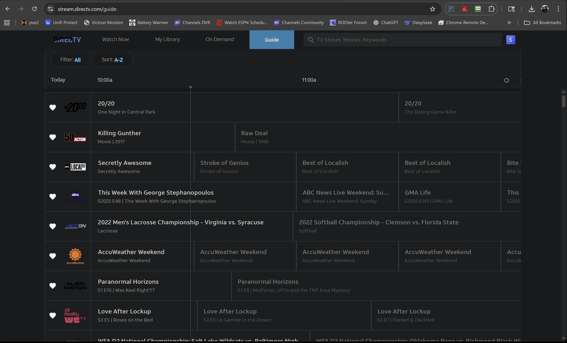

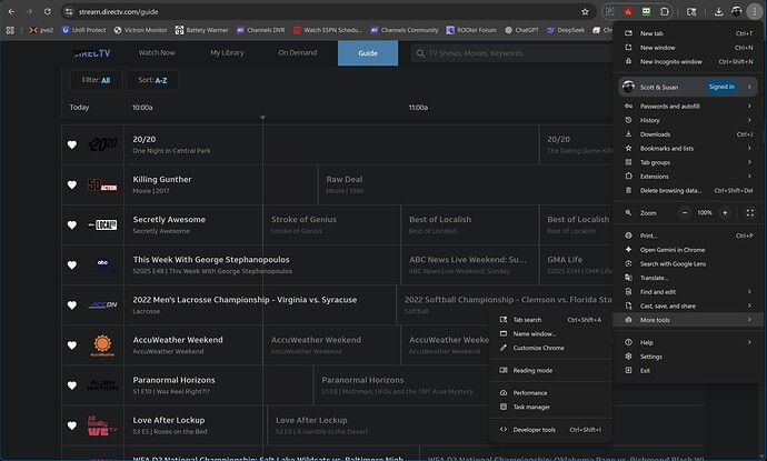

Navigate to https://stream.directv.com/guide in Chrome and login (if needed):

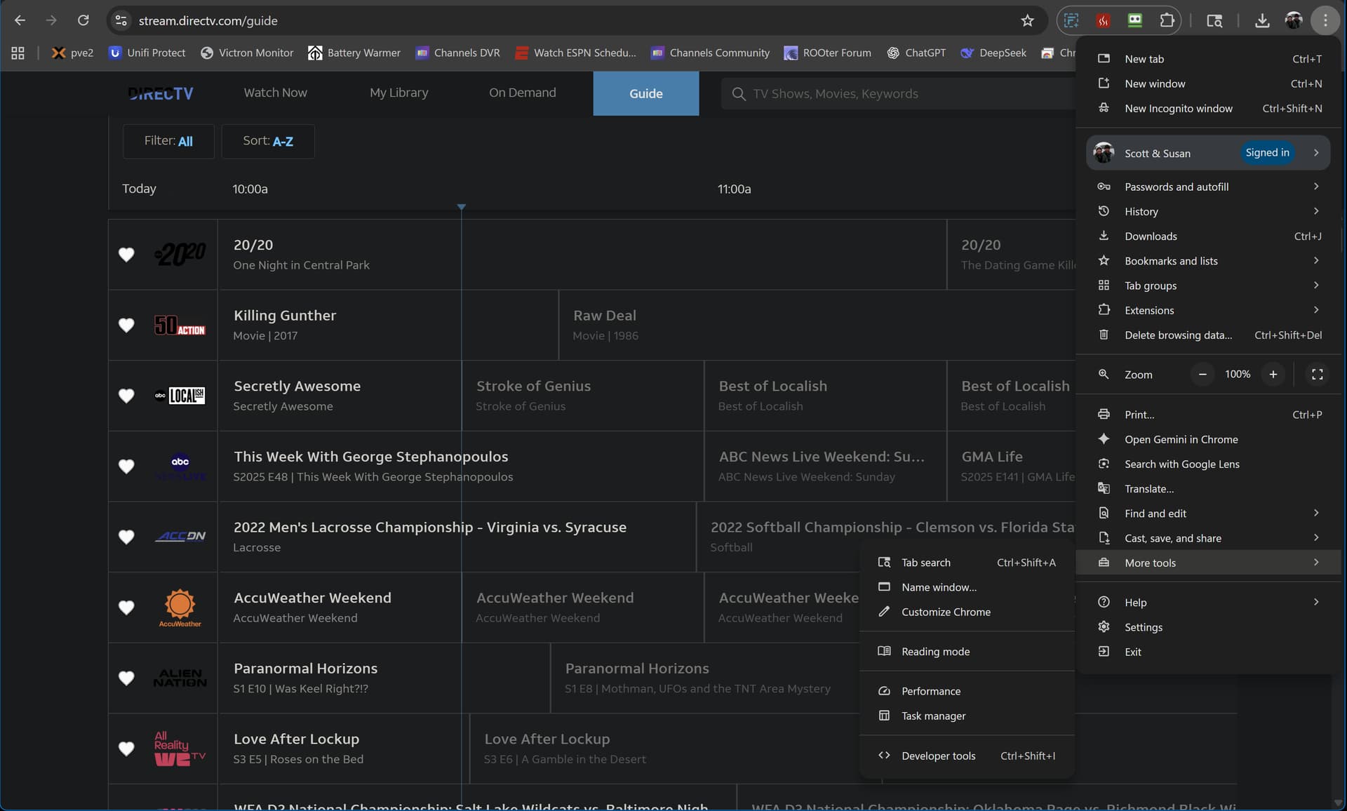

Next using the three stacked dots menu in the upper right of Chrome, select More tools - Developer tools:

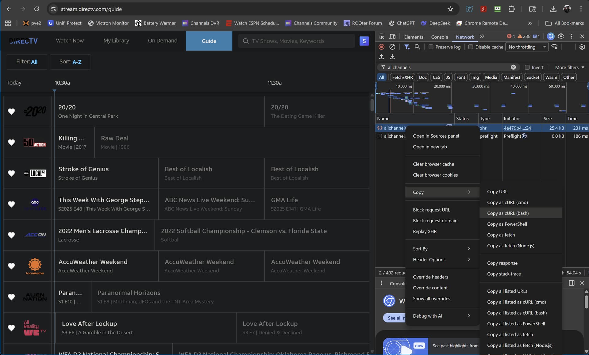

With the Developer tools window open and Network selected, search for allchannels. You may need to refresh the guide window to get it to popup. Right-click on that (most recent one on the bottom of the list with the orange icon) and select Copy, followed by Copy as cURL (Bash): :

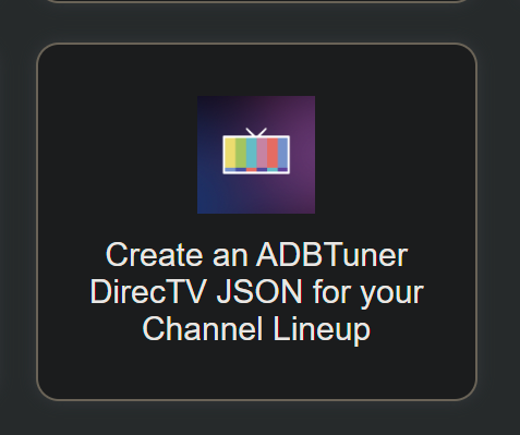

With that curl command in your clipboard, use the following OliveTin/Project One-Click Action:
screenshot-htpc6-2025_12_07-10_56_50

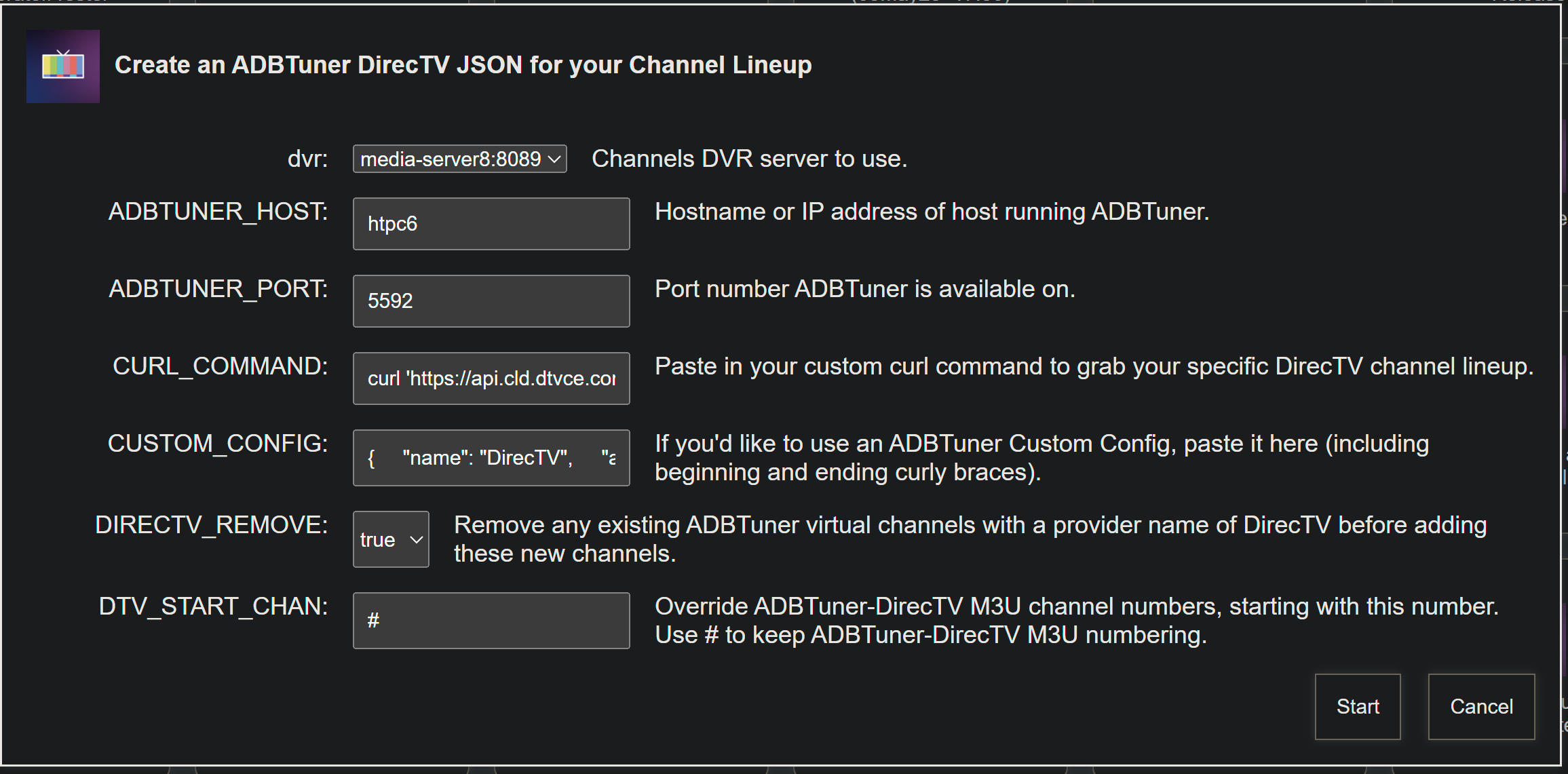

In that Action, you'll be copy-and-pasting your custom curl command, and also the ADBTuner Custom Configuration you'd like to use. Here's the one I'm currently recommending:
Complete the fields in the OliveTin Action, including the curl command and the custom config JSON:
The custom config you pasted in will be added to ADBTuner, and each channel created will be set to use that as it's tuning configuration.
Leaving DIRECTV_REMOVE set to true is generally a good idea, as that will delete any existing ADBTuner channels with a provider name of DirecTV.
Leaving the DTV_START_CHAN value set to # is also recommnded as then your DTV channels will use the same standard DTV channel numbers. Change it if those conflict with channel numbers already in use.

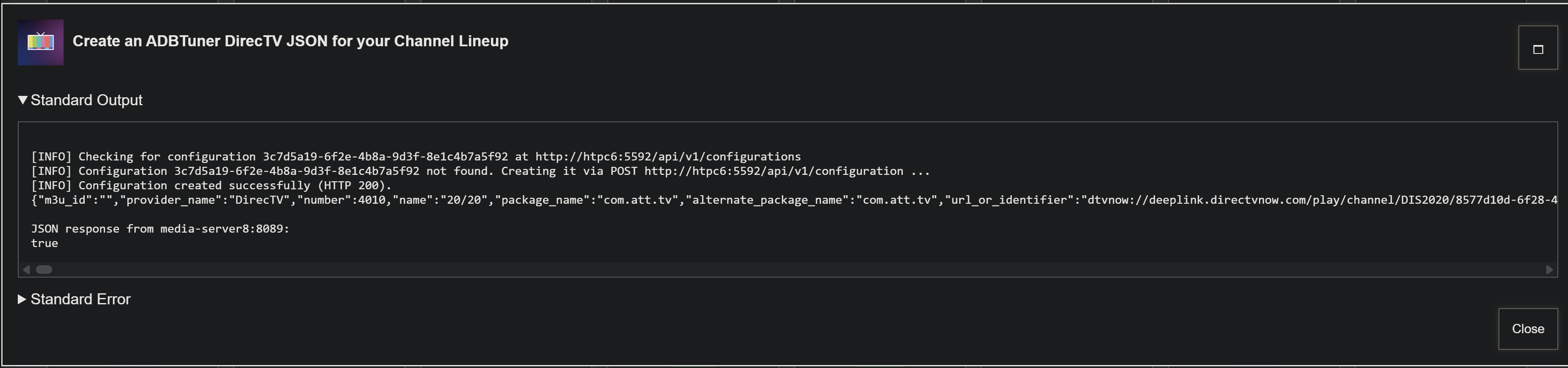

If everything goes according to plan, you should see OliveTin standard output like this:

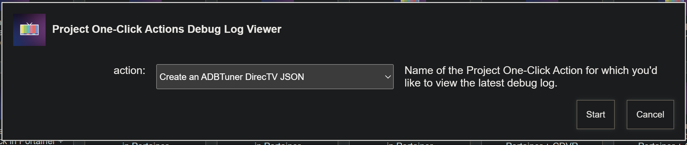

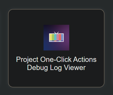

If you go to the Project One-Click Actions Debug Log Viewer, you can review the process step-by-step for the last run. Since you have the Ultimate package it'll be a pretty big log, so you might want to put it into a code editor and do some searches on it:
screenshot-htpc6-2025_12_08-07_01_31
This is the script that's run:
  adbtunerDirecTVJSONComplete=$(
  printf '%s\n' "$adbtunerDirecTVJSON" \
  | jq --argfile ref "$alternateGracenoteIDs" '
    map(
      if (.tvc_guide_stationid // "" | tostring) == "" then
        . as $c
        | ($ref[] | select(.number == $c.number) | .tvc_guide_stationid) as $sid
        | if $sid then .tvc_guide_stationid = $sid else . end
      else
      end
createDirecTVConfig() {
  local getURL="http://${adbtunerSource}/api/v1/configurations"
  local postURL="http://${adbtunerSource}/api/v1/configuration"
  echo "[INFO] Checking for configuration ${customConfigUUID} at ${getURL}"
  local allConfigs
  if ! allConfigs=$(curl -sS -X GET "${getURL}" -H 'accept: application/json'); then
    echo "[ERROR] Failed to fetch configurations from ${getURL}"
    return 1
  fi
  if echo "${allConfigs}" | jq -e --arg uuid "${customConfigUUID}" '
      (map(select(
        (.uuid == $uuid) or
        (.json_data.uuid == $uuid)
      )) | length) > 0
    ' >/dev/null 2>&1; then
    echo "[INFO] Configuration ${customConfigUUID} already exists. Nothing to do."
    return 0
  fi
  echo "[INFO] Configuration ${customConfigUUID} not found. Creating it via POST ${postURL} ..."
  local httpReturnCode
  httpReturnCode=$(curl -sS -o /tmp/directv_config_post_response.json -w '%{http_code}' \
    -X POST "${postURL}" \
    -H 'accept: application/json' \
    -H 'Content-Type: application/json' \
    -d "{\"json_data\": ${customConfig}}")
  if [[ "${httpReturnCode}" =~ ^2 ]]; then
    echo "[INFO] Configuration created successfully (HTTP ${httpReturnCode})."
  else
    echo "[ERROR] Failed to create configuration (HTTP ${httpReturnCode}). Response:"
    cat /tmp/directv_config_post_response.json
    echo
    return 1
  fi
createDirecTVChannels() {
  jq -c '.[]' \
  | while IFS= read -r channelJSON; do
      curl -fsS \
        -X POST "http://${adbtunerSource}/api/v1/channels" \
        -d "$channelJSON" \
        echo "POST FAILED for channel: $channelJSON" >&2
        return 1
    done
  echo "Created ADBTuner - DirecTV channels"
customChannels() {
cat <<EOF
  "name": "ADBTuner - DirecTV",
  "type": "MPEG-TS",
  "source": "URL",
  "url": "http://$adbtunerSource/channels.m3u8?provider=DirecTV",
  "text": "",
  "refresh": "24",
  "limit": "",
  "satip": "",
  "numbering": "$adbtIgnoreM3UNumbers",
  "start_number": "$adbtStartingChannel",
  "logos": "",
  "xmltv_url": "",
  "xmltv_refresh": "3600"
EOF
cdvrCustomSource() {
  customChannelsJSON=$(echo -n "$(customChannels)" | tr -d '\n')
  echo -e "\nJSON response from $dvr:" \
  && curl -s -X PUT -H "Content-Type: application/json" -d "$customChannelsJSON" http://$dvr/providers/m3u/sources/ADBTuner-DirecTV
main() {
  [[ $directvRemove ]] && deleteExistingDirecTV && echo
  createDirecTVJSON
  [[ $customConfigUUID ]] && createDirecTVConfig
  echo "$adbtunerDirecTVJSONComplete" | createDirecTVChannels
  cdvrCustomSource
main

So the other thing I noticed that was super weird was that it's only happening when I make a channel collection just for DirecTV. I'm also only seeing the duplicates on my Apple TV, not on my Pixel 9 Pro XL.
It's just a few channels, CBS 2, NBC 4, and Fox 5.
Since the debug output is so huge I just threw it on my website on a hidden page. I'm not sure if that has anything useful or if it's just a bug with my channels instance and I have to restore from a backup or something.
What are the Call Signs for the duplicated stations so I can do a search on them? The debug is 25K+ lines...
Lol I'm sorry!
I was seeing WBCS, WNYW, and WNBC.
I found that if I export then reimport and delete from ADB tuner after this, I get the correct 333 channels, not 345.
I assume you meant WCBS, plus the other two. Looking at the POST creating the channels in ADBTuner, each one is only posted once:
+ curl -fsS -X POST http://192.168.200.40:5592/api/v1/channels -H 'accept: application/json' -H 'Content-Type: application/json' -d '{"m3u_id":"","provider_name":"DirecTV","number":2,"name":"CBS-WCBS","package_name":"com.att.tv","alternate_package_name":"com.att.tv","url_or_identifier":"dtvnow://deeplink.directvnow.com/play/channel/WCBS/215692d2-9580-f630-3975-1e8caa1ae6f9","configuration_uuid":"3c7d5a19-6f2e-4b8a-9d3f-8e1c4b7a5f92","tvc_guide_stationid":"11331","guide_offset_hours":"","data":null,"id":0}'
+ IFS=
+ read -r channelJSON
+ curl -fsS -X POST http://192.168.200.40:5592/api/v1/channels -H 'accept: application/json' -H 'Content-Type: application/json' -d '{"m3u_id":"","provider_name":"DirecTV","number":4,"name":"NBC-WNBC","package_name":"com.att.tv","alternate_package_name":"com.att.tv","url_or_identifier":"dtvnow://deeplink.directvnow.com/play/channel/WNBC/6beef71a-4049-7cae-8048-91a8214f854a","configuration_uuid":"3c7d5a19-6f2e-4b8a-9d3f-8e1c4b7a5f92","tvc_guide_stationid":"11705","guide_offset_hours":"","data":null,"id":0}'
+ IFS=
+ curl -fsS -X POST http://192.168.200.40:5592/api/v1/channels -H 'accept: application/json' -H 'Content-Type: application/json' -d '{"m3u_id":"","provider_name":"DirecTV","number":5,"name":"FOX-WNYW","package_name":"com.att.tv","alternate_package_name":"com.att.tv","url_or_identifier":"dtvnow://deeplink.directvnow.com/play/channel/WNYW/71ef2762-858e-dca7-c17e-23619662e177","configuration_uuid":"3c7d5a19-6f2e-4b8a-9d3f-8e1c4b7a5f92","tvc_guide_stationid":"11746","guide_offset_hours":"","data":null,"id":0}'
Is it possible the Provider name for those three isn't DirecTV so those existing channels didn't get deleted before the new ones were added?
No they were all DirecTV. The strange thing was that after using the one-click action and then exporting from ADB tuner and re-importing the json then reloading the M3U in Channels I get the correct 333 channels that I created with Claude Code and the JSON response from DirecTV. Not 345 Channels.
