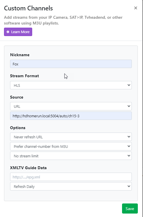

In the mean time, I discovered that if I enter (http://hdhomerun.local:5004/auto/ch15-3) into my VLC player, I get my local FOX station. Is there a way to add this as a custom channel in my Channels DVR setup? I've never tinkered with those settings so wanted to ask before I touched anything.
Yes you could add it as a custom channel using that URL in an m3u
So, not really knowing what I am doing, I attempted and here is what I entered:

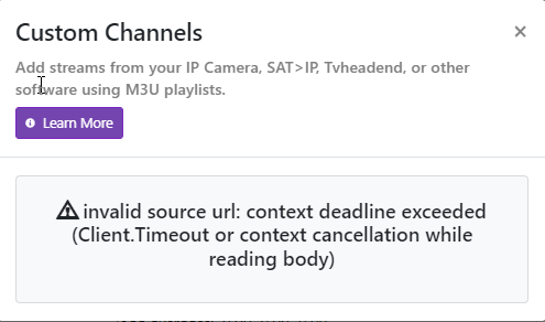

and here is the result:
format is mpegts
source type is text
#EXTM3U
#EXTINF:-1, channel-id="FOXDFW", FOX
