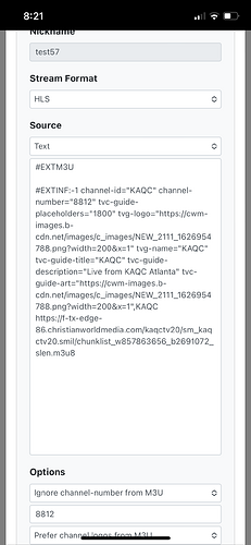

Use the text option not url. Here is a quick rough example copy pasta if you like.
#EXTM3U
#EXTINF:-1 channel-id="KAQC" channel-number="8812" tvc-guide-placeholders="1800" tvg-logo="https://cwm-images.b-cdn.net/images/c_images/NEW_2111_1626954788.png?width=200&x=1" tvg-name="KAQC" tvc-guide-title="KAQC" tvc-guide-description="Live from KAQC Atlanta" tvc-guide-art="https://cwm-images.b-cdn.net/images/c_images/NEW_2111_1626954788.png?width=200&x=1",KAQC
https://f-tx-edge-86.christianworldmedia.com/kaqctv20/sm_kaqctv20.smil/chunklist_w857863656_b2691072_slen.m3u8

Thank you sooooo much. I copied and pasted and it worked! I have used custom channels before by just adding m3u URL’s. This would be the first time using text. I need to read up and learn more about this…love it . Thank you.
