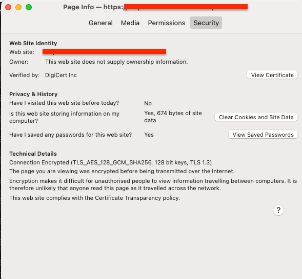

Im trying to add a custom channel using a HTTPs URL but im getting this error:
failed to load m3u: Get "https://EXAMPLE.EXAMPLE.me.uk/output/m3u/TV": tls: failed to verify certificate: x509: certificate signed by unknown authority
My certificate is valid as can be seen in my screenshot

And you're updating the root cert on the computer hosting your DVR, not the computer you're accessing the DVR server from, right?
Also, from the text of your post, it sounds like this is a site you control and it is your cert; if that is the case, try serving the full chain cert with all the intermediates, as that is a likely point of failure.
There was indeed an issue with my intermediates
