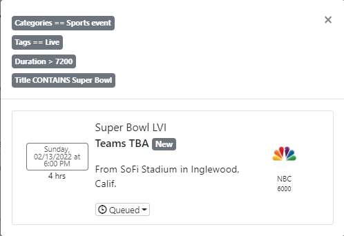

This year, it is going to be my first time recording the Super Bowl game with Channels DVR.
It is still more than 2 weeks away so it is not visible in the guide yet. That's fine because I want to create a generic advanced pass anyway to be able to record all Super Bowl games every year without having to modify the pass every time.
Do you already have an advanced pass for it?
Do you think this would work:
Title CONTAINS Super Bowl
Tags == Live
Categories == Sports event
Duration > 7200
Just curious what you think.

You're right, I have a little bit of time to play with it and modify it as needed. :slightly_smiling_face:
I will update my first post with what I believe are the settings for this advanced pass once I'm satisfied.

Good point about the padding at the end. I have added 90 minutes. :slightly_smiling_face:

So it seems to be working. :slight_smile:
cdvr_superbowl_pass_matches
cdvr_superbowl_pass_results
