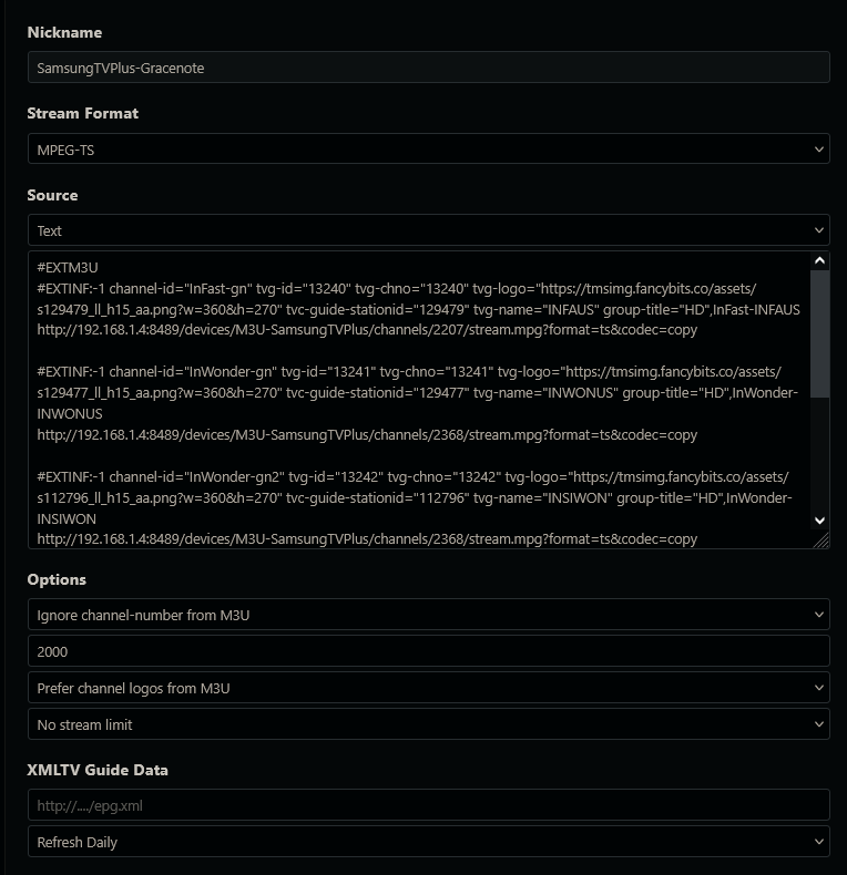

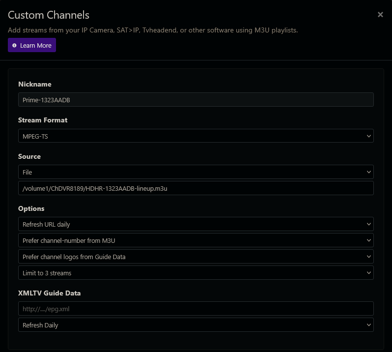

SERVER #1 has two sources: HDHomeRun PRIME and an M3U. Only the HDHR PRIME fetched guide data after the update
SERVER #1

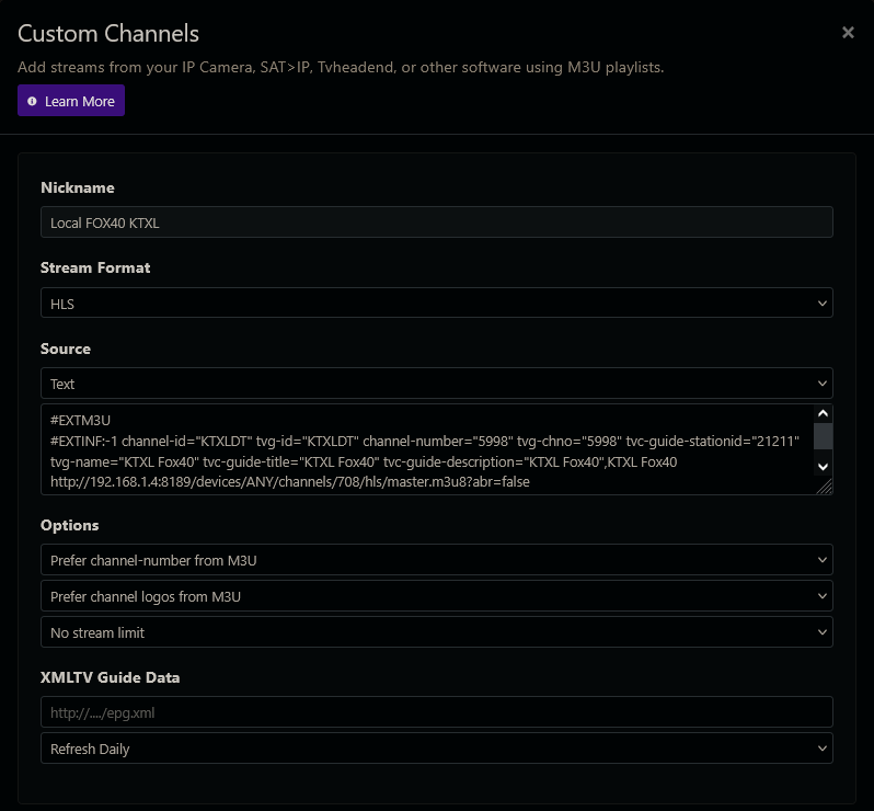

SERVER #2 has 3 sources: TVE-Xfinity, an M3U and a disabled HDHR Prime. Only TVE-Xfinity fetched guide data after the update
SERVER #2
  • what is the guide data source for each one?
See source setting images above
  • Are there some that are working?
Only the highest priority source on each server. Had to manually fetch guide data for the rest.
  • What have you done to fix it?

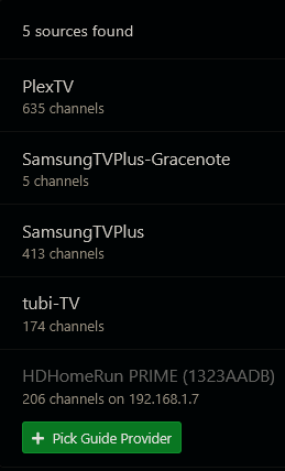

I have another server with 4 M3U sources and after updating to v2025.07.17.1738 ALL guide data is missing. Including one of the sources that uses stationid to get Gracenote guide data.
SERVER #3
