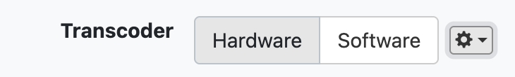

I have a Minisform N5 Pro running Proxmox 9 with a Debian 12 LXC container that now supports Hardware Transcode!
