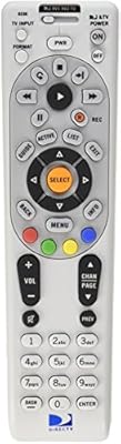

I need the FLIRC because I use a lot of keystrokes when watching SageTV and others. Plus I was able to use my old remotes from DirecTV. Some in my Household have a hard time with small remotes. The Shield remotes are just too simple.
I just ordered this one as an Nvidia Shield replacement. If it works as advertised, it could be the ultimate remote for the Shield.
That looks good... I might give it a try.
This is the one I use with my Flirc for those that have trouble with small remotes ... Also controls sounds system and TV. They are unbreakable.

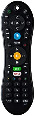

I'm trying to get my TiVo remote working, which is both Bluetooth & IR. The remote has a perfectly balanced feel, both for dedicated D-Pad and Play/Pause/FF/Rew hand positions. It's such a wonderful remote; all the functions you need, and perfectly ergonomic.
I can pair it via Bluetooth successfully and most buttons work (d-pad, OK, Channel Up/Down, Skip, Number keys; even toggling voice assistant (though there's no mic to pick up the command) but there is no home button-- and Button Remapper doesn't recognize the TiVo (home) button over Bluetooth. Apparently TiVo uses arbitrary remote commands, which is where the problem lies. The Button Mapper app doesn't recognize these keycodes either, so I can't use that.
FLIRC has a way to intercept these IR signals and translate them to keycodes.
So for now, if I want to use my TiVo remote, unfortunately it has to be over IR through FLIRC.

I contacted the developer of Button Mapper (an Android / Android TV app enabling the remapping of buttons) and he confirmed that TiVo is likely using proprietary commands, which can't be understood on the OS level:
...some buttons simply don't register with the Accessibility service. They are basically hard-coded and bypass the Android/Linux input subsystem.
So that basically confirmed that the FLIRC (IR) approach is necessary to use the TiVo remote, given the lack of standard keycodes for essential keys (like the "Home" button).
I've fully configured FLIRC to my liking, and though IR not quite as responsive as Bluetooth-- it's nice to have the remote I want, with functions fully customized to my liking. The fact the Channels app can intercept these keycodes enables a really nice TV experience.
