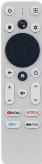

I am using Walmart Onn Streaming box.
It runs Android TV 10.
The remote does not have a dedicated Play/Pause button,
the button in the center of the navigation circle serves as Play/Pause and OK depending.
Dbl Click on that Play/Pause does not do Last Channel, nor does Dbl click on any other button do that.

Actually there is a play/pause button when watching a channel with Channels DVR on Android TV (specifically the Walmart Onn box in my case) The OK button in the center of the D-Pad.
And I think that assignment is up to app developers.
SO.... Developers... why not also code to look for the double click on the D-Pad OK button and do Last Channel???
PLEASE!!
I have looked into Button Mapper from Google Play store but most buttons are hard coded.
I tried doing Long Press assignment on the Change Input Button but did not see an assignment for Play-Pause or Double play-Pause.
I may try the Bookmark key but I expect there will not be the Play-Pause assignment or Double Play Pause assignment.
Has anyone tried that Button Mapper?

There is no Pause/Play button as such, its the center button on the D-Pad that works as Pause Play within Channels.
BUT in other apps is usually does not Pause Play, it's the OK button only.
No RED button on Onn box remote.

I don't see a "Live TV" button on the ONN box remote.!!
There is one that looks like that but it is for YoutubeTV.
Does button mapper let you map to F1?
I don't see an "F1" ???
I am going to try Button Mapper for the "Bookmark" button, Upper left on image, below Power button.
a simple "Play/Pause" assigned and I will try Double Clicking the Bookmark button and see what happens.
It should send a double click for Play/Pause, we'll see.
I think that Bookmark button is the only button that can be safely re-assigned.
All the APP buttons including the "tv" button are "hard coded" and cannot be reassigned with Button Mapper.

I tried Button Mapper as described above, Remap Bookmark button to Play/Pause.
Selected two different channels then tried to do Previous channel with Double tap on Bookmark button.
Does not work, it does nothing, keeps playing.
Single tap on Bookmark button does the same thing as center D-pad button, one tap-Pauses, tap again,Plays.
It does not seem to be able to take in a quick double tap on Bookmark and treat it as "Previous channel".
But Button Mapper did make Bookmark a Pause/Play which may be useful on other apps which do not recognize center D-pad as a Play/Pause...
This does work, it seems to take a blink before the pause like some kind of delay, maybe this is why Double tap does not work.
