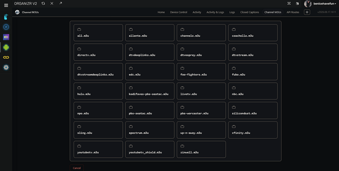

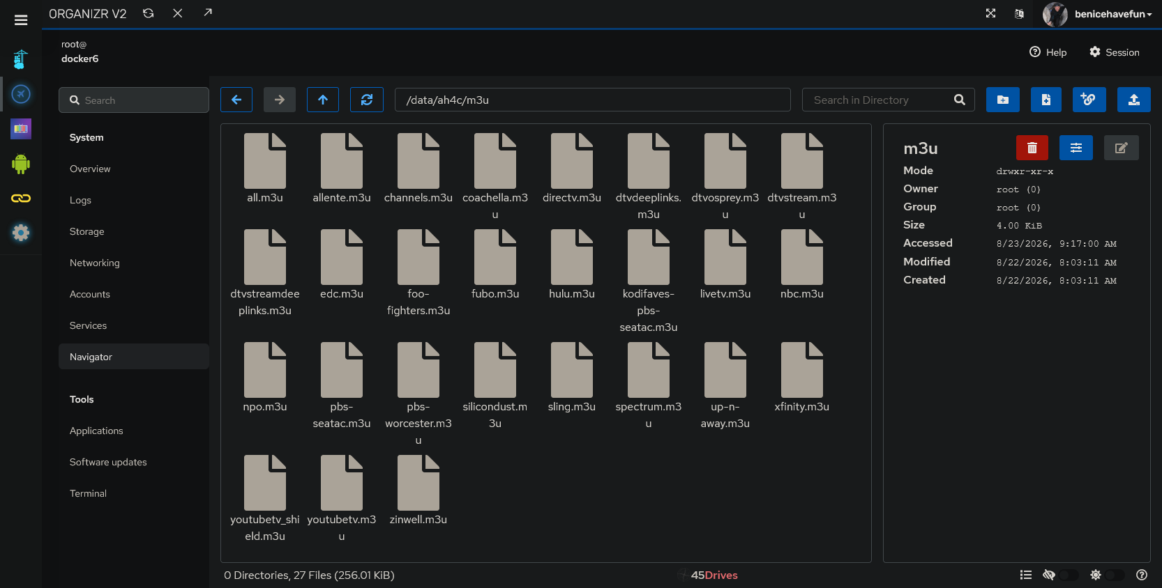

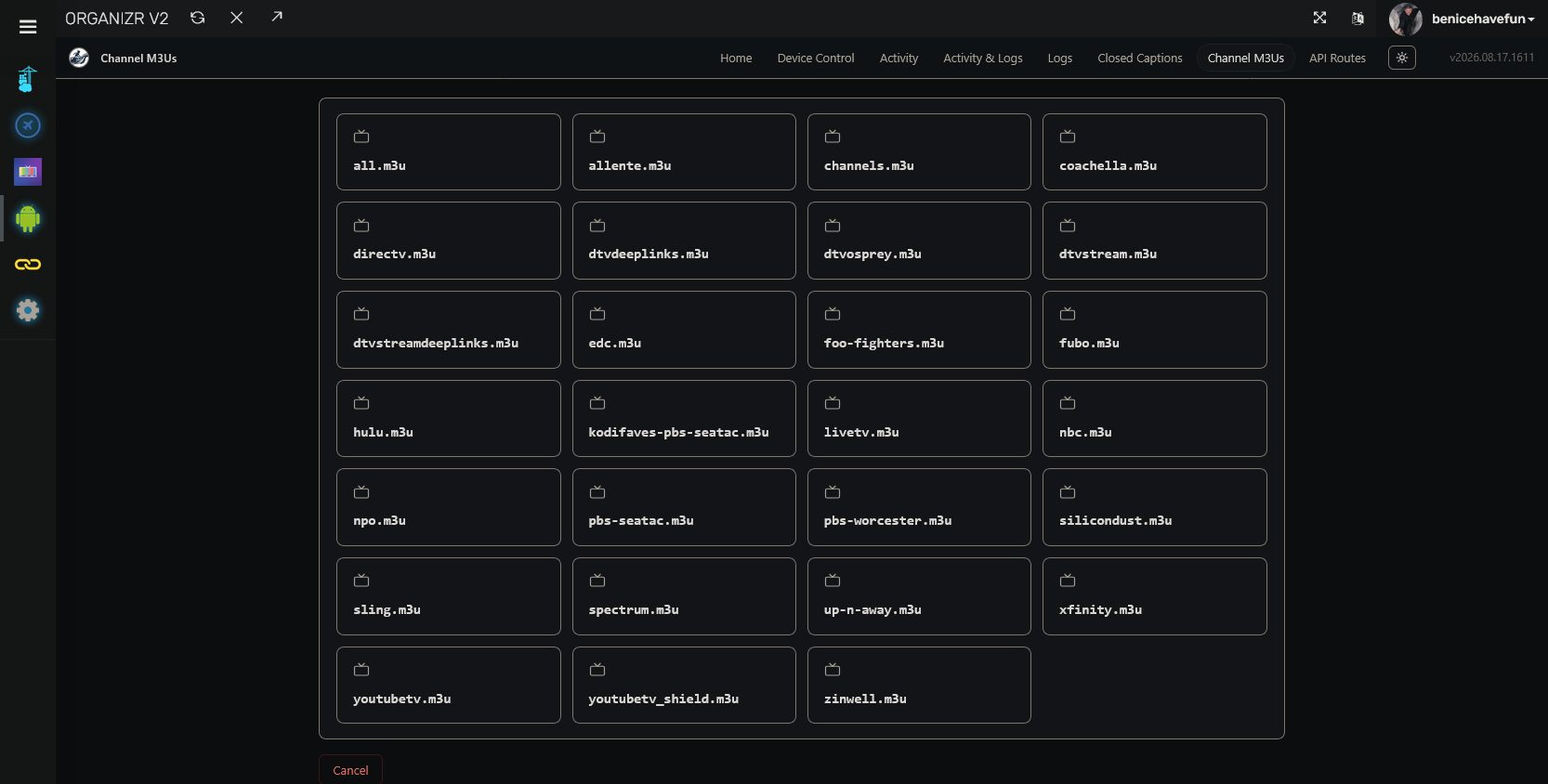

which leads us to the GUI not having a way to create or import a m3u, you can only edit the ones provided.
maybe you could/should include mine

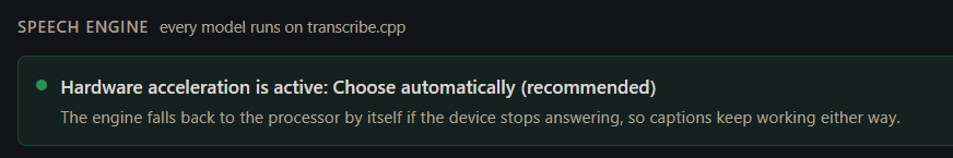

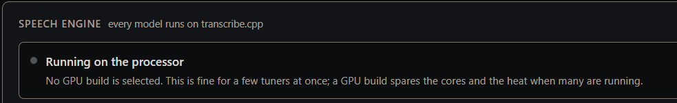

As you probably know, Docker Desktop for Windows does not support hardware acceleration via an iGPU for any container.
A reasonable suggestion to support M3U import. However, any custom M3Us that you have in the correct folder, should show-up and can be edited.
One of mine is called up-and-away:

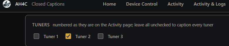

any way we could tackle isolating or prioritizing channels to certain tuners for CC?
that's why I included a small AI model. this isn't an edge case, one shouldn't do local AI on a potato with a lot of tuners. what model are you using?
