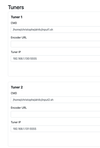

Anyway, each tuner is called in ah4c with a script that looks like this:
Input1.sh
#!/bin/bash
sleep 15 && bash -c "magewell2ts -i 1 -s 100 -q 12 -c h264_qsv -m "
What I am trying to figure out is a way to vary the number of seconds to delay for each tuner based upon the source being tuned. What you see here is a default 15 seconds based on the amount of time it takes for the hbo max app to tune and get to video. Directv take around 8 or so and YoutubeTV takes less.
Keeping the default at 15 seconds therefore works for all of them, but I would still like to be able to vary things if possible.
I need a bit more detail on this. How and where is this script called?
The tuning script is called for each of the four tuners on the card this way:
If I send the tuning command from bmitune.sh and leave the CMD field empty would that mess how ah4c is able to switch from one tuner to the next?

Apologies, but I don't recognize this UI. Where is this from?
But I get the idea -- these are the CMD1, CMD2 environment variables. Let me ponder this briefly, and I'll get back to you.
