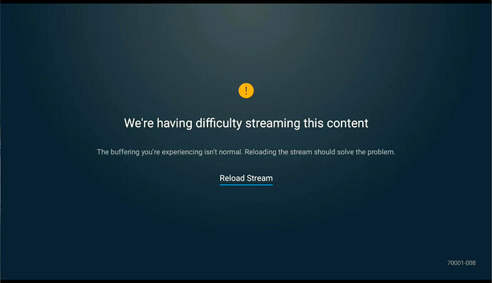

anyway a new one popped up this week.
high winds affected the cable lines to my neighborhood creating an unstable connection for a while so I ended up with this screen for a couple hours of recordings.
once it hits this screen the osprey does not try to reload on it's own, you must hit select with the remote (or enter with keyboard)
any way to detect this screen and hit enter or re-tune? or is that only a adbtuner thing?
Both ah4c and ADBTuner have mechanisms for capturing screenshots and doing OCR on them. Usually this is done at the beginning of the virtual tune, is that when this screen would show up?
I no longer have the recordings as I record msnow all day, and only keep the last 5.
it showed up during the middle of an hour, but persisted until I finally caught it a few hours later.
since the recordings are all on the same channel it never re-tuned.
I re-created by turning the QOS to that osprey down to 1 or 2 Mbps and got the no internet screen a few times which it recovered from, but after a couple times it goes to this screen.
Monitoring for something like that could done, but you'd need some reasonable parameters for it. Lots of screen captures with associated OCR could be a little heavy if done too frequently. What would you have in mind?
I think even if it just still did the normal checks at the start of a recording even though it's not changing the channel would at least limit the bad recordings to just the one.
although I could see usefulness for a check every 30min or 1hr in the case of longer recordings such as sports. you may miss some, but not all. sorta thing.

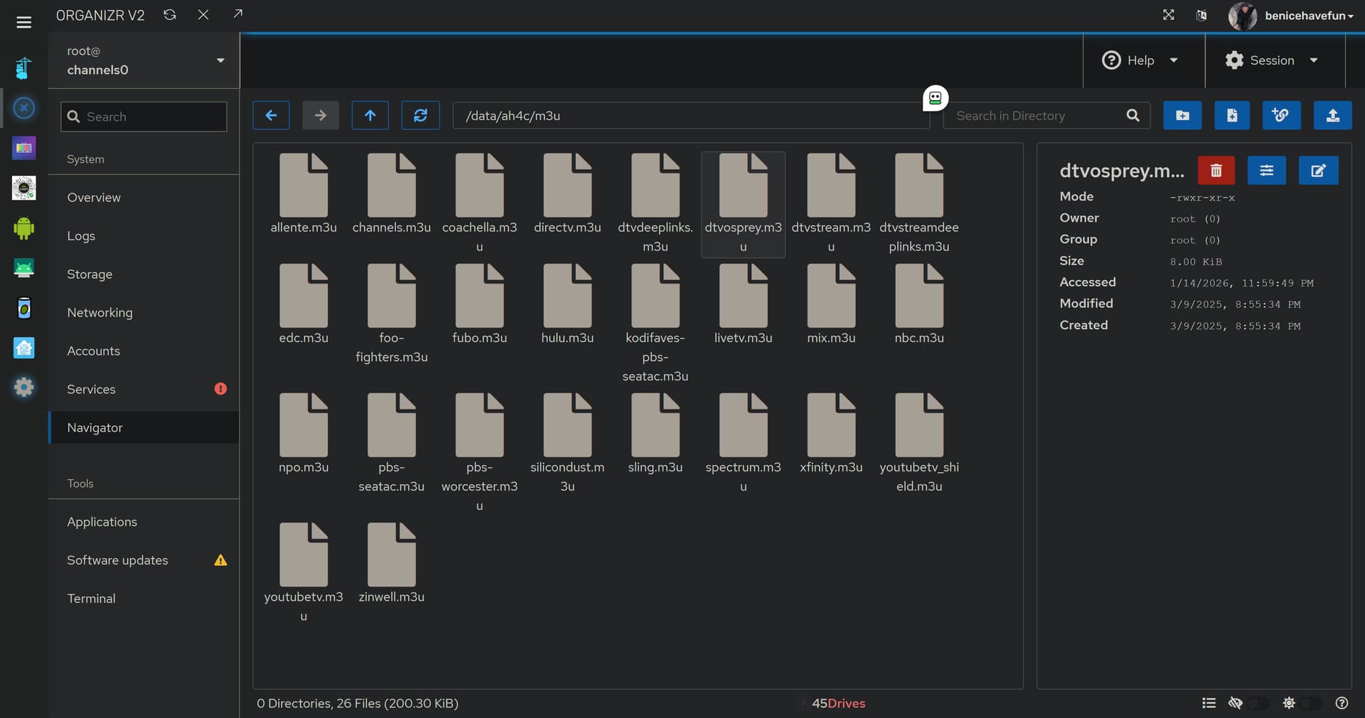

@bnhf previously when I only had ah4c in my stack I was able to customize the m3u. (older verision I know) now that I have it installed via olivetin/one-click It seems I'm no longer able to change the file, only via the web interface but don't see what file that change is reflected. also doing this 1 at a time on the web interface is painful. :tired_face:
I did set up a adbtuner stack in prep for another linkpi and used the dtv guide pull you built. any way we can use that with ah4c too? any way to backup just the channel list with disable & favorites so when I mess something up too bad and want to start over I can just import my preferred listings
You can still edit the file directly. It's stored under ah4c/m3u/, apend your parent data directory to the front and the M3U name you used to the end. Here's mine (though you probably won't have so many options):
If you export the JSON from ADBTuner, you should be able to use jq to create an M3U you can use in ah4c. An AI "helper can guide you through it.
that's where I've been trying to edit/replace the dtvosprey.m3u.
cdvr source m3u as set by one-click is http://10.0.0.7:7654/m3u/dtvosprey.m3u
if i use a different name it can't find the file.
I'm thinking I'm hitting a volume mount issue or something. I'm still very green with linux especially when mixed with windows... and docker..
