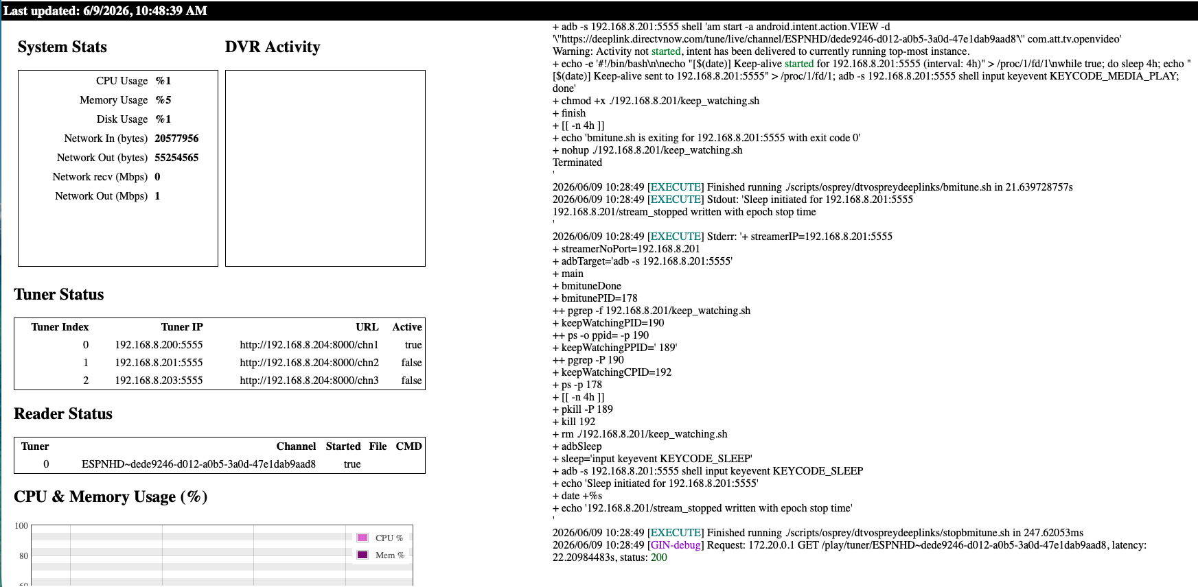

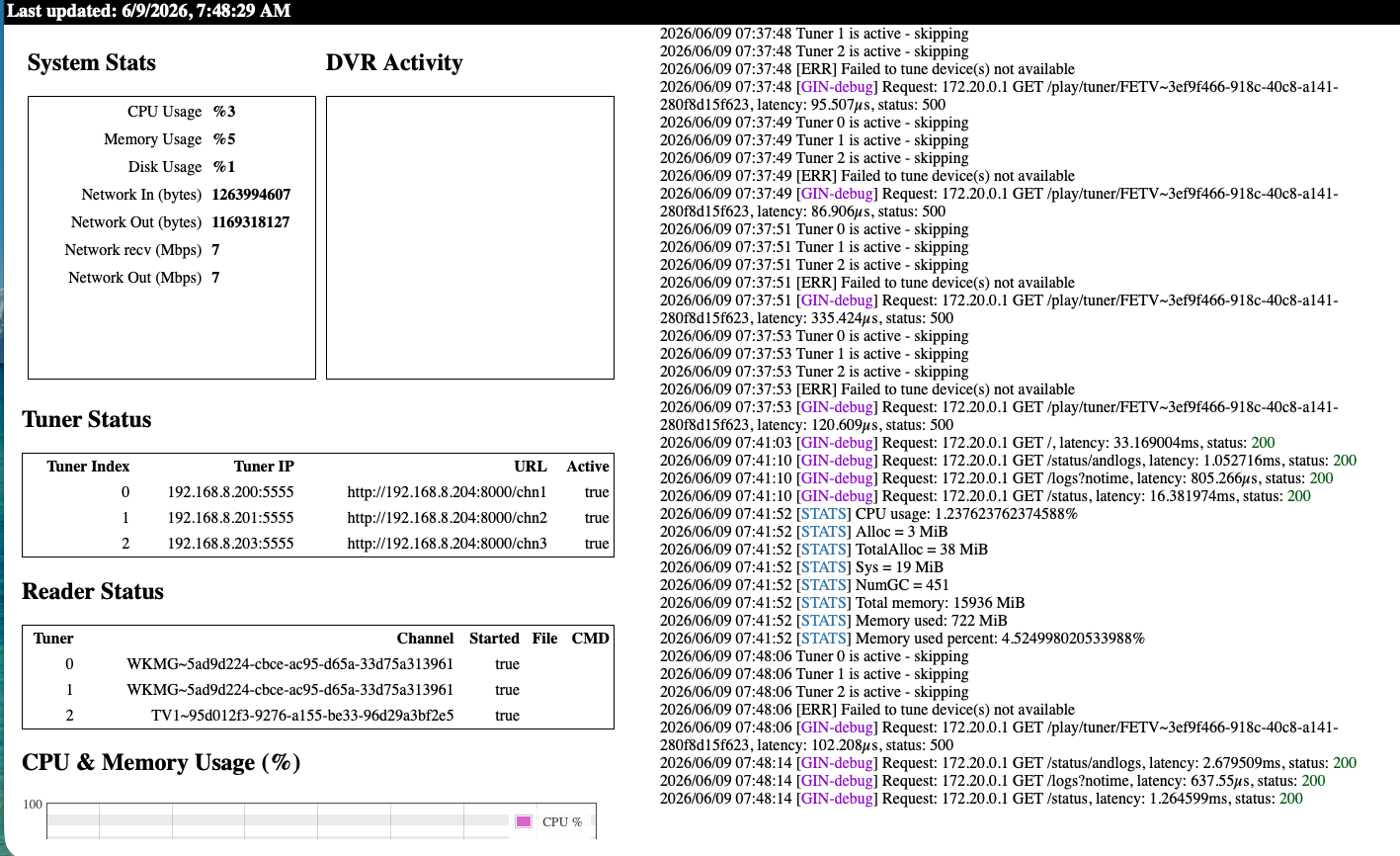

I'm seeing an issue where ah4c thinks tuners are still in use after channelsdvr releases them. Right now, only one tuner is being used, but ah4c believes all 3 are in use, resulting in tuning requests failing. The 2 that should be idle were released over an hour ago.
Let's start by taking a look a one complete tuning cycle for a single channel. This data is best grabbed from Portainer-Logs (change the number of lines to 10000 and turn off Auto-refresh to grab them). Here's an example of such a cycle from one of my setups:
[EXECUTE] Stderr: '+ dvr=utheater-pc:8089
+ channelNameID=KSTPD-8713109229817176105
++ awk -F- '{print $2}'
++ echo KSTPD-8713109229817176105
+ channelID=8713109229817176105
++ awk -F- '{print $1}'
+ channelName=KSTPD
+ specialID=KSTPD
+ streamerIP=192.168.1.93:5555
+ streamerNoPort=192.168.1.93
+ adbTarget='adb -s 192.168.1.93:5555'
+ packageName=com.xfinity.cloudtvr.tenfoot
+ packageAction=com.xfinity.common.view.LaunchActivity
+ m3uName=xfinity.m3u
++ grep -B1 /play/tuner/KSTPD-8713109229817176105 /opt/m3u/xfinity.m3u
++ awk -F 'channel-id="' 'NF>1 {split($2, a, "\""); print a[1]}'
+ m3uChannelID=1005
++ curl -s http://utheater-pc:8089/api/v1/channels
++ jq -r '.[] | select(.id == "1005") | .number'
+ channelNumber=1005
+ [[ false == '' ]]
+ speedMode=false
+ read -a autoCropChannels
+ trap finish EXIT
+ main
+ updateReferenceFiles
+ mkdir -p 192.168.1.93
+ [[ -f 192.168.1.93/stream_stopped ]]
+ [[ -f 192.168.1.93/last_channel ]]
+ echo 3716
+ echo 'Current PID for this script is 3716'
+ matchEncoderURL
+ case "$streamerIP" in
+ encoderURL=http://192.168.1.52:8090/stream0
+ encoderStreamNumber=stream0
+ encoderIP=192.168.1.52:8090/stream0
+ specialChannels
+ '[' KSTPD = exit ']'
+ '[' KSTPD = reboot ']'
+ [[ -f 192.168.1.93/adbCommunicationFail ]]
+ echo 'Not a special channel (exit nor reboot)'
+ tuneChannel
+ adb -s 192.168.1.93:5555 shell am start -n com.xfinity.cloudtvr.tenfoot/com.xfinity.common.view.LaunchActivity https://www.xfinity.com/stream/live/KSTPD/8713109229817176105/KSTPD
+ echo -e '#!/bin/bash\n\nwhile true; do sleep 4h; adb -s 192.168.1.93:5555 shell input keyevent KEYCODE_DPAD_DOWN; done'
+ chmod +x ./192.168.1.93/keep_watching.sh
+ [[ -n 4h ]]
+ nohup ./192.168.1.93/keep_watching.sh
+ printf '%s\n' 1810 1812 1841 1842 1846 1848 1852 1862
+ grep -qx 1005
+ finish
+ echo 'bmitune.sh is exiting for 192.168.1.93:5555 with exit code 0'
Terminated
[EXECUTE] Finished running ./scripts/firetv/xfinity/bmitune.sh in 3h18m12.817639882s
[EXECUTE] Stdout: 'Streaming stopped for 192.168.1.93:5555
Sleep initiated for 192.168.1.93:5555
192.168.1.93/stream_stopped written with epoch stop time
+ m3uChannelID=1005
+ [[ false == '' ]]
+ speedMode=false
+ grep -qx 1005
+ main
+ [[ -n croppedChannel ]]
+ matchEncoderURL
+ bmituneDone
+ bmitunePID=3716
++ pgrep -f 192.168.1.93/keep_watching.sh
+ keepWatchingPID=3737
++ pgrep -P 3737
+ keepWatchingCPID=3738
+ [[ -n '' ]]
+ ps -p 3716
+ [[ -n 4h ]]
+ kill 3737 3738
+ rm ./192.168.1.93/keep_watching.sh
+ [[ -n '' ]]

I think there are a couple tuning actions here, but I think it also may catch the problem, as I now show 2 tuners in use for COZI when in fact, none are actually being used by ChannelsDVR.

[GIN-debug] Request: 172.20.0.1 GET /play/tuner/WKMG~5ad9d224-cbce-ac95-d65a-33d75a313961, latency: 7.970209818s, status: 200
Attempting network tune for device http://192.168.8.204:8000/chn1 192.168.8.200:5555 COZI~9fd00aad-1cc7-cf23-ba3e-bae853bd6165

[GIN-debug] Request: 172.20.0.1 GET /m3u/dtv407deeplinks.m3u, latency: 34.776194ms, status: 200
Tuner 0 is active - skipping
Attempting network tune for device http://192.168.8.204:8000/chn2 192.168.8.201:5555 COZI~9fd00aad-1cc7-cf23-ba3e-bae853bd6165

The first tuning action looks normal to me, but the second one you included is not complete. So let's try this:
  • Restart the ah4c container
  • Tune to one, and only one channel
  • Stop streaming that channel
  • Post the entire log from container start to streaming stop
[START] ah4c is ready
[GIN-debug] Listening and serving HTTP on :7654
> [email protected] start
> node ./index.js
Listening on:
	http://ah4c1:8000/ http://localhost:8000/
	http://127.0.0.1:8000/ http://172.20.0.2:8000/
	http://[::1]:8000/
Attempting network tune for device http://192.168.8.204:8000/chn1 192.168.8.200:5555 ESPNHD~dede9246-d012-a0b5-3a0d-47e1dab9aad8
[EXECUTE] Running [./scripts/osprey/dtvospreydeeplinks/prebmitune.sh 192.168.8.200:5555 ESPNHD~dede9246-d012-a0b5-3a0d-47e1dab9aad8]
[EXECUTE] Stdout: 'already connected to 192.168.8.200:5555
Waking 192.168.8.200:5555
prebmitune.sh is exiting for 192.168.8.200:5555 with exit code 0
[EXECUTE] Stderr: '+ streamerIP=192.168.8.200:5555
+ streamerNoPort=192.168.8.200
+ adbTarget='adb -s 192.168.8.200:5555'
+ mkdir -p 192.168.8.200
+ trap finish EXIT
+ main
+ adbConnect
+ adb connect 192.168.8.200:5555
+ local -i adbMaxRetries=3
+ local -i adbCounter=0
+ true
+ adb -s 192.168.8.200:5555 shell input keyevent KEYCODE_WAKEUP
+ local adbEventSuccess=0
+ [[ 0 -eq 0 ]]
+ break
e
+ echo 'Waking 192.168.8.200:5555'
+ touch 192.168.8.200/adbAppRunning
+ finish
+ echo 'prebmitune.sh is exiting for 192.168.8.200:5555 with exit code 0'
[EXECUTE] Finished running ./scripts/osprey/dtvospreydeeplinks/prebmitune.sh in 446.704291ms
[EXECUTE] Running [./scripts/osprey/dtvospreydeeplinks/bmitune.sh ESPNHD~dede9246-d012-a0b5-3a0d-47e1dab9aad8 192.168.8.200:5555]
[Tue Jun  9 10:26:27 EDT 2026] Keep-alive started for 192.168.8.200:5555 (interval: 4h)
Attempting network tune for device http://192.168.8.204:8000/chn2 192.168.8.201:5555 ESPNHD~dede9246-d012-a0b5-3a0d-47e1dab9aad8
[EXECUTE] Running [./scripts/osprey/dtvospreydeeplinks/prebmitune.sh 192.168.8.201:5555 ESPNHD~dede9246-d012-a0b5-3a0d-47e1dab9aad8]
[EXECUTE] Stdout: 'already connected to 192.168.8.201:5555
Waking 192.168.8.201:5555
prebmitune.sh is exiting for 192.168.8.201:5555 with exit code 0
[EXECUTE] Stderr: '+ streamerIP=192.168.8.201:5555
+ streamerNoPort=192.168.8.201
+ adbTarget='adb -s 192.168.8.201:5555'
+ mkdir -p 192.168.8.201
+ trap finish EXIT
+ main
+ adbConnect
+ adb connect 192.168.8.201:5555
+ true
+ adb -s 192.168.8.201:5555 shell input keyevent KEYCODE_WAKEUP
+ [[ 0 -eq 0 ]]
+ break
e
+ echo 'Waking 192.168.8.201:5555'
+ touch 192.168.8.201/adbAppRunning
+ finish
+ echo 'prebmitune.sh is exiting for 192.168.8.201:5555 with exit code 0'
[EXECUTE] Finished running ./scripts/osprey/dtvospreydeeplinks/prebmitune.sh in 382.810105ms
[EXECUTE] Running [./scripts/osprey/dtvospreydeeplinks/bmitune.sh ESPNHD~dede9246-d012-a0b5-3a0d-47e1dab9aad8 192.168.8.201:5555]
[Tue Jun  9 10:28:27 EDT 2026] Keep-alive started for 192.168.8.201:5555 (interval: 4h)
[IO] io.Copy: write tcp 172.20.0.2:7654->172.20.0.1:34626: write: broken pipe
[IOINFO] Successfully copied 17337296 bytes
[IOINFO] Transfer speed: 6.444878585537081 Mbits/second
Performing Close() for 192.168.8.201:5555
[EXECUTE] Running [./scripts/osprey/dtvospreydeeplinks/stopbmitune.sh 192.168.8.201:5555 ESPNHD~dede9246-d012-a0b5-3a0d-47e1dab9aad8]
[EXECUTE] Stdout: 'Starting: Intent { act=android.intent.action.VIEW dat=https://deeplink.directvnow.com/... pkg=com.att.tv.openvideo }
[EXECUTE] Stderr: '++ echo ESPNHD~dede9246-d012-a0b5-3a0d-47e1dab9aad8
++ awk -F~ '{print $2}'
+ channelID=dede9246-d012-a0b5-3a0d-47e1dab9aad8
++ awk -F~ '{print $1}'
+ channelName=ESPNHD
+ specialID=ESPNHD
+ [[ false == '' ]]
+ speedMode=false
+ echo 178
+ trap finish EXIT
+ main
+ tuneChannel
+ adb -s 192.168.8.201:5555 shell 'am start -a android.intent.action.VIEW -d '\''https://deeplink.directvnow.com/tune/live/channel/ESPNHD/dede9246-d012-a0b5-3a0d-47e1dab9aad8'\'' com.att.tv.openvideo'
Warning: Activity not started, intent has been delivered to currently running top-most instance.
+ echo -e '#!/bin/bash\n\necho "[$(date)] Keep-alive started for 192.168.8.201:5555 (interval: 4h)" > /proc/1/fd/1\nwhile true; do sleep 4h; echo "[$(date)] Keep-alive sent to 192.168.8.201:5555" > /proc/1/fd/1; adb -s 192.168.8.201:5555 shell input keyevent KEYCODE_MEDIA_PLAY; done'
+ chmod +x ./192.168.8.201/keep_watching.sh
+ finish
+ [[ -n 4h ]]
+ echo 'bmitune.sh is exiting for 192.168.8.201:5555 with exit code 0'
+ nohup ./192.168.8.201/keep_watching.sh
Terminated
[EXECUTE] Finished running ./scripts/osprey/dtvospreydeeplinks/bmitune.sh in 21.639728757s
[EXECUTE] Stdout: 'Sleep initiated for 192.168.8.201:5555
192.168.8.201/stream_stopped written with epoch stop time
+ main
+ bmituneDone
+ bmitunePID=178
++ pgrep -f 192.168.8.201/keep_watching.sh
+ keepWatchingPID=190
++ ps -o ppid= -p 190
+ keepWatchingPPID='  189'
++ pgrep -P 190
+ keepWatchingCPID=192
+ ps -p 178
+ [[ -n 4h ]]
+ pkill -P 189
+ kill 192
+ rm ./192.168.8.201/keep_watching.sh
+ adbSleep
+ sleep='input keyevent KEYCODE_SLEEP'
+ adb -s 192.168.8.201:5555 shell input keyevent KEYCODE_SLEEP
+ echo 'Sleep initiated for 192.168.8.201:5555'
+ date +%s
+ echo '192.168.8.201/stream_stopped written with epoch stop time'
[EXECUTE] Finished running ./scripts/osprey/dtvospreydeeplinks/stopbmitune.sh in 247.62053ms
[GIN-debug] Request: 172.20.0.1 GET /play/tuner/ESPNHD~dede9246-d012-a0b5-3a0d-47e1dab9aad8, latency: 22.20984483s, status: 200
Here is what I got after restarting the container and tuning to ESPN. This tuning attempt took exceptionally long and based on the ah4c status, it used 2 tuners leaving one showing in use. This is what I suspect is happening, as some tuning attempts are quick and others take a minute.
The status over 15 min later still showing the first tuner in use. When the channel was playing on my phone, the first 2 tuners both showed ESPN. This tuning was after a restart of the container, when no tuners were in use.
I see that second tune happening, which I can't explain yet -- that's something I've never seen before.
However, I do want to see the entire log from container start, and yours is missing everything from before the container is ready. I'm looking for this part too:

Got it, here is the full thing again with the added part a the top:
[EXECUTE] Finished running ./scripts/osprey/dtvospreydeeplinks/stopbmitune.sh in 138.851893ms
[GIN-debug] Request: 172.20.0.1 GET /play/tuner/WKMG~5ad9d224-cbce-ac95-d65a-33d75a313961, latency: 24.54545738s, status: 200
+ trap finish EXIT
+ main
+ adbConnect
+ true
+ [[ 0 -eq 0 ]]
+ break
e
+ finish
+ trap finish EXIT
+ main
+ adbConnect
+ true
+ [[ 0 -eq 0 ]]
+ break
e
+ finish
+ specialID=ESPNHD
+ [[ false == '' ]]
+ speedMode=false
+ echo 178
+ trap finish EXIT
+ main
+ tuneChannel
+ finish
+ [[ -n 4h ]]
Terminated
+ main
+ bmituneDone
+ bmitunePID=178
++ pgrep -P 190
+ ps -p 178
+ [[ -n 4h ]]
+ pkill -P 189
+ kill 192
+ adbSleep
+ date +%s

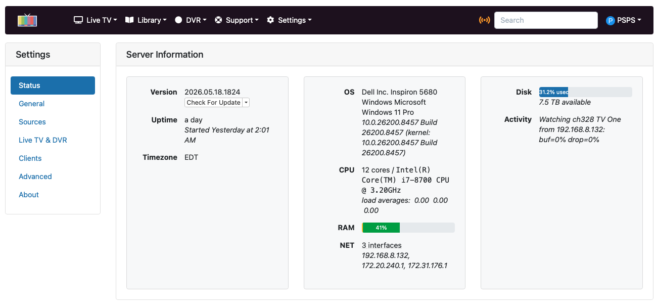

@anon38303228 I was wondering if you could take a look at this? Since this code has been stable, for a number of years, before recent changes -- I'm a bit suspicious of this new issue reported by @PSPS. As you can see in the attached log, prebmitune.sh just gets finished and another tuning cycle is started.
@PSPS Could you post the corresponding tuning cycle for this channel from the CDVR logs? I just want to be sure CDVR isn't initiating this second tune. Also, when you get a moment, could you stop the ah4c stack and change the value of TAG in the env vars section of the Portainer-Stacks Editor to 2026.04.06, and let's see if this same problem exists.
This is in the CDVR log:
2026/06/09 10:26:27.076729 [TNR] Opened connection to M3U-ah4c1-dtv407deeplinks for ch206 ESPN
2026/06/09 10:28:27.078747 [TNR] Closing connection M3U-ah4c1-dtv407deeplinks ch206 after no data was received for 2m0s
2026/06/09 10:28:27.078747 [TNR] Closed connection to M3U-ah4c1-dtv407deeplinks for ch206 ESPN
2026/06/09 10:28:27.079322 [SNR] Buffer statistics for 192.168.8.132 (192.168.8.132) for ch206 ESPN: buf=0% drop=0%
2026/06/09 10:28:27.535096 [TNR] Opened connection to M3U-ah4c1-dtv407deeplinks for ch206 ESPN
2026/06/09 10:28:48.993318 [SNR] Buffer statistics for 192.168.8.132 (192.168.8.132) for ch206 ESPN: buf=0% drop=0%
2026/06/09 10:28:48.993318 [TNR] Closed connection to M3U-ah4c1-dtv407deeplinks for ch206 ESPN
Also, I did not see a TAG entry in the env variables - I added it with the value specified and will try to recreate the behavior.
I have 3 osprey devices attached. Two are the newer dongle style and 1 is the older box style with the ethernet connection.
