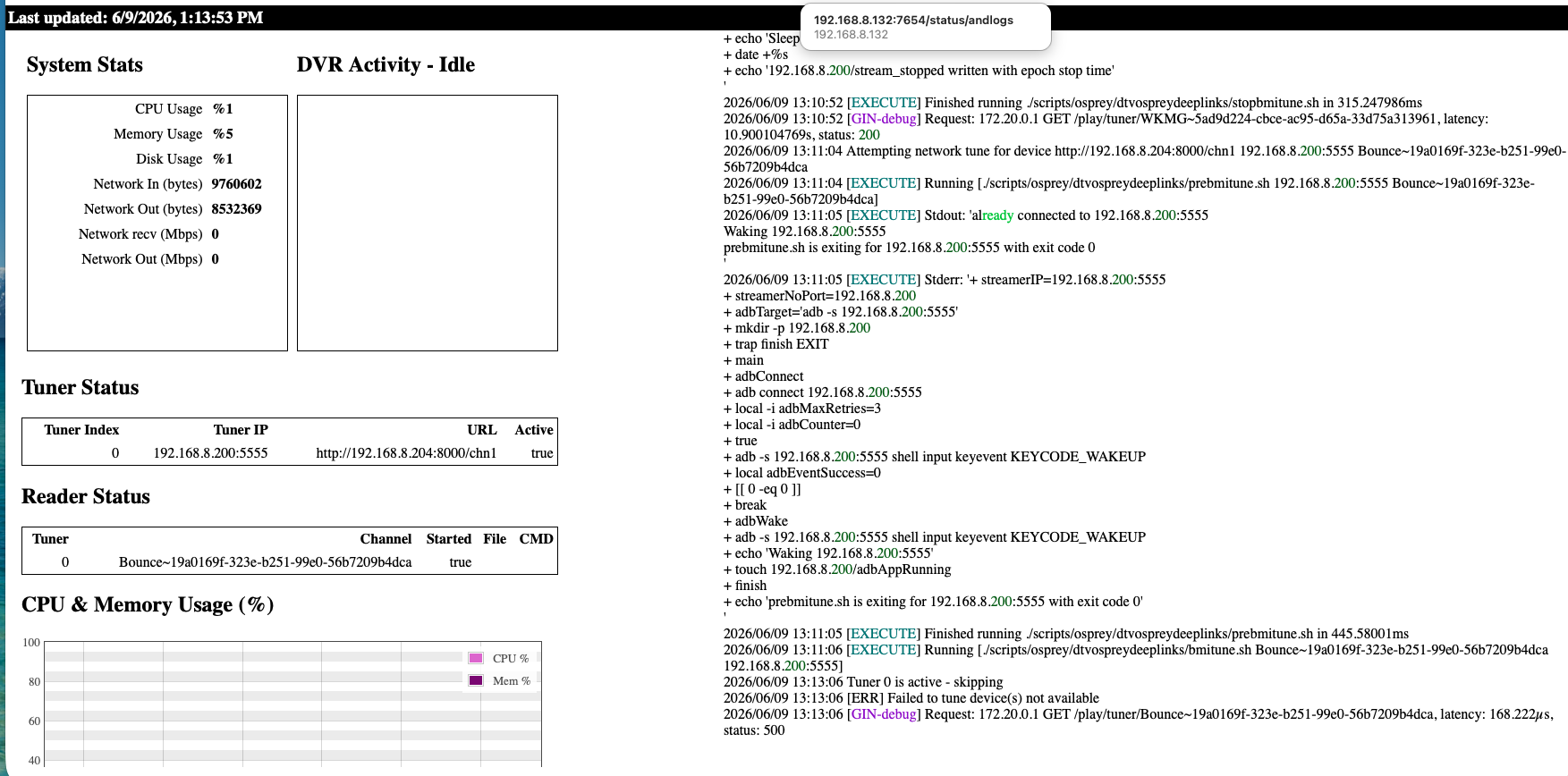

ah4c (appletv tag): tuner held permanently when encoder input goes silent — io.Copy blocked in Read with no deadline
In a nutshell, I'd periodically find both of my ah4c tuners showing in use when they are not being used.
I've been working through this one with Claude for a little bit, and this is the summary of what it's helped me find:
On bnhf/ah4c:appletv using the Spectrum scripts, a tuner can be marked Active forever with no error logged. It is only recoverable by restarting the container.
The trigger is reproducible on demand: put the streaming Apple TV to sleep while a stream is in progress. The HDMI encoder stops emitting bytes but holds the TCP connection open. ah4c blocks in net.(*conn).Read with no deadline and never returns, so Close() and the stop script never run and the tuner is never released.
I've got a much longer doc outlining what was done and the logs captured showing everything, which I threw into a google doc to avoid a long post here.

These channels are coming in over a VPN so I adjusted the stop script to force quit the spectrum app to minimize vpn traffic when we aren't streaming these channels. I also added the bit where it opens the Spectrum app and waits a few seconds for it to load before tuning to a channel, without this the app sometimes would launch with subtitles turned on, even though all settings had them disabled.
I'm concerned the way you've implemented the force-quit may be part of the issue here, so I'm posting a new set of scripts I'd like you to try below.
On the subject of your AI-generated report, we may already have a fix in the code tied to some work done a couple of months ago by @anon38303228. The fix is gated behind an env var, so I'm also posting a new Docker Compose and sample set of env vars below.
