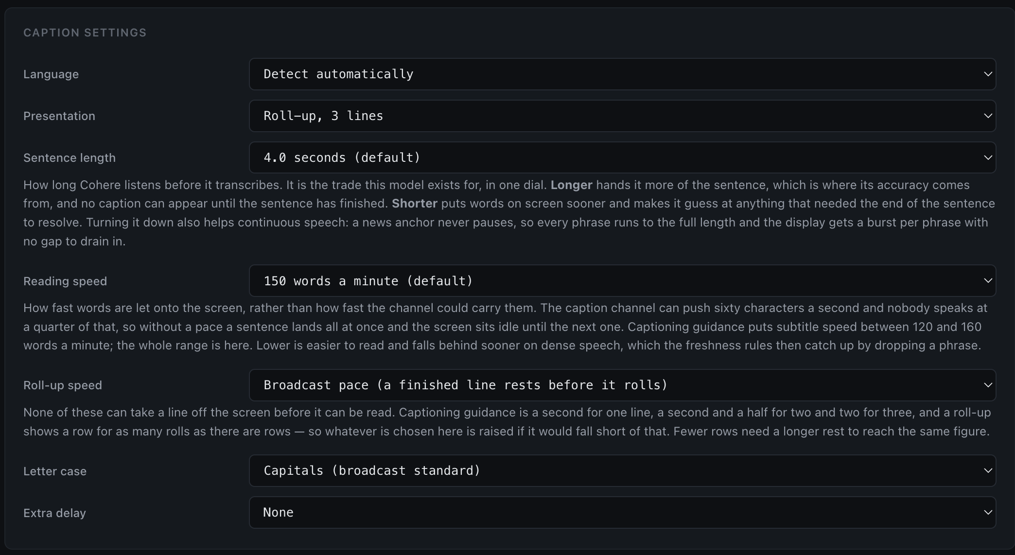

Seems better. I set the reading speed at 130 wpm. I still think the minimum time on screen should be adjustable (if possible). Also, would it be possible to not have a blank line between CC lines? I think that could make reading easier as well.
@mackid1993 What does "Extra delay" do?

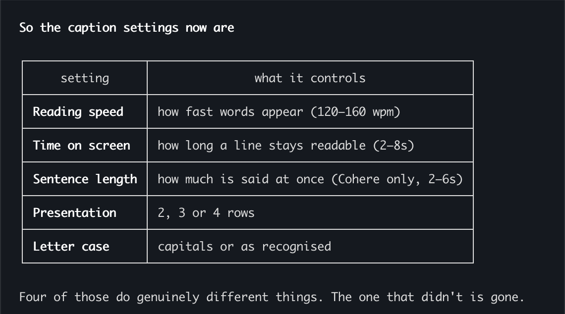

It's a totally misguided setting that should not have been there probably. It made it wait longer, which would have just thrown the transcriptions off of speech. I believe I fixed the blank line.
These are what the settings should do now. Sorry for the British English, I don't know why Claude keeps outputting that.
Actually watching this on my TV right now, it actually looks really good.
To my eyes, so I'd like to hear what other people have to say. I think that ability to slow it down should help everyone though.
For me, setting reading speed to 150 WPM and setting time on screen to 5 seconds looks fantastic.

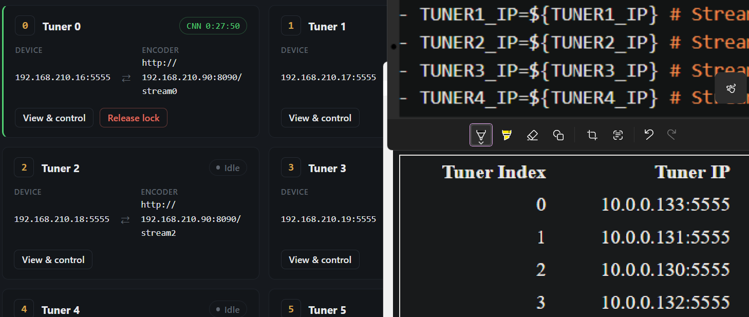

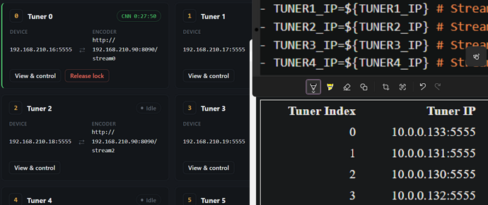

I got a question.
any chance we can do something about the tuner numbering? as you can see I originally tried to plan my ip's logically to help keep everything strait to my eye :eye: and in my brain :brain:
What do you mean? Tuner numbering is unchanged? Goes from tuner 0 to tuner whatever.
while I do understand and normally have no problem with starting at 0, nowhere do we define a tuner 0.
NUMBER_TUNERS=4
TUNER1_IP=10.0.0.133:5555
ENCODER1_URL=http://10.0.0.122/live/stream1
TUNER2_IP=10.0.0.131:5555
ENCODER2_URL=http://10.0.0.122/live/stream0
TUNER3_IP=10.0.0.130:5555
ENCODER3_URL=http://10.0.0.121/live/stream0
TUNER4_IP=10.0.0.132:5555
ENCODER4_URL=http://10.0.0.121/live/stream1
