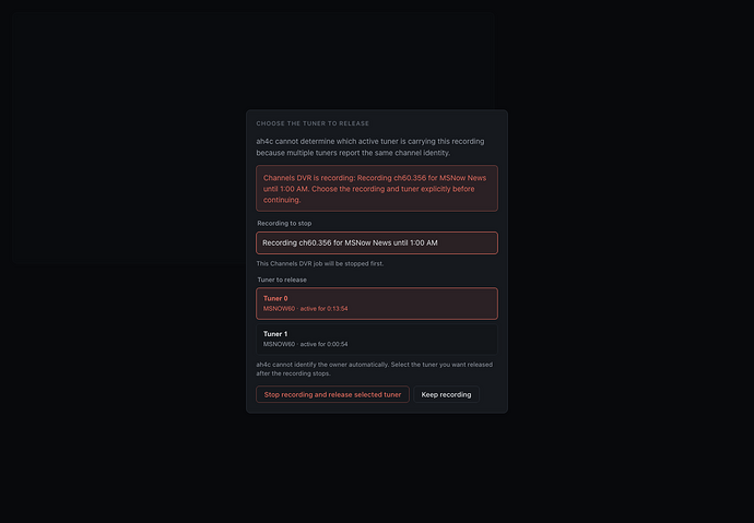

Only two values are passed to an ah4c script, a tuning ID (whatever value is after play/tuner/), and the IP/hostname:port of the streaming stick being controlled by ADB.
Give me an idea of what you're trying to accomplish, and I think we can come up with a way that doesn't involve using duplicate tuning IDs.
As for your GitHub question, I was fixing things based on @Shaggylive's reports so once he gives me the all clear, I'm fine with it being merged.
Did you figure out a way to deal with these duplicate tuning IDs/URLs he's using?
I just got up here, so I'm going to start looking into that now.
Alright, the robots came up with a solution. So, if it can't identify the tuner reliably, it should come up with a little popover like this.

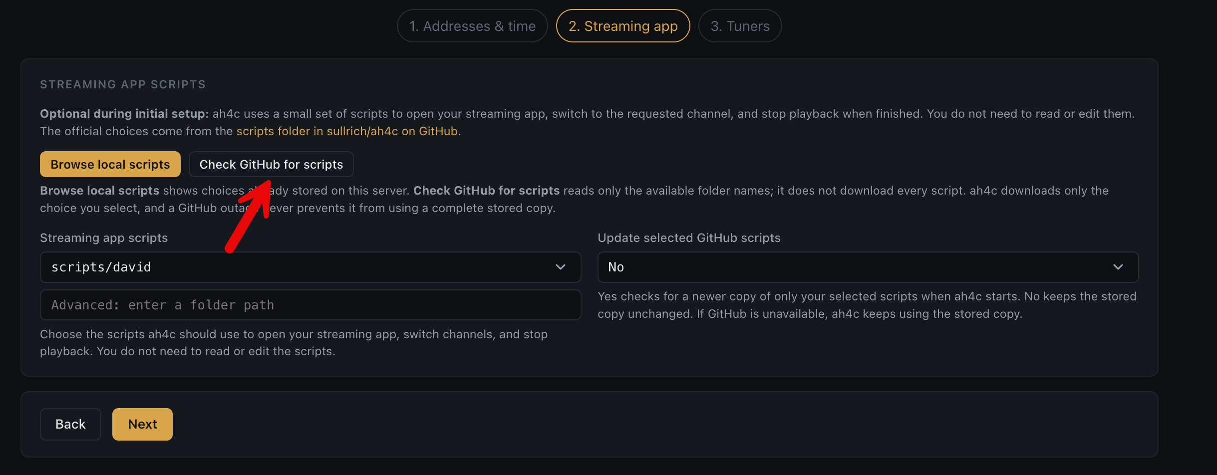

Moved to Streaming app. Browse local scripts is highlighted. Clicked and nothing there. Selected GitHub for scripts and selected scripts/firetv/dtvstreamdeeplinks
* On a 1st launch, I would have expected the Check GitHub option would be highlighted
I left the Update scripts as Yes (for now). I'm assuming I can override with an environment variable later. Looked at Advanced:upload custom control files but left as is. Hit Next. Moved to tuners section.

Check GitHub for scripts, it is right there in the wizard. I don't know if you maybe missed that or if there's anything else I can do with that. I'm not really sure what the issue is. It's not really highlighted or not highlighted; it's just kind of design language. If you want that one to be yellow, I can make it yellow.
I think the idea is that's an optional thing. Some people might not want to call out to the internet for scripts if they're a little more tech-savvy or cautious, so the intent is to make that not the default option.

you're right, I'm flipping the colors on those buttons
If your goal is to use DTV with ah4c and no Ospreys, you definitely want to use the FastChannels ah4c bridge. Tuning times are ~5 seconds, and Closed Captions can be enabled in the source stream. For those using DTV, Sling, Philo (and a few others I haven't tested including Fubo and Spectrum), tuning via provider app deeplinks is yesterday's news.
@jagrim I implemented that suggestion, so the option to check scripts on GitHub will show up in yellow now.

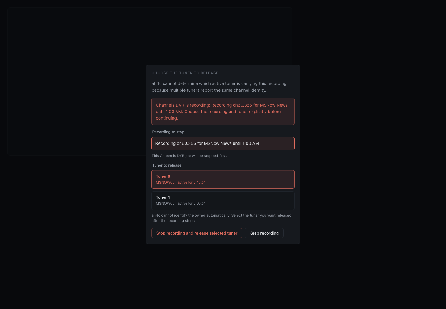

@Shaggylive / @bnhf when something is detected as a duplicate, it will come up with a popover asking you which tuner you'd like to release rather than blindly releasing the wrong tuner.
I think this is good guarding regardless, but maybe there's a better way to do what you're trying to do.
I opened up a second PR #41 for this duplicate tuner logic to keep things a little bit cleaner. #40 has the yellow coloring added to it since that's purely polish. #40 to be merged before 41. It seems to be working on my end, but I'd appreciate it if anyone would like to test, especially @Shaggylive.

What I’m saying is: It's yellow, the same as all other command prompts (Next). Since it's not loading any scripts when spinning up, a novice will immediately select the browse local first then have to go back and check GitHub. This is on a first run. After you’re up and running, it’s not an issue. Maybe neither should be yellow. Maybe just an additional statement saying check GitHub on first run.

Pull my latest image, I already made it yellow.
It's the standard primary button color in the CSS. We have two styles of buttons, so I'm not going to make it a different color.
We have more of a muted color and a call-out color, and that's just kind of how the design is.

Personally, I think the tuner selection logic is actually quite solid when it's ambiguous. I think the idea of letting the user pick which tuner to release when ah4c can't figure it out is a good idea, honestly.

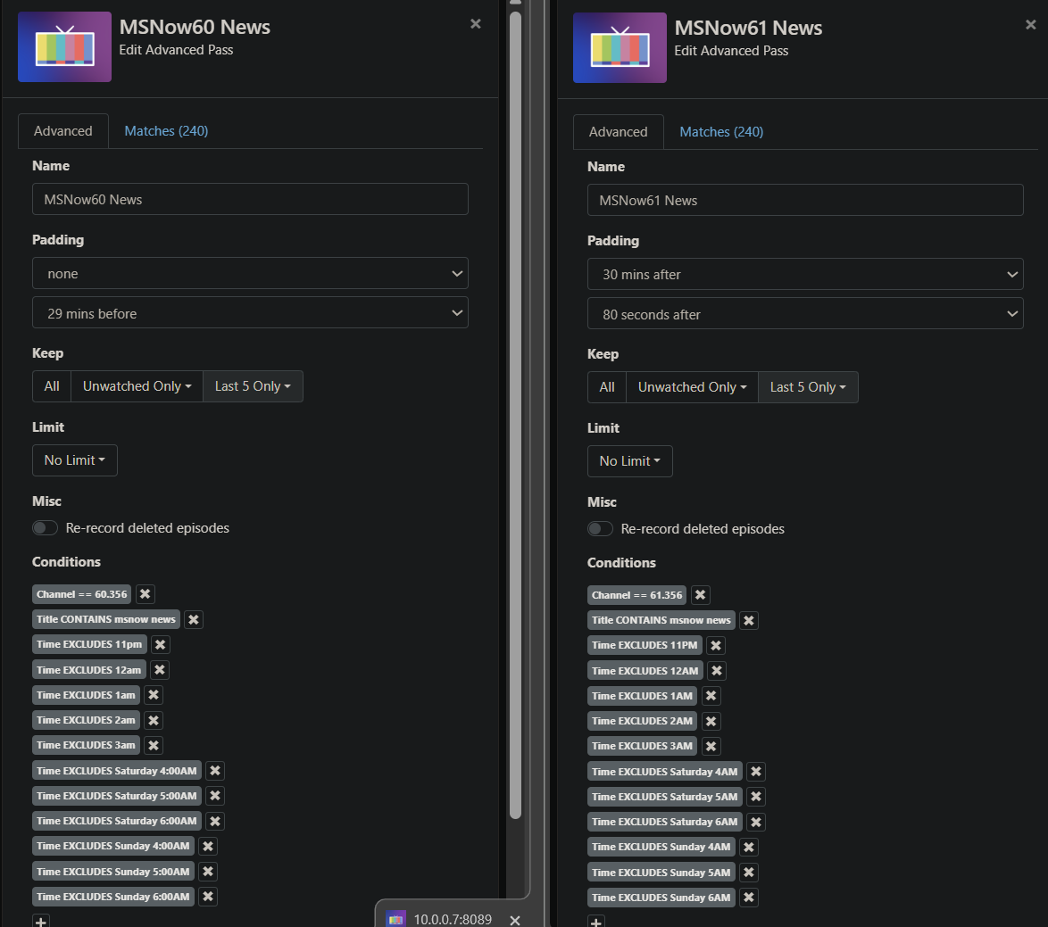

so i'll do my best to explain most of what lead to the config i'm using. I realize some bits and pieces may not be necessary, but aside from the gui getting confused it's the cleanest way i've come up with so far.
in a nutshell :coconut:
I'm trying to recreate the DirecTv 4hr live tv buffer where you could essentially watch tv 4hr behind all day if you wanted. Dish and other dvr's had similar, but I really liked that Directv could do it with with 2 tuners and use the down arrow to switch between without losing the buffer.
with CDVR the best way i've found is by using Autoplay, however this only works if all the shows have the same title, hence the custom placeholder.
Custom Placeholders / Autoplay
I started by just having a custom channel text source
example of one of the variations I used for a while
#EXTINF:-1 channel-id="3" tvg-id="3" tvg-chno="3" tvg-name="MSNow30" tvc-guide-title="MSNow News30" tvc-guide-description="MS Now News 30min" tvc-guide-placeholders="1800" tvc-guide-placeholders-grouping="MSNow30" tvc-guide-tags="ah4c, 720" tvc-guide-art="https://tmsimg.fancybits.co/assets/GNLZZGG002H5PTL.png?w=360&h=270" tvg-logo="https://tmsimg.fancybits.co/assets/GNLZZGG002H5PTL.png?w=360&h=270",MSNow30
http://127.0.0.1:8089/devices/ANY/channels/356/stream.mpg?format=ts&codec=copy
  1. even before my n100 reverted to 6watt and tanked performance I found that 1 hour was too long for comskip to be affective (since live detection sucks) and have found 30 minute blocks to be a decent middle ground (average ~3-5min comskip) and hour block would commonly take ~10-15min and couldn't start until the hour was done.
  2. the smaller the placeholder block the more indexing(or whatever) cdvr's guide data would have to do and any passes have more entries to look through, also comskip doesn't quite understand 15min shows.. lol.

this is my current setup that uses hour long placeholder blocks (faster guide updates ect..) but uses 2 identical passes on 2 different channels with one padded to end 30min early and the other to start 30min late.
ah4c m3u
#EXTINF:-1 channel-id="60.356" channel-number="60.356" tvg-name="MSNow60" tvc-guide-description="MSNow60 News" tvc-guide-placeholders="3600" tvc-guide-placeholders-grouping="title" tvc-guide-title="MSNow News" tvc-guide-tags="Live",MSNOW60
http://{{ .IPADDRESS }}/play/tuner/356
#EXTINF:-1 channel-id="61.356" channel-number="61.356" tvg-name="MSNow61" tvc-guide-description="MSNow61 News" tvc-guide-placeholders="3600" tvc-guide-placeholders-grouping="title" tvc-guide-title="MSNow News" tvc-guide-tags="Live",MSNOW61
Passes
I think it actually works great! cdvr autoplay will only autoplay to the end of the current recording when you start a Watch Next, but it still lets the tv play in the background unattended for a few hours :+1:
