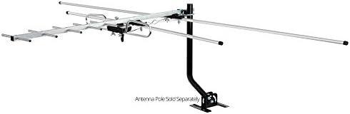

Should replace the antenna with an RCA Yagi. I bet it will pick up those channels you are looking for. Also, significantly cheaper.
Yea....:
I've been building/installing antennae for over 50 years and I know a piece of crap (make that $100 Piece of crap) when I see one:
If they actually visited TV Fool/Other to see what was possible, then installed that joke on your roof they're not really interested in providing OTA (cause that thing just won't cut it), so you paid for a solid installation (adequate - at first glance). What they really want is for you to keep your Dish Package.
That RCA would be better than that Chinese Miracle Antenna, but do keep in mind that 150 miles is WAY over the horizon and unless physics and the laws of the universe have suddenly changed - that too is a bogus claim that can NOT be realized... ever (unless you want to put one atop 1000 foot tower).
Be sure to buy a real antenna designed and cut for the bands you're working in, in a fringe area you need antennae with real physical size (not a space age antenna designed to capture customers - not signals) and remember:
If it sounds too good to be true - it very likely is.
There's another UHF/VHF-High for not much money - good for 40 miles - not the 80 they claim. On the Amazon page above near the bottom you'll see those things that look like what's sitting on top of the Robbie The Robot's Head in Forbidden Planet (1956). Those may work in China because they're cut for Chinese UHF (perhaps Myanmar, as I recall a spirited exchange among old timers when they showed up). If they work for someone in America RF energy is re-writing your DNA and/or cooking you and your dog from the inside out as we speak and yes, a coat hanger would work just as well...

I recommended the RCA Yagi because those are what I use. I agree 150 miles is probably a ridiculous claim (although I haven't tested it), but it pulls in every channel available in my area, in perfect quality. From towers in multiple different cities. I bet it would do anything under 40 miles perfectly. And would probably do other further away channels if the weather was right.

The RCA antenna appears to be a traditional, time honored design configured in a way as to produce real gain. The 'Better Mouse Trap' appears to be a coat hanger in a plastic shell - the only gain generated through an amplifier.
