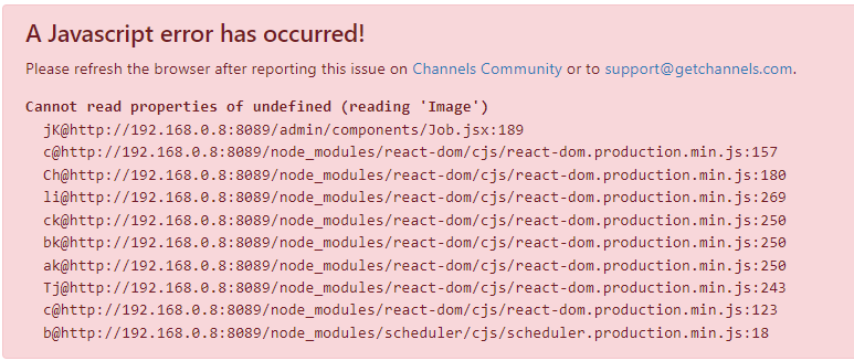

Ever since changing the drive, I've been getting a Javascript Error whenever I edit the channel in Scheduled Recordings. That never used to happen so I wonder if it's tied to putting in the new drive even though the Disk Name, Drive Letter, and Paths are exactly the same as the prior drive.
The main reason I often edit the channel is to manually select a TVE channel or an OTA channel when I'm confident it will work in order to maximize how many of my 3 HDHR Prime channels will be available when needed.
