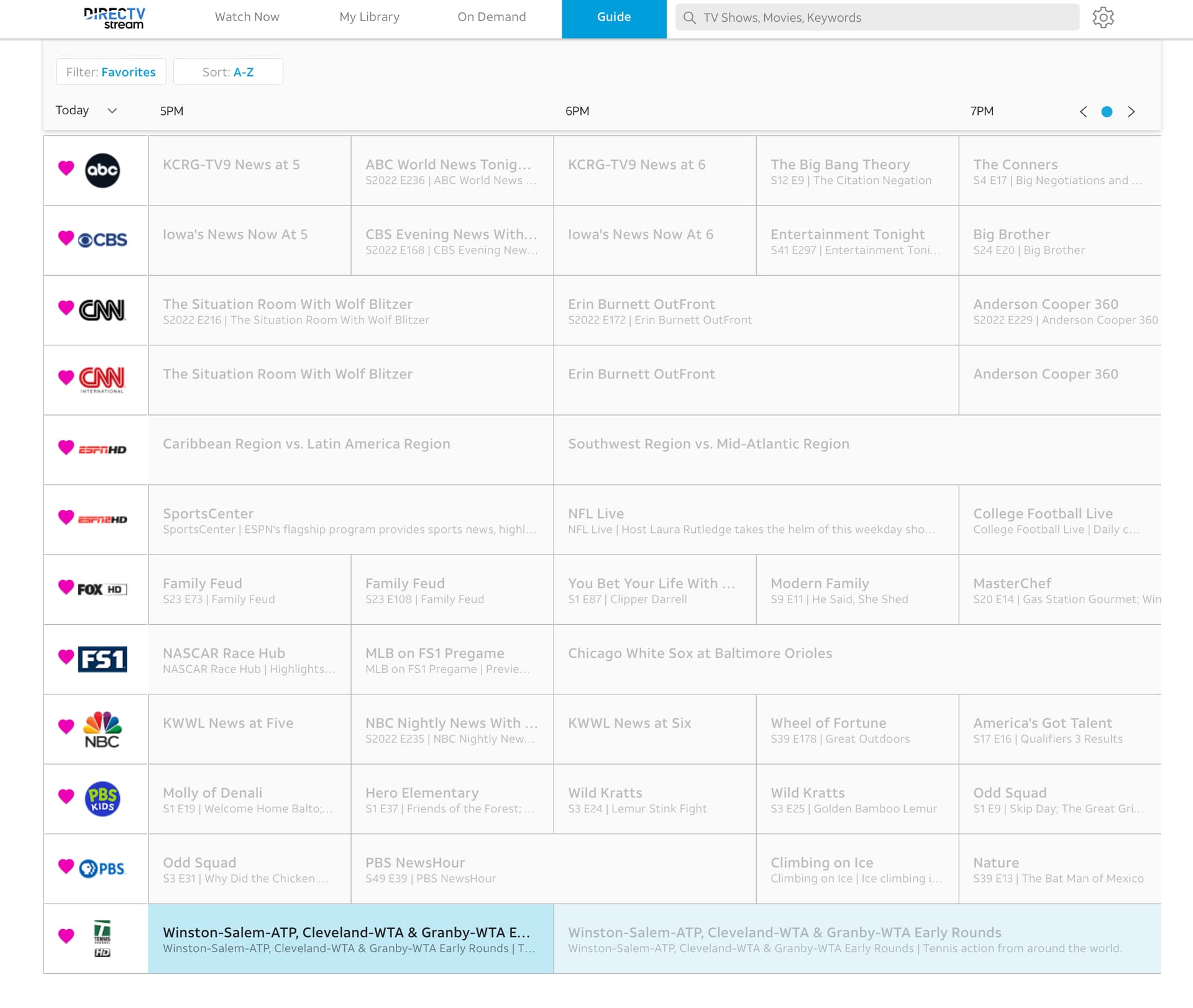

The "Center Court Live" show has back-to-back episodes that are for day session and night session. Here's the guide from DTVS:
Just to clarify, the second one is definitely not a repeat of the first one -- it shows completely different tennis matches (for night session, as compared to day session for the first episode).

Digging around, I found that both of yesterday's episodes had the exact same Series Number and Episode number (in DTVS). Not sure if that metadata comes from Tennis Channel or from DTVS. I am certain that I saw this on the iOS DTVS app yesterday, but unfortunately, today it's not showing me metadata at all for the second of today's back-to-back episodes, so I can't provide a screenshot showing the duplication.
