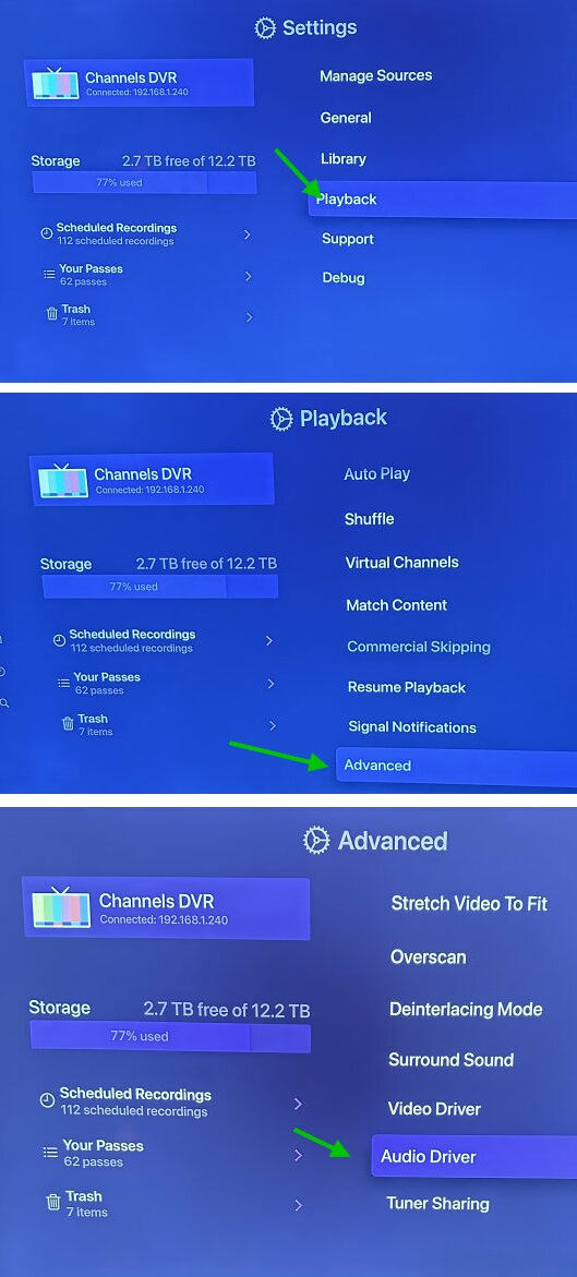

Go to Settings > Playback > Advanced > Audio Driver: Experimental
Worked for the micro-stutter on my Apple TV 4K. Thanks!!!
I am also getting stuttering audio every time Siri is activated on my 4k apple TVs. I checked the settings but it looks like the experimental audio driver option is no longer available under the path described (@tmm1). I checked under other headings but did not see an option for audio drivers.
Settings -> Playback -> Advanced -> Audio Driver -> Experimental
Thanks! I always adjust settings on the web UI. I didn’t realize they were talking about a setting in the AppleTV app. Thanks for the directions I have adjusted the setting.
