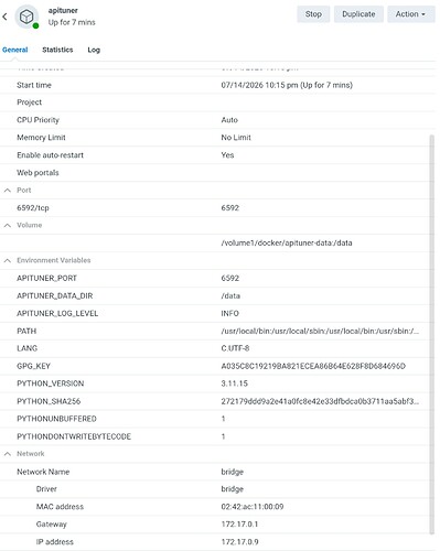

Part of me is thinking that the docker container doesn't have curl installed inside of it. I don't think it has anything to do with synology but as I've seen here in this forum running anything with synology seems like hell on earth so idk
@DetroitTV are you using portainer to run this?
Create the Synology directory /volume1/docker/apituner-data first,
then use this run statement
docker run -d \
  --name apituner \
  -v /volume1/docker/apituner-data:/data \
  -p 6592:6592 \
  -e APITUNER_PORT=6592 \
  -e APITUNER_DATA_DIR=/data \
  -e APITUNER_LOG_LEVEL=INFO \
  --restart unless-stopped \
  ghcr.io/matthewfkoch/apituner:latest
Updated: corrected directory and added port mapping

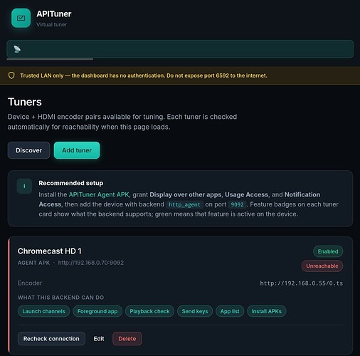

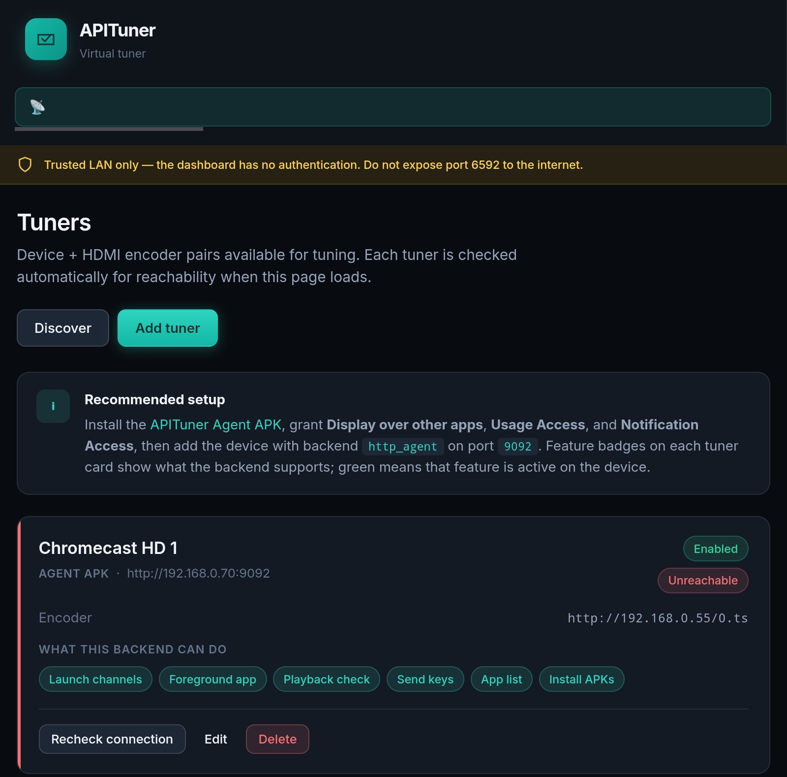

Unfortunately, the same results
I was just pointing out the volume binding on a Synology.
Unfortunately, I'm not running the project myself.
Have you tried temporarily disabling the Synology Firewall?
I got the api agent to work on my onn puck. No luck on my firetv stick. It crashes instantly when you open it over there

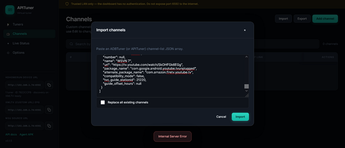

I'm trying to try out some channels on apituner and I get this when I try to import it from adbtuner
I’m not at all surprised that it doesn’t run on the fire sticks. There are some android 14 dependencies currently and I think they mostly run older versions of android. I do have a few laying around so I’ll do some testing and see if I can get them working. Do you know which model or software version is running on yours? As for the channel import, I’ll take a look and see what’s going on. If there are any logs or if you can send over a sample of your file so I can test it locally here
I had tried the volume binding already but tried it again. I tried disabling the firewall temporarily, still unreachable.

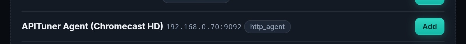

If I run the container in host instead of bridge and use discover in Apituner it shows the agent but when I select add it flashes tuner not found at the bottom of the screen.
Yep...my FireTV android version is 9. This is the firetv 4k max

  • ADBTuner import — clear errors for null/duplicate channel numbers (no more Internal Server Error)

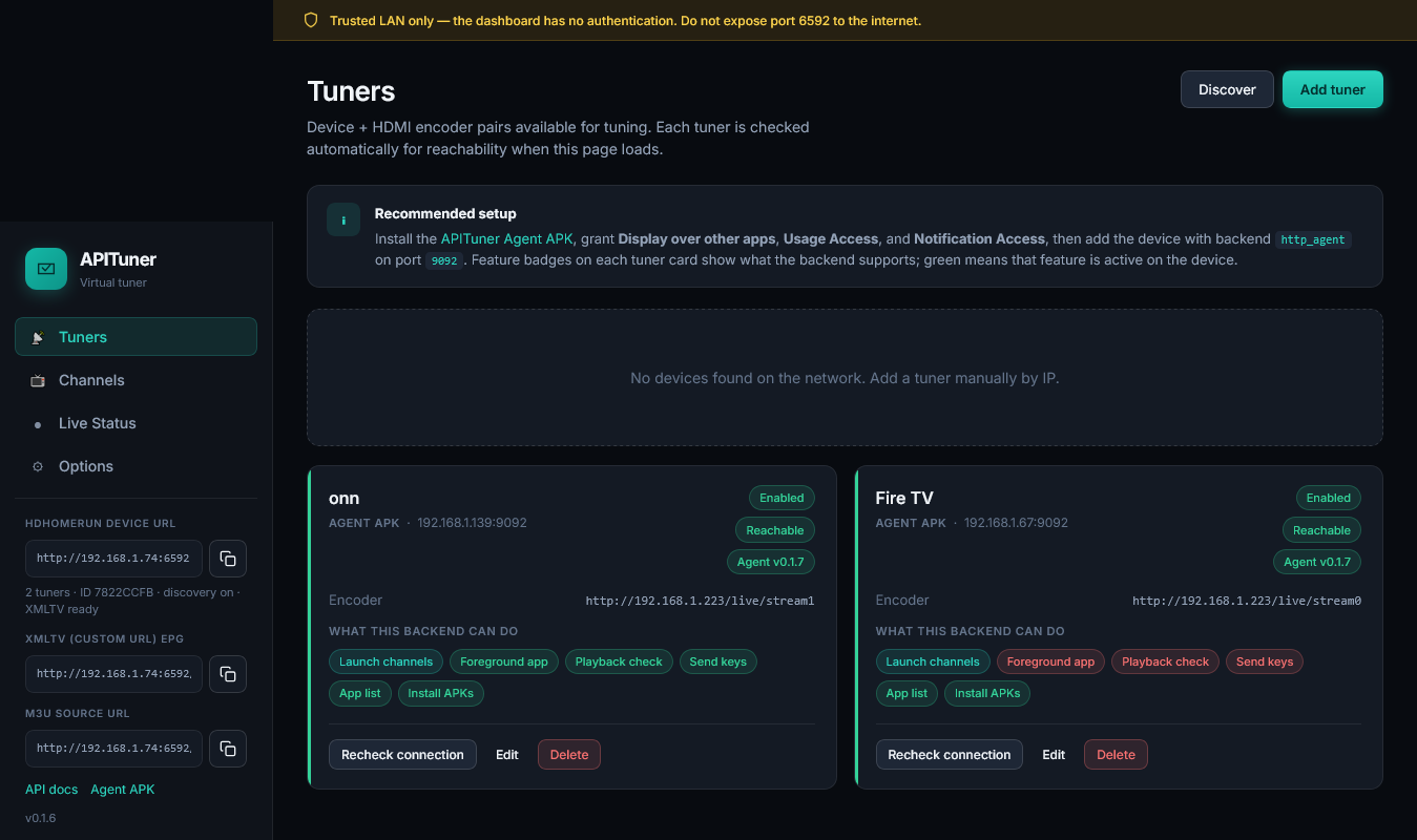

Well...the app doesn't crash but...it doesn't do much else either. I can't grant any permissions I need with it
As for my onn puck, I can't view any channels with it after successfully importing the YTTV stuff. I'm getting 503 error for some reason
So with Firesticks they need the permissions to be granted via ADB because they aren’t exposed in the UI. This project was mainly created as a work around for the changes in Android 14 around ADB. I assume some users will have a mix of both devices so I can make the server grant the permissions via ADB for fire sticks only. I have it working in my test environment and will push a new release this week evening.
If you can provide any logs from docker on the onn device issue that would be great

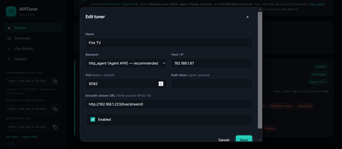

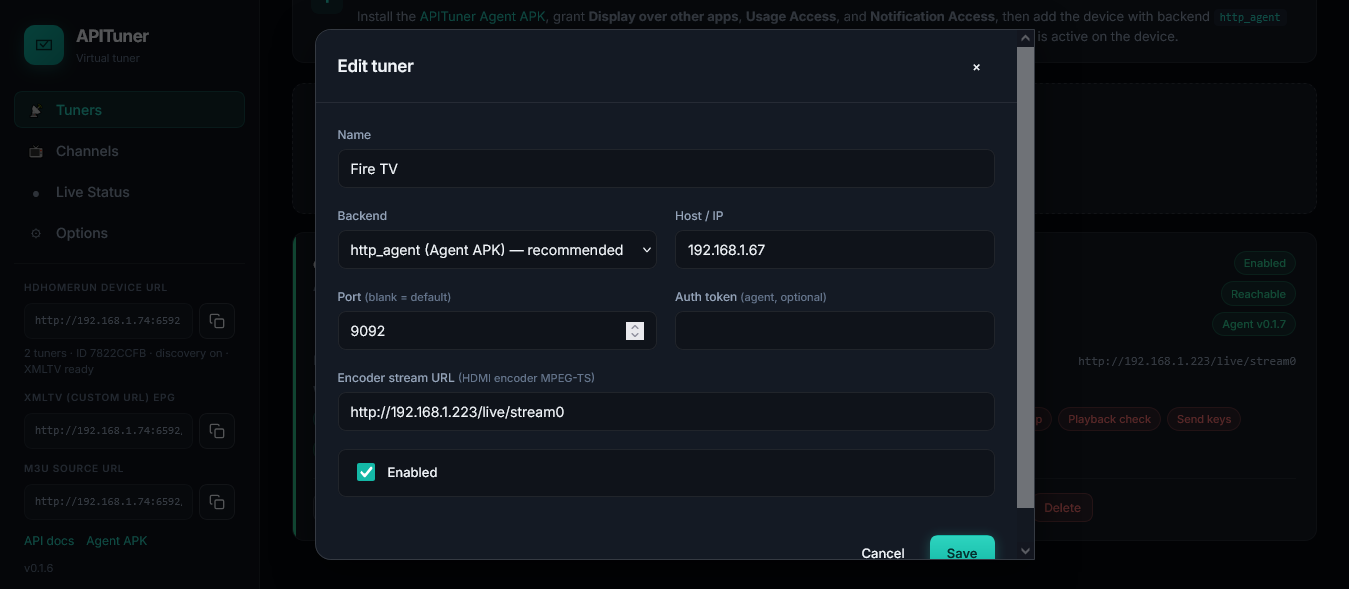

OK, I don't see the Grant Permissions anywhere. I think I'm missing something
Anyways, heres the logs. I can't get anything playing on the device that is solid green

Just an update, I got the YTTV channels to go on this now.
Just waiting for the configs support so I can ditch adbtuner and just use this
I need to do some research on this, my initial thought is that it should work on the Android TV based units pretty easily. On the Fire Sticks I don't think I can do full navigation without ADB. I'd like the app to be as ADB free as possible as that's really the intention of the application. I'll take a look and see what the options are.
FireTV are more locked down than the onn pucks or Chromecasts. Thats really it. Its tough to change it without rooting...and its very difficult to root FireTVs anyways. Maybe a split option for the Fire OS system is necessary here.
One suggestion I have: Have apituner control the chromecasts/streamers/onn pucks via API and if its FireOS, have apituner control them via adb.
