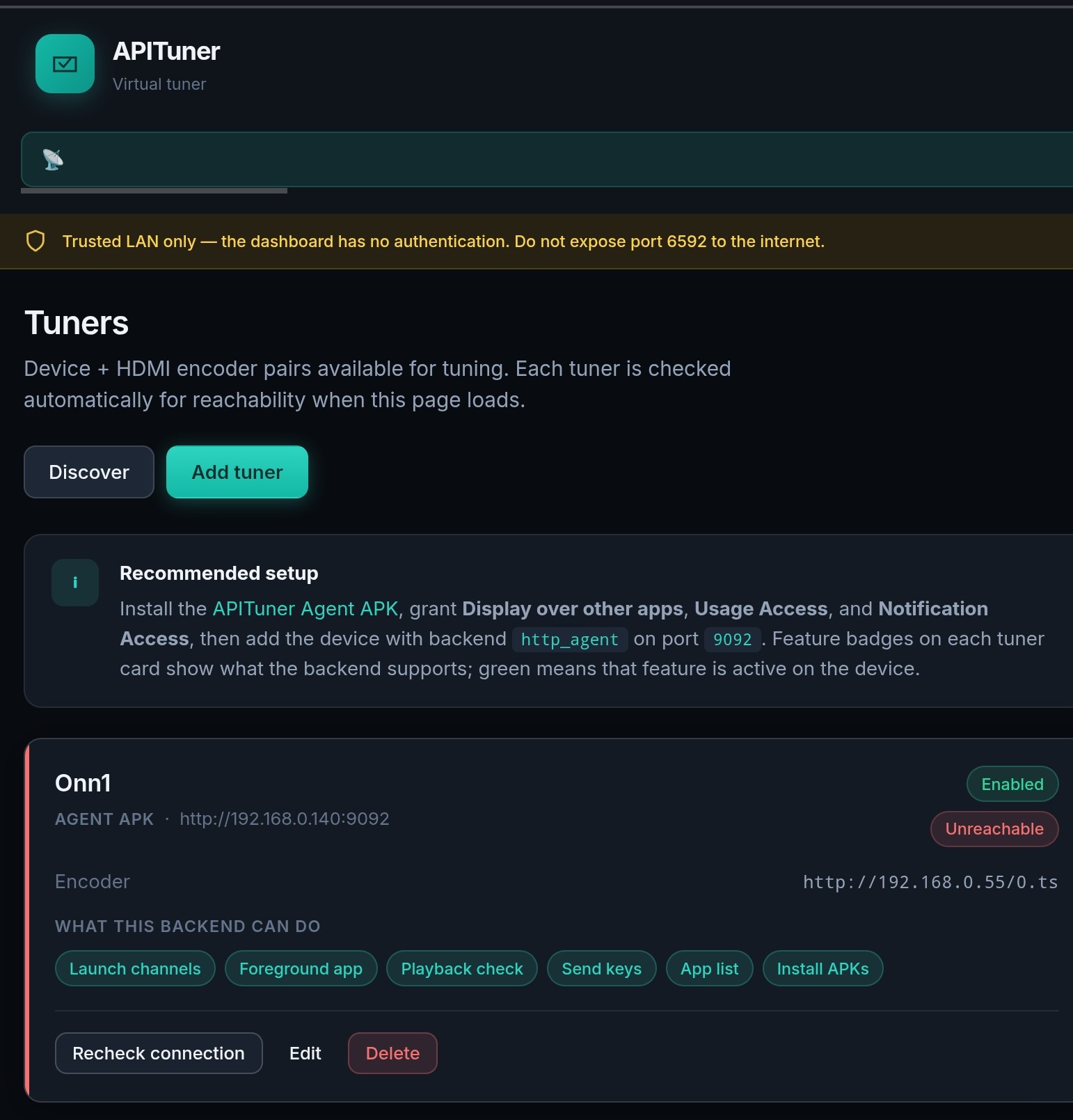

I'm getting an error that my ONN isn't reachable.
I’m not a true developer so I was being cautious to make sure everything went well. If I found some devs that wanted to help or use it I planned to open it up.

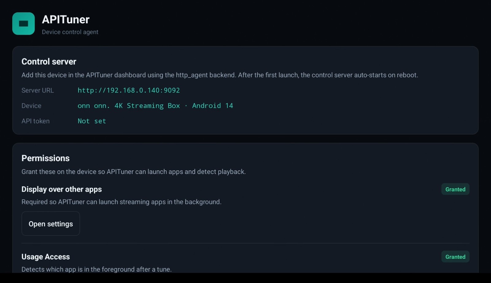

From your server running APITuner can you try to hit http://192.168.0.140:9092/api/health.
The server running APITuner is Synology NAS.
When I run http://192.168.0.140:9092/api/health I get:
Success: true
Message: "APITuner Agent running"
I'm not fsmiliar with running docker on Synology but you may benefit from using host networking.

Same result, Agent unreachable

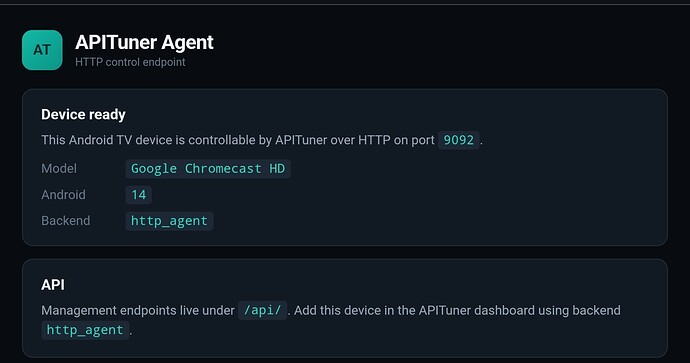

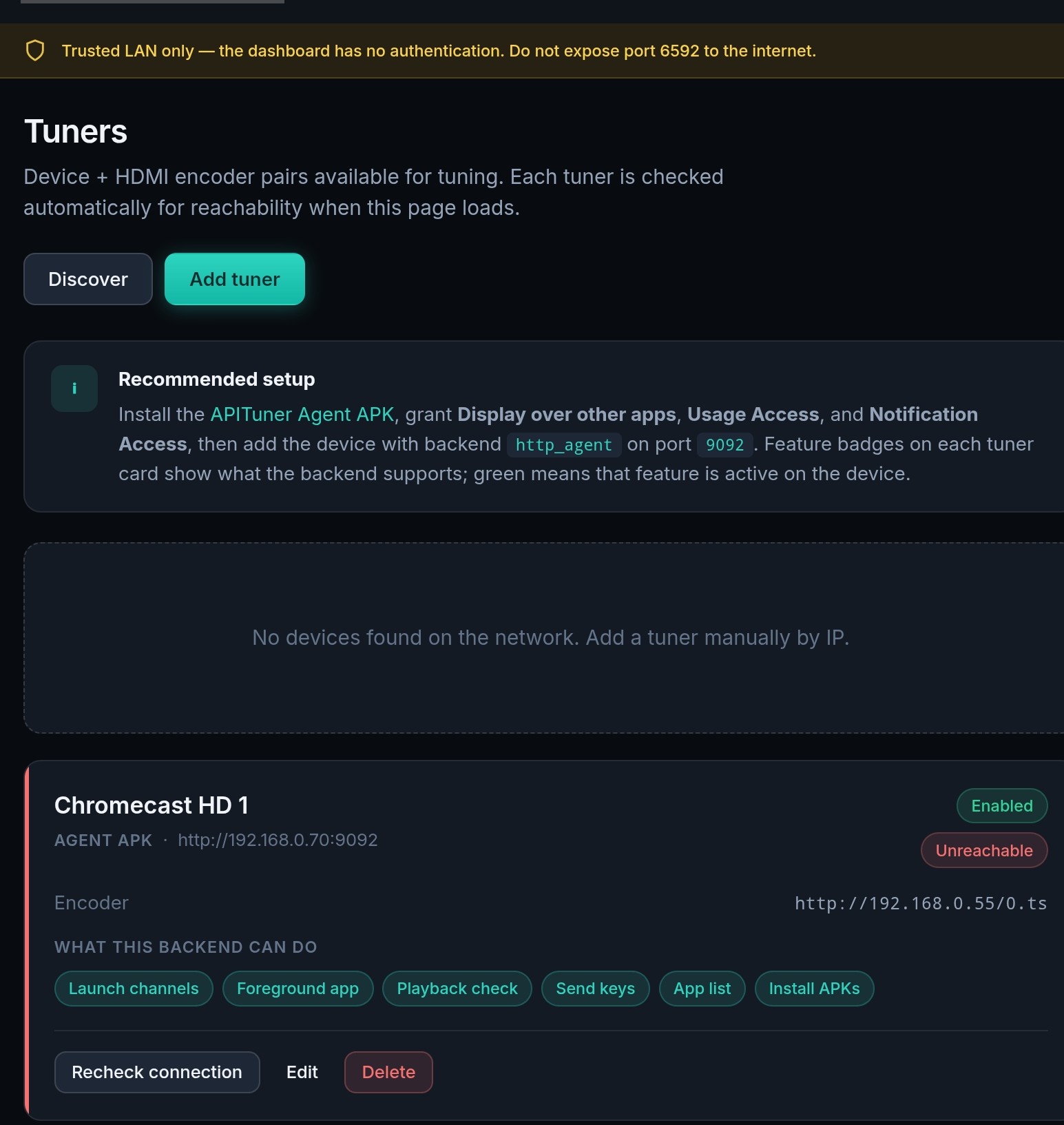

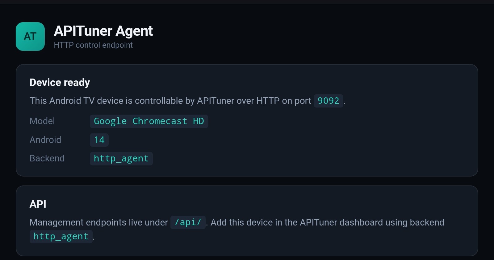

I have the same result with a Chromecast, unreachable
From SSH on the Synology (or Container Manager → terminal on the apituner container):
from host
curl -v --connect-timeout 5 http://192.168.0.70:9092/api/health
from inside the container
docker exec apituner curl -v --connect-timeout 5 http://192.168.0.70:9092/api/health
GET /api/health HTTP/1.1
Host: 192.168.0.70:9092
User-Agent: curl/7.86.0
Accept: /
< HTTP/1.1 200 OK
< Content-Type: application/json
< Date: Tue, 14 Jul 2026 23:02:05 GMT
< Connection: keep-alive
< Content-Length: 51
{"success":true,"message":"APITuner Agent running"
sudo docker exec apituner curl -v --connect-timeout 5 http://192.168.0.70:9092/api/health
OCI runtime exec failed: exec failed: unable to start container process: exec: "curl": executable file not found in $PATH: unknown
