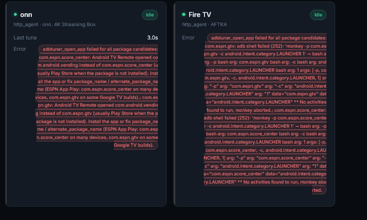

Well...new version, new errors
The onn puck will give up half way to tuning into the channel and go to the play store for some odd reason
The firetv will give up as well and just do nothing while on the espn app.
You may want to test things out yourself here if you have an ESPN account. I see the sourcecode and it seems like you're giving a lot to cursoragent. I use AI too but you gotta keep an eye on it as they can hallucinate and create a brand new issue
Anyways logs
I don't know what to tell ya man, everything works on my end. The code is there if you have any interest in getting your edge case to work. Thanks for testing.
Ehh...I thank you for your efforts. Looked good outside of that btw.
I may have to stick with adbtuner for now...

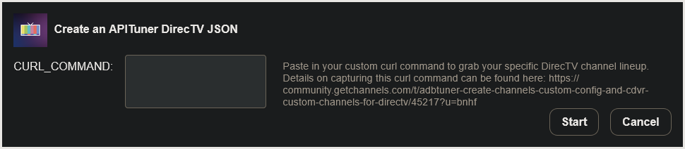

New bnhf/olivetin:latest (aka bnhf/olivetin:2026.09.01) pushed this afternoon with support for producing an APITuner compatible DirecTV JSON file, containing that specific subscriber's set of available channels:
