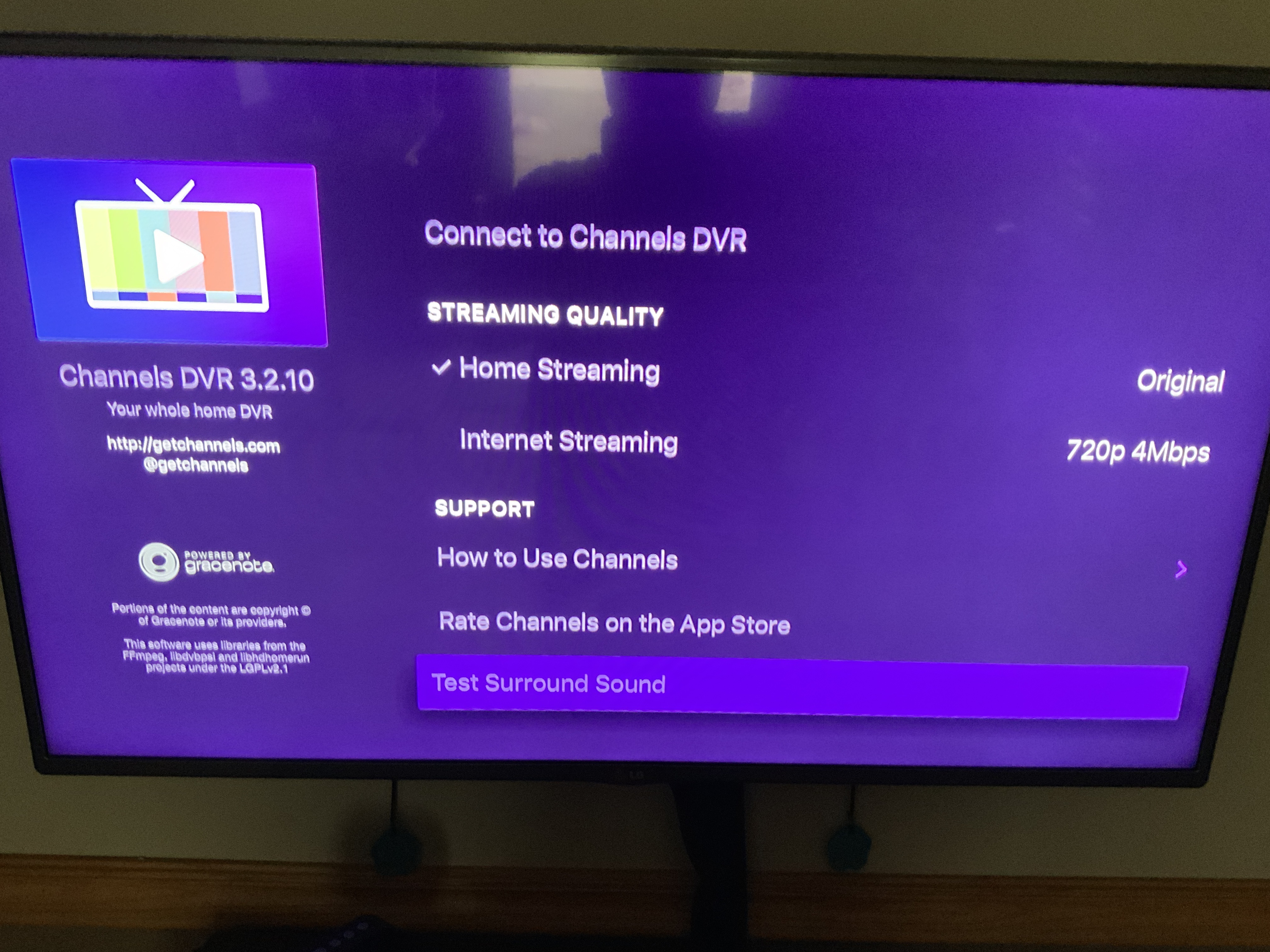

Oh, I see the Submit diagnostics at the bottom of the Channels iOS app, but not in the AppleTv app. The iOS app works just fine. The AppleTv apps do not connect. Will submitting diagnostics from the working app help?
What version number is shown on the Apple TV app?
3.2.10
There should be a Submit Diagnostics option at the very bottom of the Settings tab. Can you take a photo of what you see at the bottom?
I see the same in the plain Channels app 3.2.10 as the Channels DVR app. Neither find the HDHR.
Hmm ok.

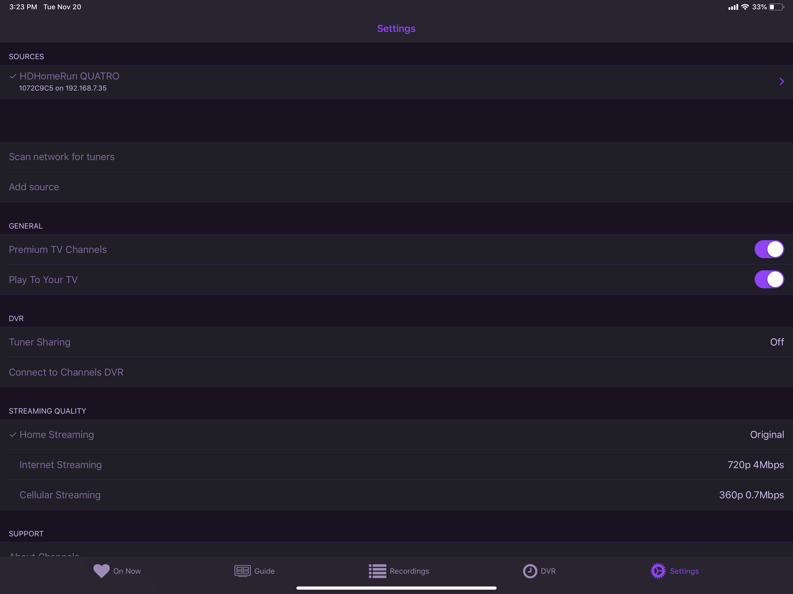

What IP is assigned to your iOS device which works?
It seems wrong that your HDHR is on one subnet (192.168.7.x) but your ATVs are on a different subnet (192.168.0.x)
IP showing for the WiFi of the working iOS shows 192.168.7.206 in setting>wifi
HDHR is connected directly to the Linksys router. The other devices connected to the Eero’s via wifi. If that helps.
Sounds like both your HDHR and iOS are on the 192.168.7.x network, which is why they're able to talk to each other.
But your ATVs are on a different 192.168.0.x network, which is why they can't talk to the HDHR.
