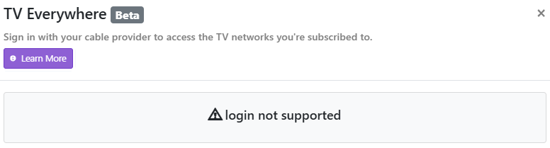

Armstrong TVE Issue
Wasn't able to tune to any of my TVE through Armstrong and got this error all of sudden after removing it as a source and trying to re-add it
Please say it ain't so!

Ok, ill break it down alittle bit clearer from my initial post:
Armstrong TVE was a source of mine and has been working for awhile
  1. Tried to watch TNT last night and I had issues tuning to the channel, would not go through
  2. removed the Armstrong TVE source from channels
  3. Tried to add Armstrong TVE source to channels by putting my login in and selecting Armstrong and was met with the "Login not supported" message i initially posted.

Looks like I'm getting a 403 Forbidden on the Request URL: http://127.0.0.1:8089/providers/tve/mvpds/auth_armstrongmywire_com
I'll have to wait for a timeout I guess and try again soon...
403 error indicates the account running the web server server does not have rights to access the directory entry. It's a server side error. You can't fix this. Contact your provider and let them know what is happening.

This community is amazing, the fix worked, I was able to add Armstrong back
Hi @mjholla82 I tried the latest pre-release and confirmed the "login not supported" error is gone, but I'm still seeing an "authentication failed" issue. Is there anything else you did to resolve? It looks like the robot captcha is triggering. I confirmed the login still works fine with the provider's website.
Hmmm, no I didn't have to do anything beyond selecting Armstrong and logging in with creds
For anyone else who encounters the bot detection, it seemed to go away after waiting 48 hrs.
