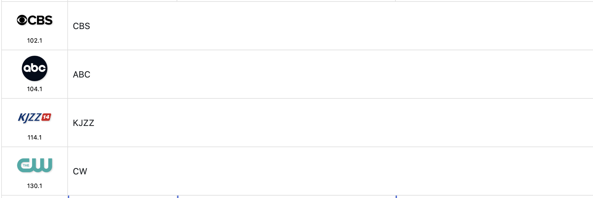

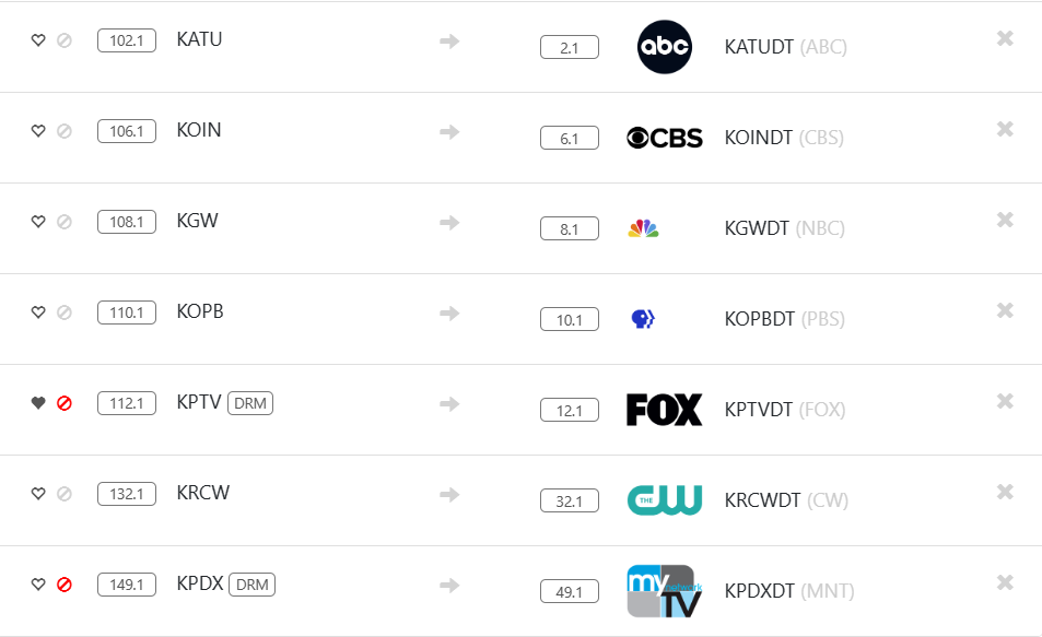

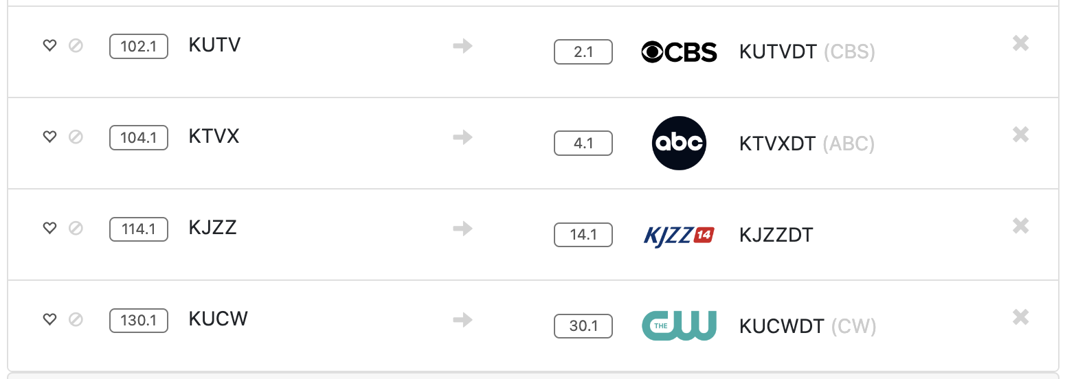

I added an HDHomerun Flex 4K to my setup today and have a question about how guide data should work.
I have the channels mapped to their non 3.0 equivalents and they still show up on their own but with blank guide data.
How should I get this setup?

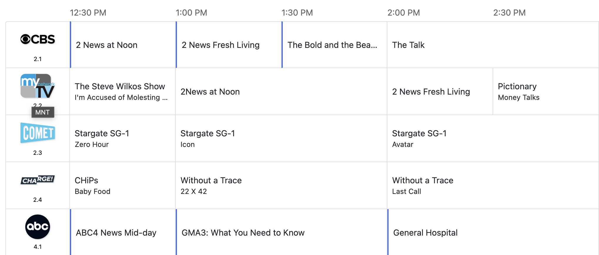

They will show independently in the web UI grid guide.
They only combine in the clients.
Something they call "stacking", which I never understood.
I checked the client and they still are not "stacked." I tried both by channel number and by guide data neither "combined" or "stacked the ATSC 3.0 channels with the standard versions.
They say a picture is worth a thousand words.
If someone that does understand the stacking/combining could display a couple example images, I'm sure I could understand. All the posts/documentation I've seen are just a bunch of words that make no sense to me. Probably because I rarely use their clients and run four dvr servers, each with different sources.
To make it easy to understand ATSC 3.0 and ATSC1 never stacked together even when you Choose to Stack by guide or number... Stacking has other problems that have been reported but ignored.
