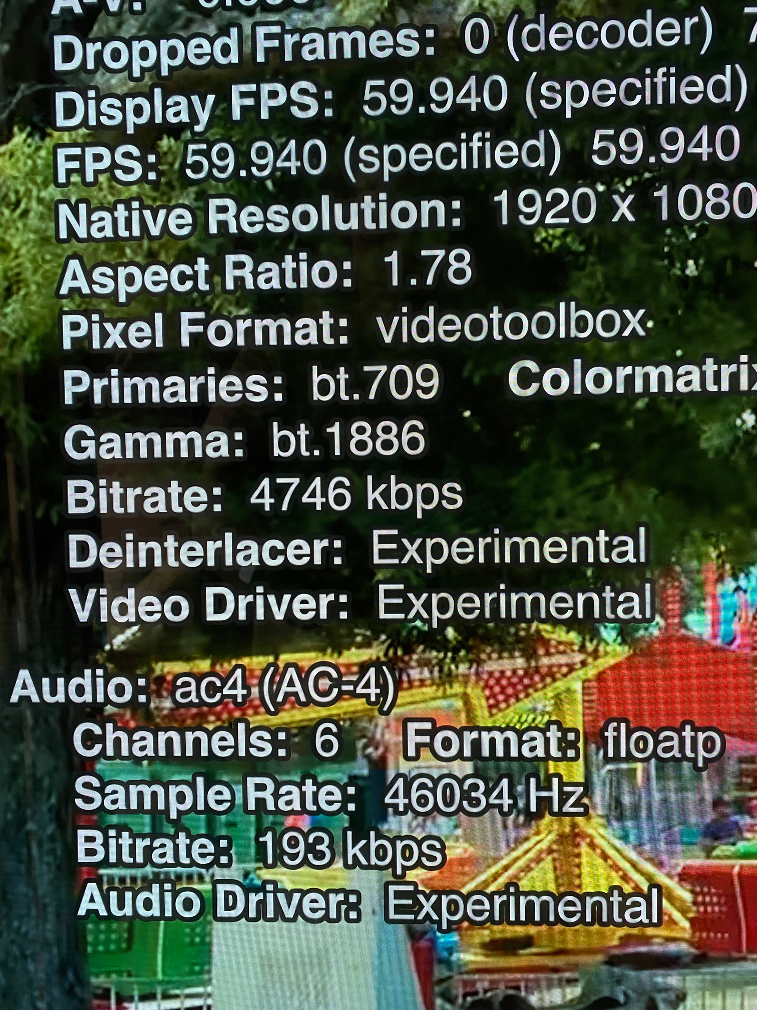

Also another possible bug, When watching 3.0 feeds the audio sample rate is reporting at 46034hz. The chief engineer at the station reports they are encoding at 48000hz which is the standard. Not sure if the decoder is malfunctioning or stats is just improperly reporting the sample rate.
