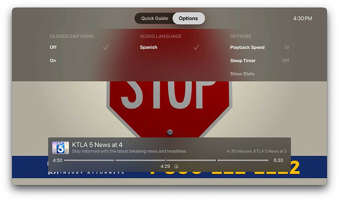

Now when I try to tune into my only ATSC3 channel, KTLA 105.1 in Los Angeles, it stays frozen on a still image for about 2 minutes. I swipe down and see that the only "audio language" offered, is Spanish. I stay on this screen for awhile, and then after that delay, the video finally starts playing, buit without any audio at all.

Thanks for the reply. Hmm, it’s working now, so maybe it was a temporary broadcast issue on KTLA’s side. I’ll keep an eye on it and will record some of it the next time it happens, if it happens.
I do recall the Direct vs. Stream setting the last time something like this happened with KTLA and confirmed the two AppleTVs I tested have it set to Direct.
