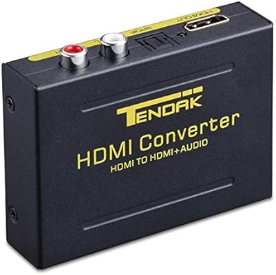

One other idea if you’re up to experiment for about $20. It’s an HDMI passthrough with optical out. One of the commenters in the reviews says it has no audio delay. I haven’t tried it myself, so I can’t say for sure if it will solve the problem, but it does say it will pass through 5.1 audio (Dobly, DTS, etc.)

So this item would go in between the Apple TV and TV, correct?
Video passes through to TV, audio is output to sounds bar?
That’s correct.

Re: the HDMI box - Took a look at it on Amazon, and don’t think it would be a good solution to this issue on the AppleTV4K. The box’s specs make it looks like it will only pass through 1080p video - not 4K HDR / Dolby Vision that the Apple TV can output.
